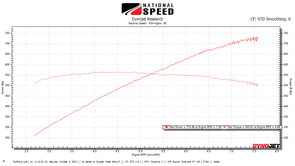

Finally installed the whipple kit and had it tuned this past Saturday! The car made 733 wheel and 566 torque at 12psi. National Speed in Wilmington, NC did the calibration. Oddly enough, the speed shop would not email me the data log of a WOT. The tech claimed it was technically "intellectual property" (bummed me out); I'll have to buy a NGauge to do my own I guess.
I am very happy considering the following setup:
Whipple Gen 2.5 (gen 2 body, gen 3 rotors)
Stage 2 kit
93 octane (no boostane)
3.625 Pulley
1 7/8 stainless works headers (w/ cats)
Relatively stock exhaust

Wow,..............all on 93 octane!
Is that safe? I would think you would need higher octane for that much power? Maybe not,............lol???

Yea I’d be careful running that much power on 93

Dyno Jet is the highest reading of them all isn’t it? Forgive my ignorance, they aren’t common here in Australia.

Typically Dynojets read higher than most loaded dynos. But they are also the Industry Standard, so whenever a company talks about rwhp numbers from a kit its always Dynojet research numbers.
OP do you know if those numbers were SAE Corrected or STD? That makes a difference too. Although this does bode well for my Gen 2 E85 set up im putting together.

It says STD on the graph

Oh thats weird i didnt see the graph posted last time i checked. Must not have loaded for me or something. Looking at it now STD smoothing 0 will DEFINITELY show you the HIGHEST possible HP numbers.
