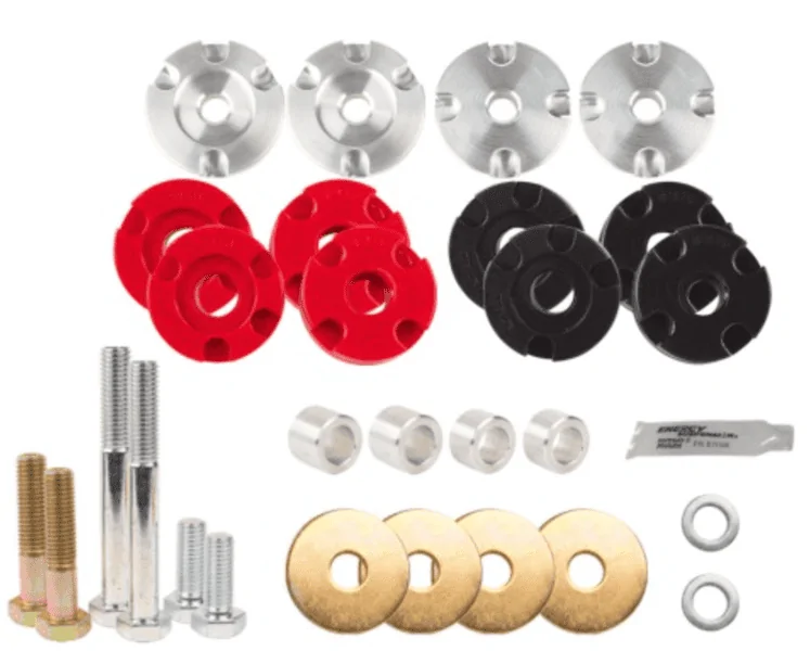

Can somone post pics on this? Im still not familiar on the names of each individual part so pictures help alot

These are the differential bushings. 2 different poly and a full aluminum set for different applications.
