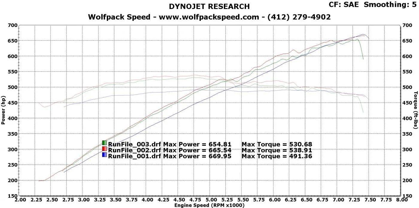

The first two are 5th gear and the last number was 4th gear on the first run 3.625 pulley :headbang: whipple cal as well

Mmmmmmmmmmm Whippple.....

Nice numbers. Are you running a boost a pump or any other fuel upgrades other than injectors?

Nope just straight 93 I wanted to add torch but he was sold out

How were you able to make a 5th gear pull at 7500 rpm you should have been way over the speed limiter and approaching 190 mph?

I don't know I put it in a calculater and it was right around 185 mph with 3.33 gear

That last pull the HP looks drawn with a ruler!
I want one so bad lol.

How were you able to bypass the speed limiter? I'm not aware that the Whipple cal has this feature. If so would you share a screen shot of the setting?

Yeah I don't think mine can bypass that either.

Idk did nothing special the guy pulled my advance trac fuse and that's it lol what's the speed limit set to anyway?

163 or somewhere close to that, it's built in the stock calibration and not easy to bypass. Pulling a fuse won't do it.
