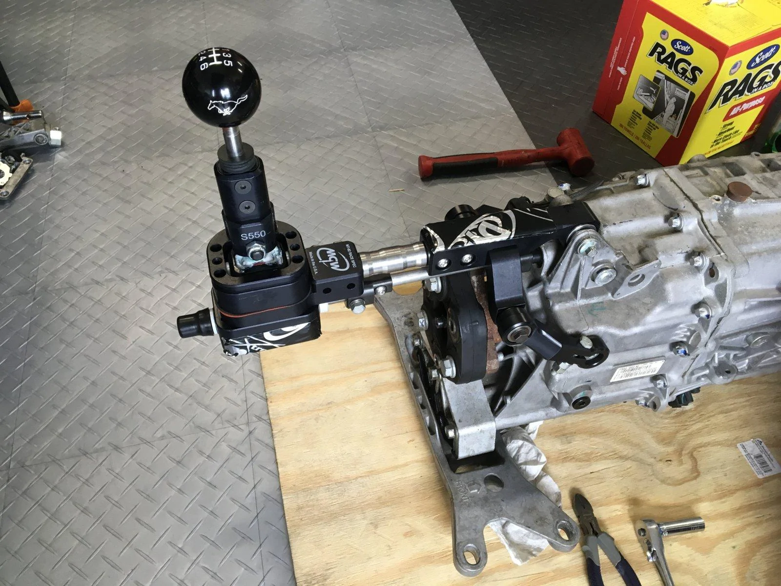

How difficult was the install? Roughly how long did it take?
If I recall correctly about 3-4 hours from the time walking into the garage and finishing test drive once done. Mind you I can be very particular and like to take my time and make sure everything is right. Use some lube and put the boot on the shifter outside of the car. Other than that, there is one linkage bolt that has to come out and it's located towards the top of the transmission tunnel. Kind of a pain to reach and you are going to want to pull down on the transmission to give yourself that little extra bit of clearance. Those were the most difficult parts. MGW has some good tutorial videos to watch before tackling the install.

Def go trans mounted as said above. The nvh is a non issue. Theres actually no noise associated with at least the mgw cause its a super nicely made piece. But there is some vibration but makes you feel connected in my opinion. The vibration is noticeable at first but you get used to it. This was one of my first mods for the mustang and i got it done by myself on jack stands just following videos in like 2-3 hours. And at the time i was much less mechanically inclined

MGW, I really can't say enough good things about it.
I've been running the X spec/flat stick for the past 6000 miles and it's been great.
There is no side to side play, the side-side gates are wide enough that you won't catch the wrong gear but narrow enough to make quick upshifts or downshifts a breeze.
I'll occasionally experience some vibration through the shift knob but it doesn't transmit any noise into the cabin.
