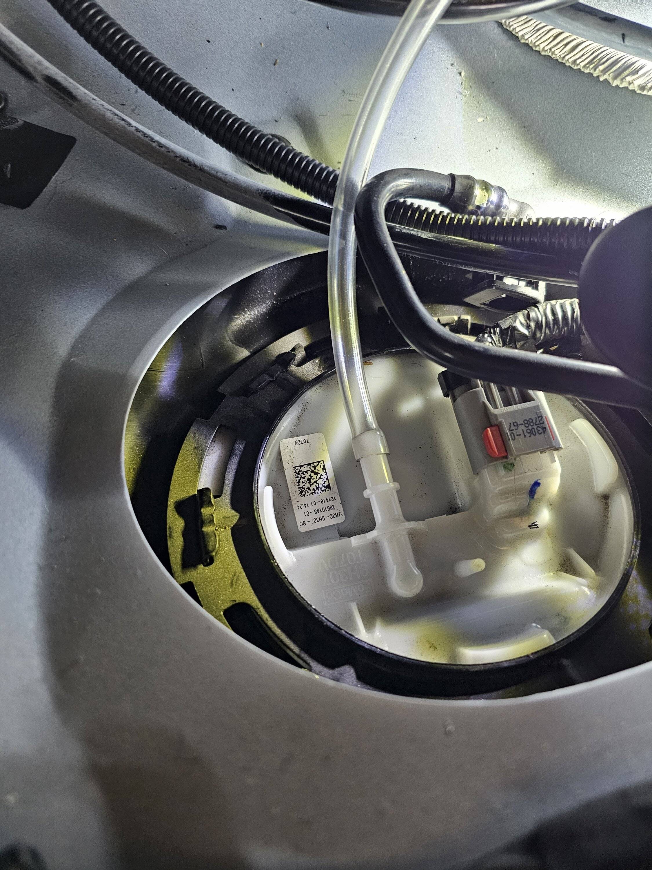

Hooked up an airline hose as pictured and no fuel came out at all during the start attempt. Fuse looks good. So this seem certainly to be a bad fuel pump. Am I correct?
SheepDog
Nov 3, 2018
4,243
5,338
Colorado
Dax
Probably, Unless power isn't making it to the pump from the FPDM. the only way to be sure is back probe the power wire and ensure that the ground is good. Pull the pump assembly out of the tank. While still plugged in, tap on the pump itself while someone else cranks the engine. If the pump starts spinning again, you found your issue but even if it doesn't may still indicate a bad fuel pump. Do you own a power probe?
