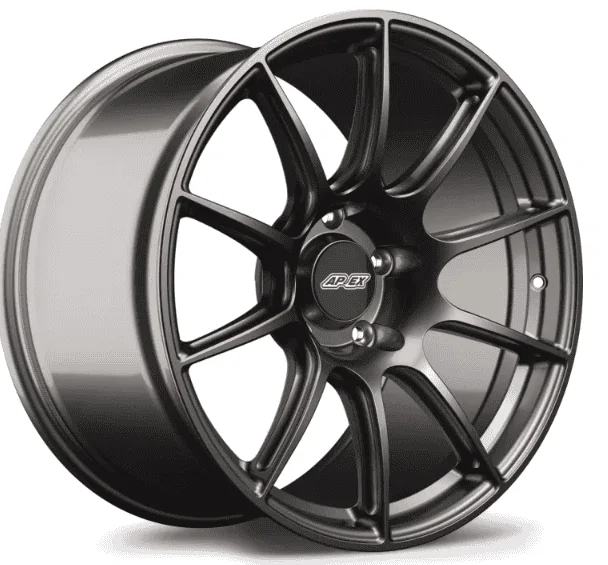

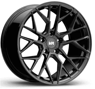

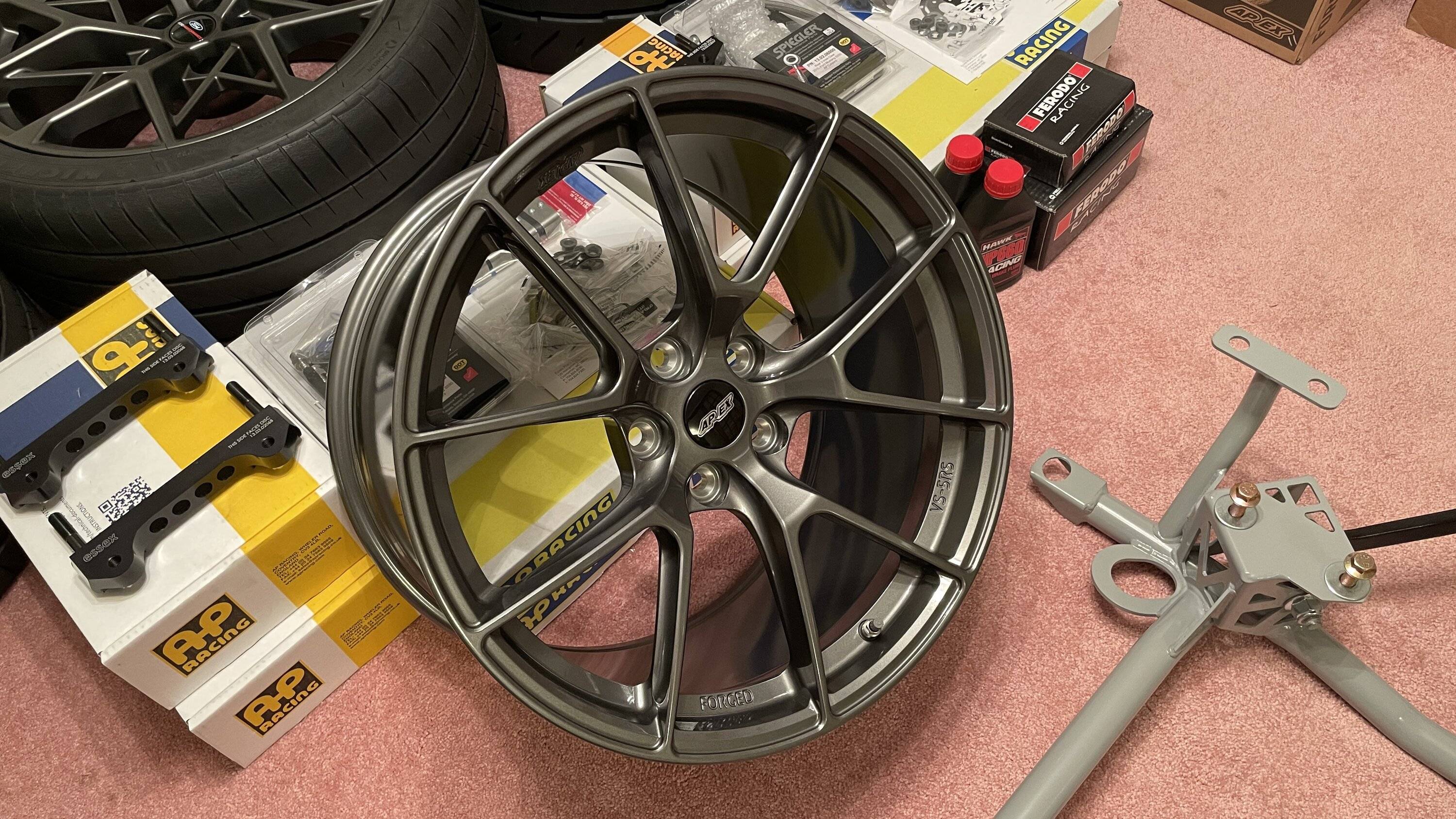

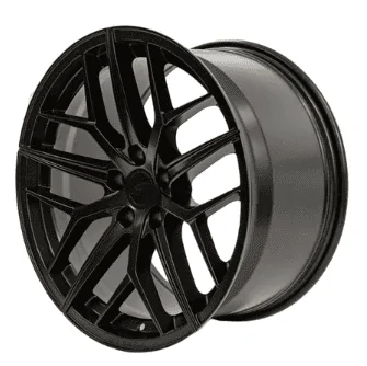

I'm looking to get a set of wheels for square setup and Time Trials. So far I've narrowed it down to Apex SM10, Variant Radon, and the Steeda Trident wheels. Trying not to break the bank initially. The prices are similar with the Steeda wheels being the cheapest. I'm curious if others have had experience with Variant and tracking the car. The last thing I want to do is pick something too weak for track duty.
Apex
Variant
Steeda

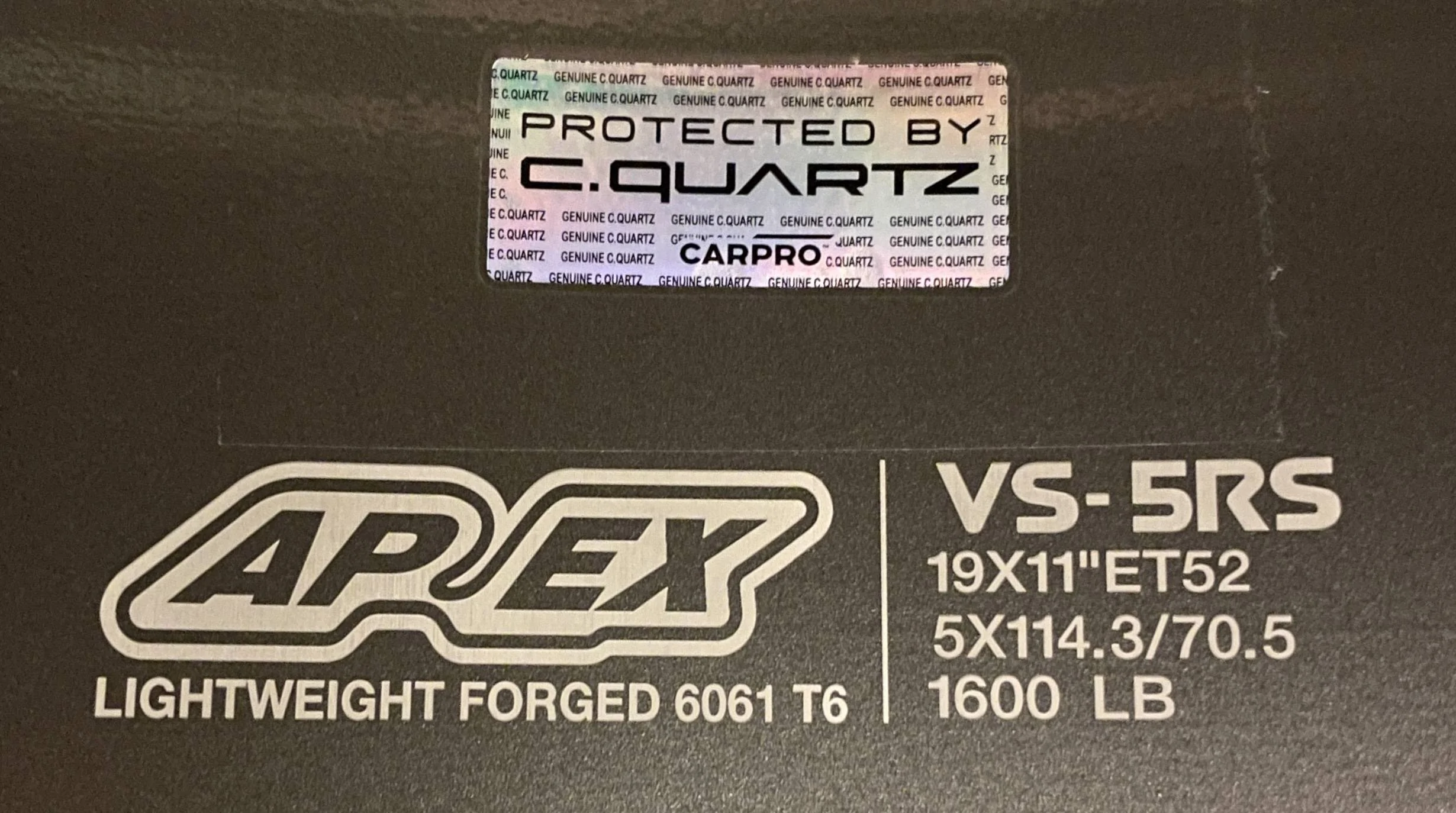

If you're worried about how a certain wheel will hold up on track, try to find the load rating of that wheel. If its in the neighborhood of 1500 lbs you'll be fine. Apex is the wheel you buy for peace of mind. Stupid strong and look good too!
