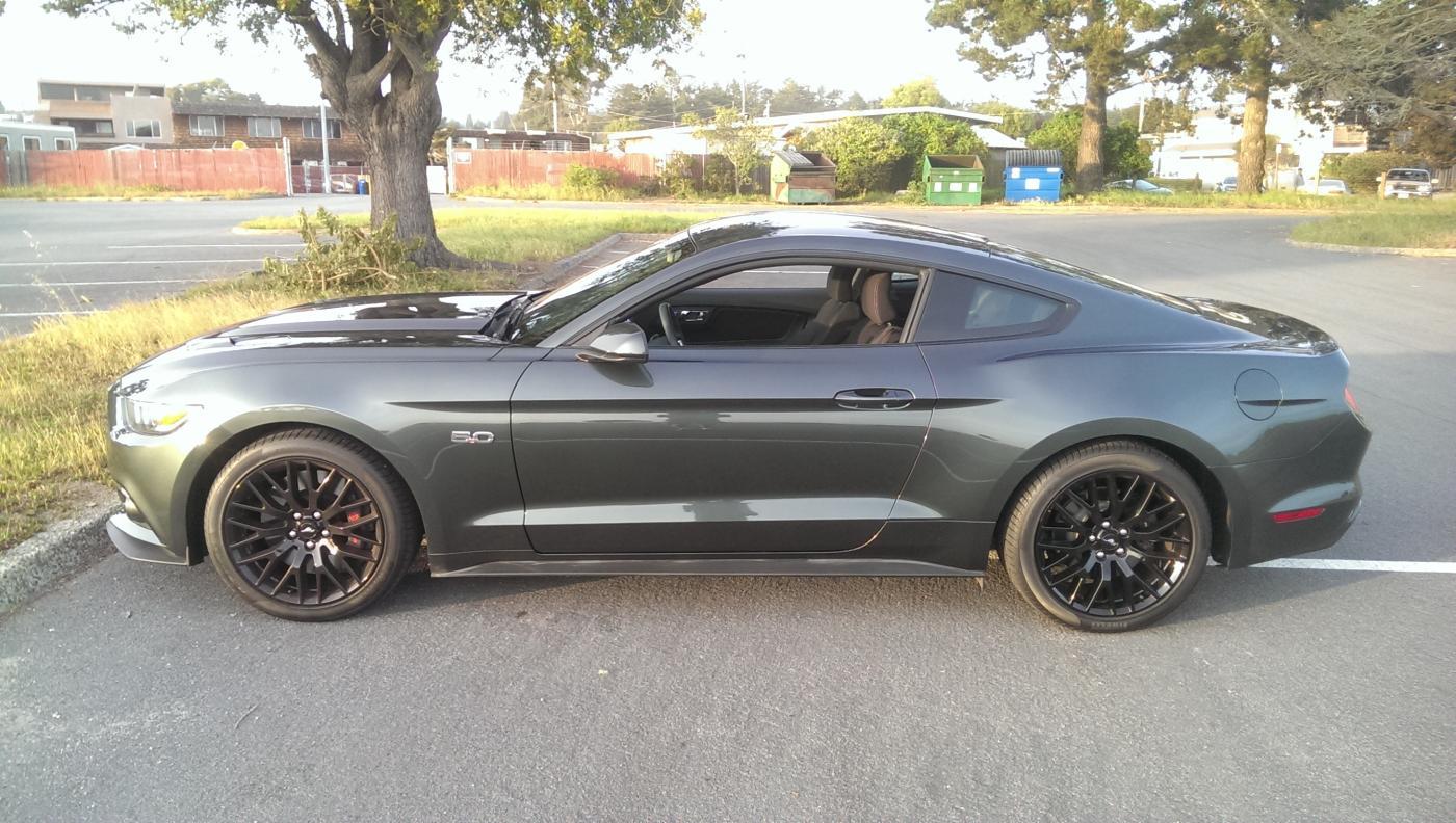

In case there are no pictures on the forum showing GT Performance Package with 19x9 255/40's on front and rear, here's the result.
I can barely tell a difference from when I had the 19x9.5 275/40's on the rear.
However after seeing Rubedog's GT in person I must admit that his lowering job with Steeda Springs really looked good. Thinking about this for the future.
