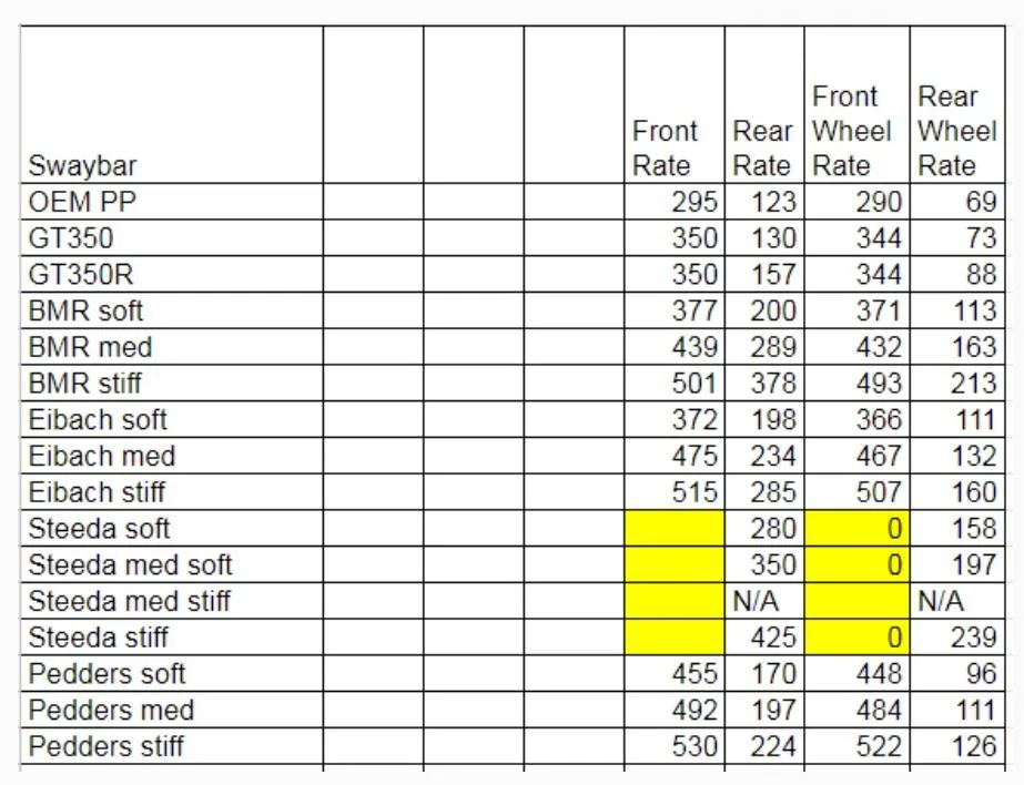

Norm Peterson
corner barstool sitter
Jul 22, 2013
8,852
4,652
Norm
'08 GT #85, '19 WRX
kz
Oct 26, 2014
4,630
2,945
West Chester, OH
Mustangs & F150
Norm - I am not sure this table is accurate - I think Ford Performance's Magnaride Handling Kit has GT350R bars in it - and front one is couple of mm thicker than BMR one (I have measurements for both somewhere). Don't see how BMR soft rate would be lower than GT350R - unless the bar in the kit isn't GT350R one.
Edit - nevermind - I think the bar in the kit is thicker than stock GT350 one.

I don't see any rate information for the M-5490-G bars, but I did find this information regarding bushings for it
You may or may not have seen this table of bar rates. Sorry for the outsize .jpg
Norm
Thanks, Norm. I hadn't seen that material, it's very helpful.
