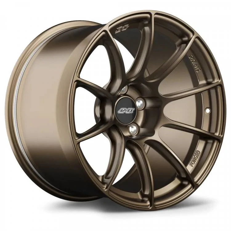

Another vote for Apex - I added a set of the flow-formed SM-10 in 19x11 square last season and I'm waiting for a set of the new forged version for this season.
Existing ones are anthracite.....
The new ones on order are satin bronze and are another 4 lbs lighter than the current ones above....
I ordered my VS-5RS during their black Friday sale, in brushed aluminum. I wish I would have waited until their group buy to buy these exact rims. They look awesome.
Not saying mine don't look awesome, but the SM-10RS are another level!

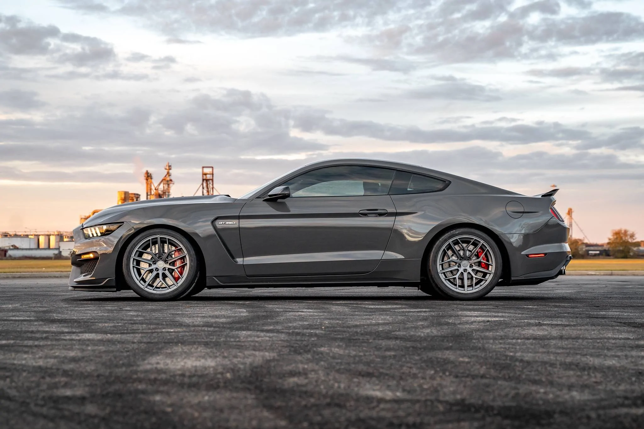

Hey All - For track setup, I ran the Steeda Trident in 19x11 +53 square on a 315/30 RT660 with a 1" spacer up front.
The 19x10 +37 Trident will also work square, but I wanted maximum contact patch for track use.
Note: This is with -3.5 deg front camber.
