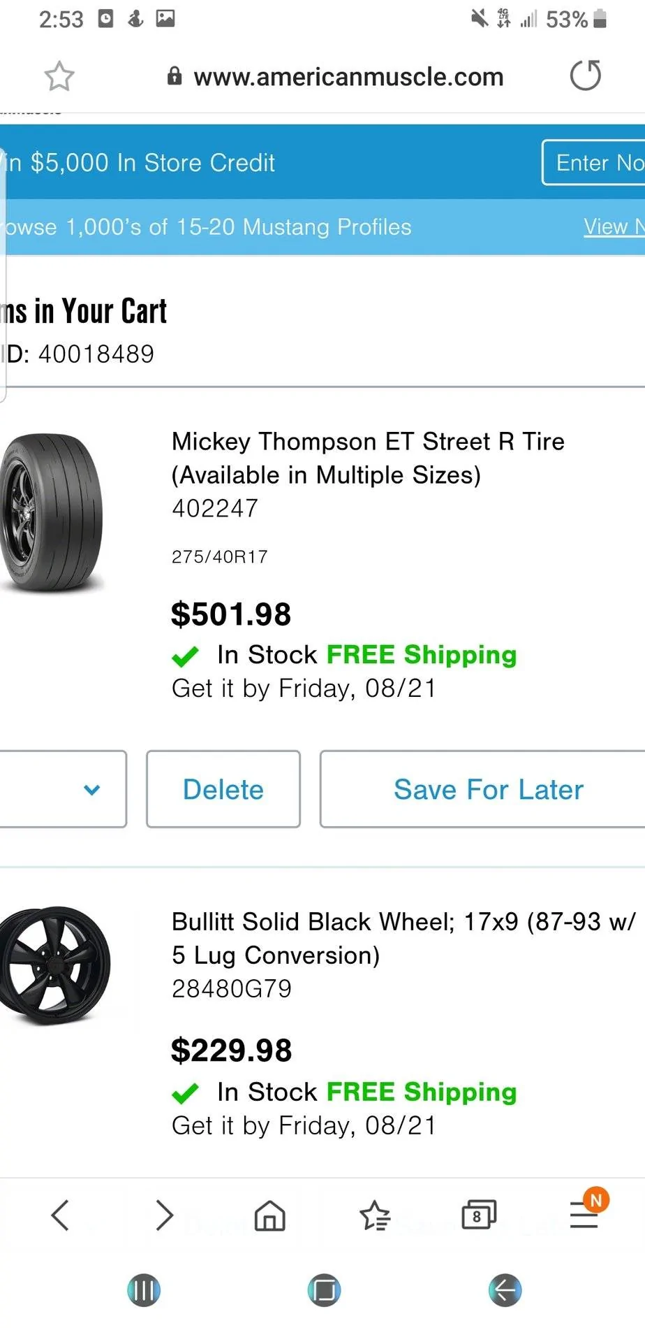

I'm pretty new to the whole wheel and tire setup for drag racing. I'm looking to buy MT et streets Rs 275-40-17 for my rear. I found a wheel that is 17x9. It's the bullit wheel from American muscle that I've seen a few on here use. Before I ask my questions I'll say I'm looking for more of a budget build. My mustang gt is a non PP base car with 3.55s gears.
1. Will the Mt 275-40-17 on the 17x9 fit in the rear? I dont have brembos.
2. American muscle says the wheel will not fit my car yet I've seen a few people say it does on here. If it does fit is there any additional things I need to do? Get different lug nuts, shave my calipers, ext?
3. I have no idea what to do for my fronts so any help is appreciated. I do have the stock factory18s up front. Would the stock wheel and tire be ok up front? Or should I get different tires and wheels for the front. The tires on the front now are the factory 235 p zero all seasons.

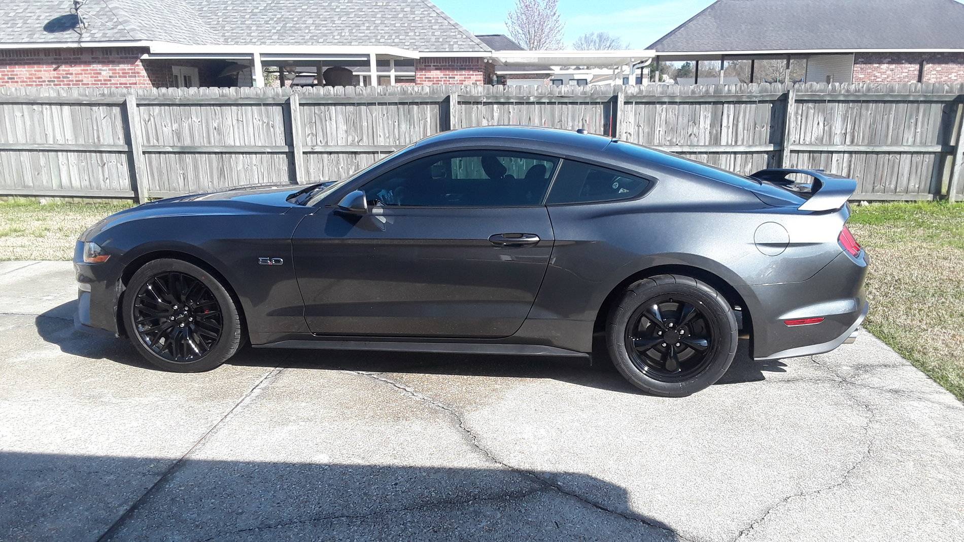

I have the 17x9's with the S197 offset & they work great. $100 a piece & weigh the same as rear Race Stars. Stock lug nuts & studs work great, no rubbing & work great on my 19 PP1 & my buddy's base model 19

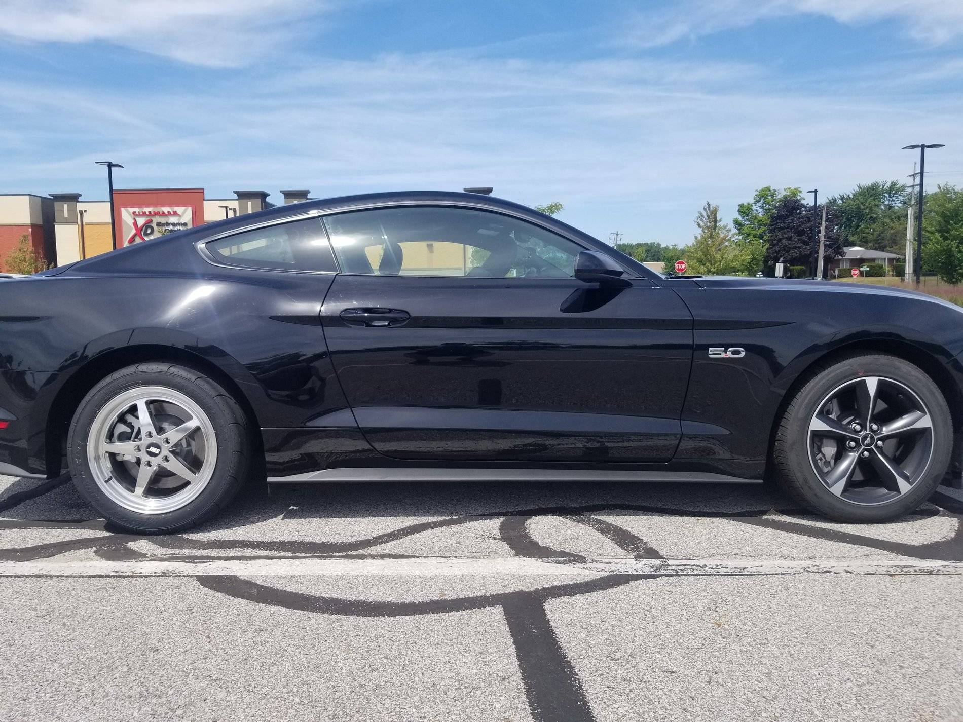

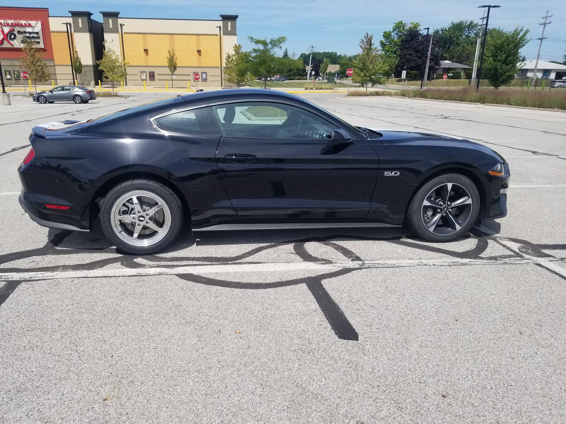

Post up a pic. Must have 6in of wheel gap. That tire is like 25.9in?
