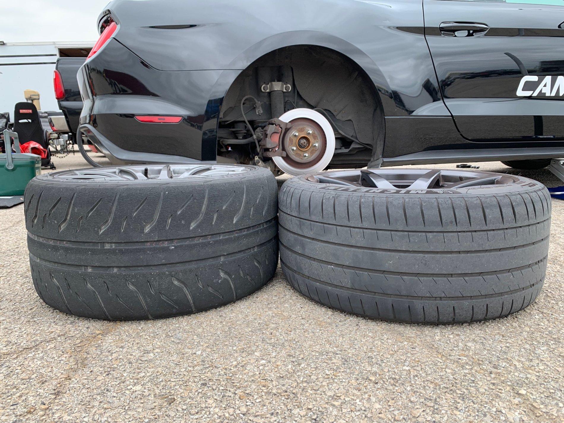

I assume you will be competing in CAM? You'll want a 'healthy' amount of camber to preserve your tire wear at the event. In my experience, one autox run is worth about 150 street miles as far as wear goes, fwiw. 2.5 degrees would be close, but not quite enough for autox and its a little more than you'd want on the street, so consider that a compromise, and with the right offsets, extended ARP studs, and 25mm spacers they'll fit in the front fine with 11s and 305s. Just make sure your front toe is zero to minimize wear on the street. Toe will kill tires faster than camber.
A 10/11 staggered wheel setup would not be ideal if you want to autox the car. it will just understeer too much you won't get balanced handling and will be fighting to get it to rotate all the time. If you don't want to worry about being maximally competitive, and you want to save a few bucks, often (but not always) the 10" wide 285 tires are cheaper than 11" wide 305s, plus you don't need spacers and studs to get a rotatable square 10" wide setup. RE71Rs are currently $300 each in 285 and $370 for a 305/30R19.
Me, I'd go 19s (and did), but there are a couple of 18s that will fit over the PP brakes. The problem is the tire selection. The RE71Rs you'd put on 18x11" wheels are pretty short and would make the short gearing on a 15-17 GT even shorter. The Rival S 1.5 in 315/30R19 is a little better diameter, but i hope you don't drive through any rain on the way to the event.
If you're packing the family, a tire trailer might make sense. They're pretty cheap to get a 4x4 utility trailer ($200?) then you just need the hitch.
Here is a 305 RE71R next to a 285 MP4S.
