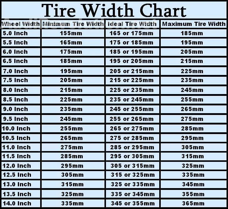

Stick with 275-285 on 10" wheels. I would suggest 285/35R19 on all four corners. You need an 11" to properly fit most 305s, and some fit well on a 10.5".
