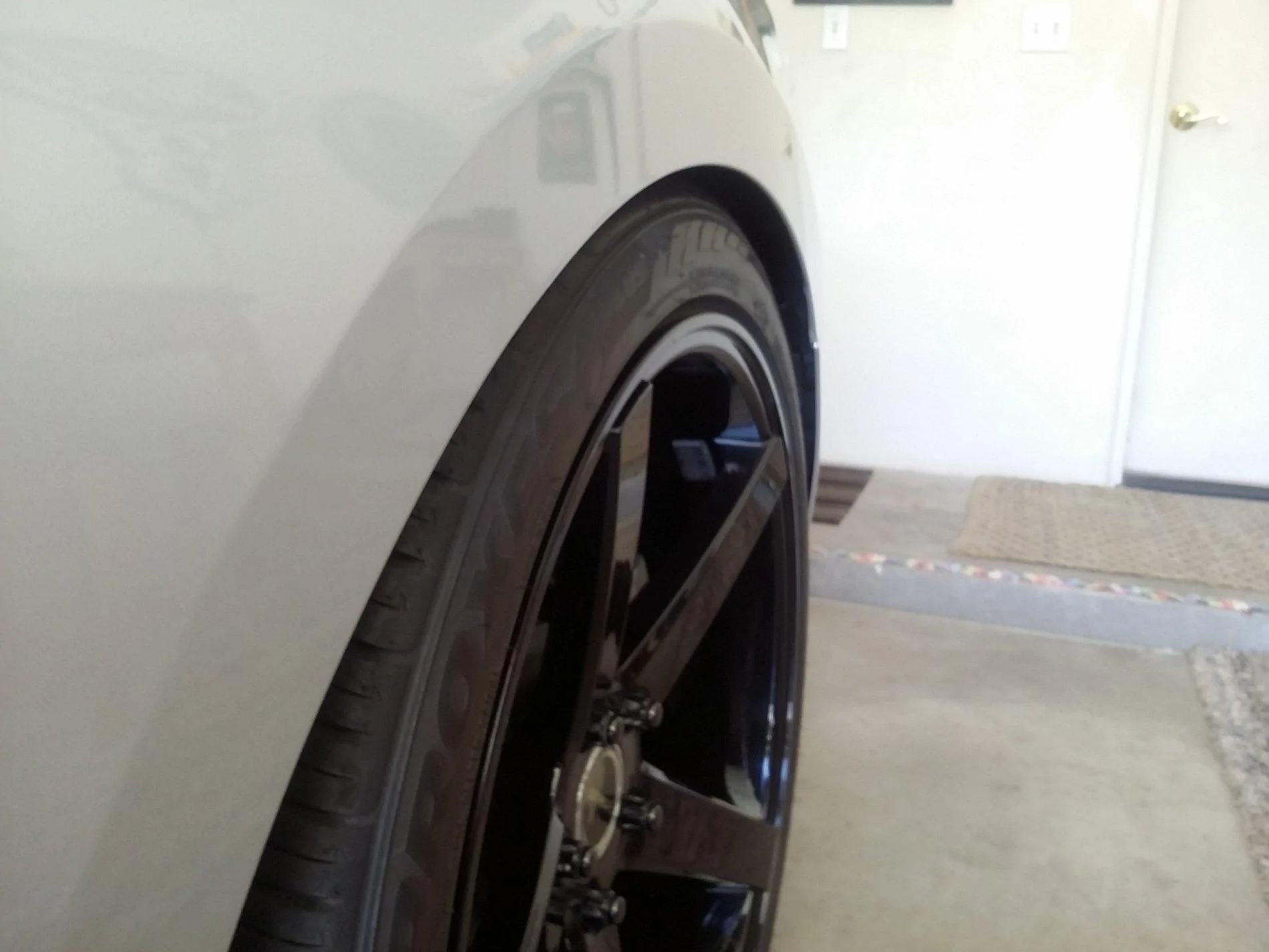

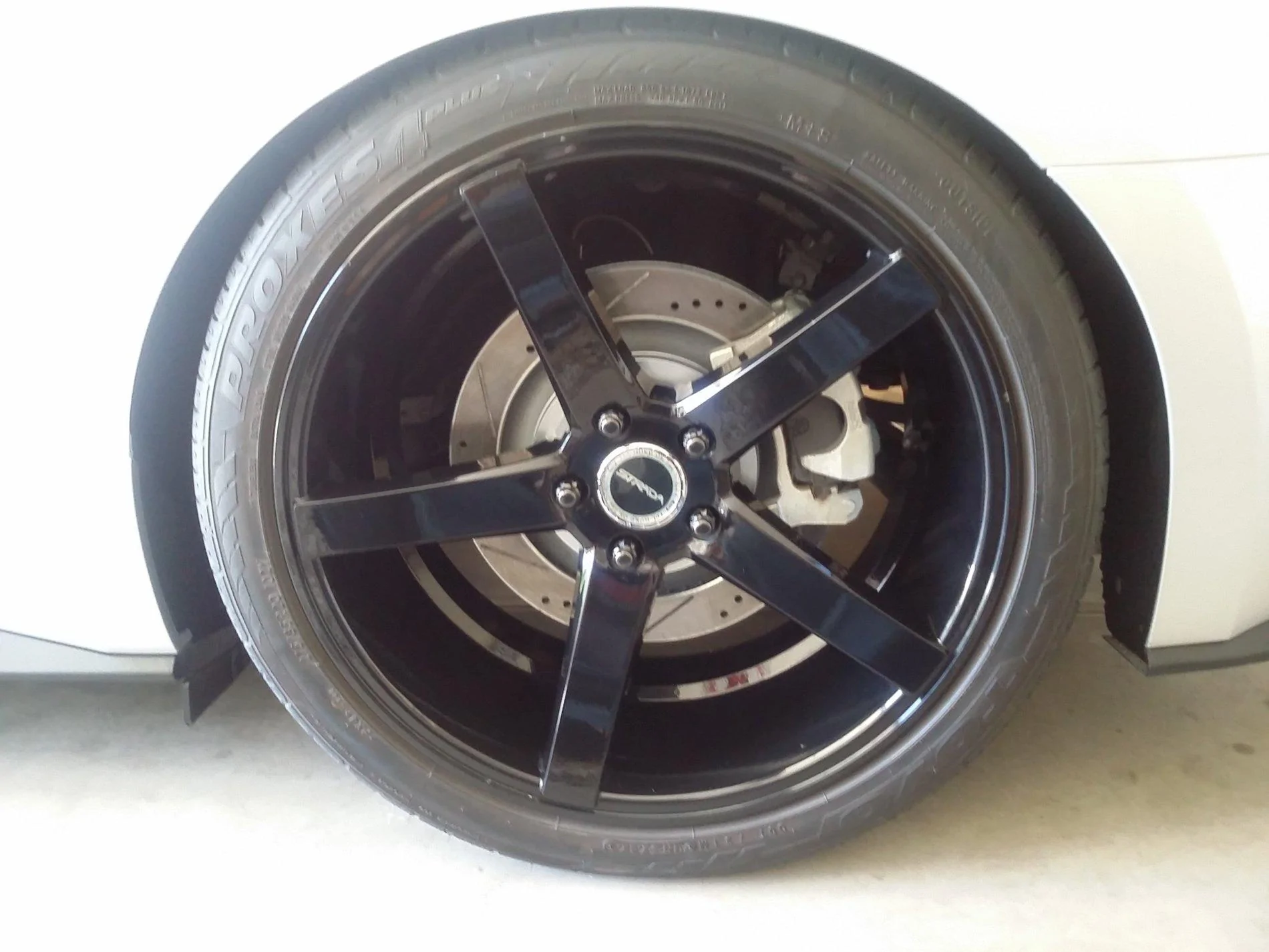

I just went with a 20x10.5 +45 offset with Nitto NT05 305/30. I'm running a 1.3 in drop no rub . Here's a pic

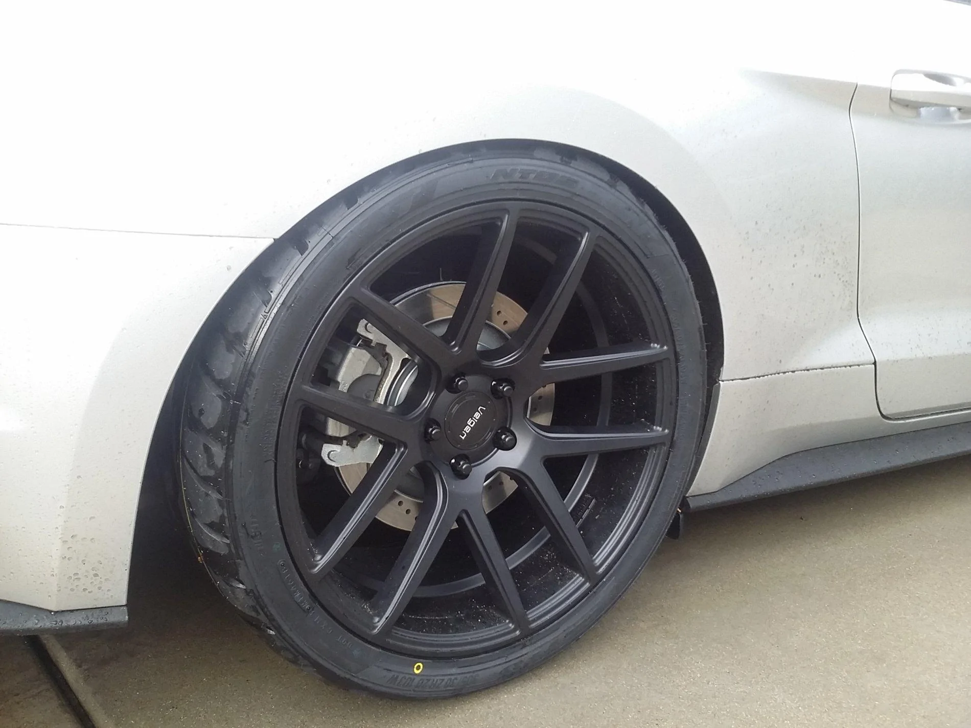

With a 35 you might stick out past the fender , here is what I went from 20x9.5 +40 275/35 Toyo

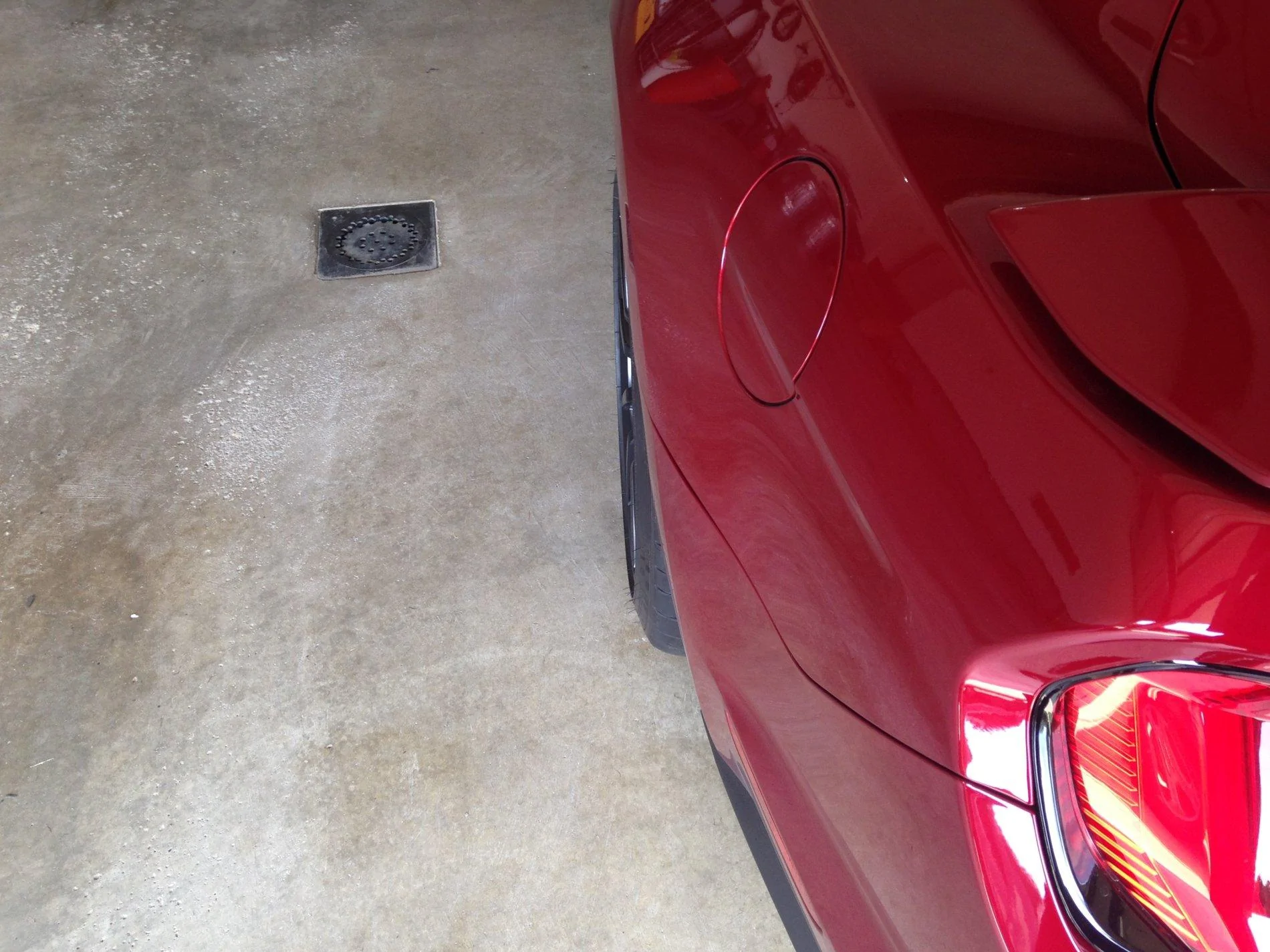

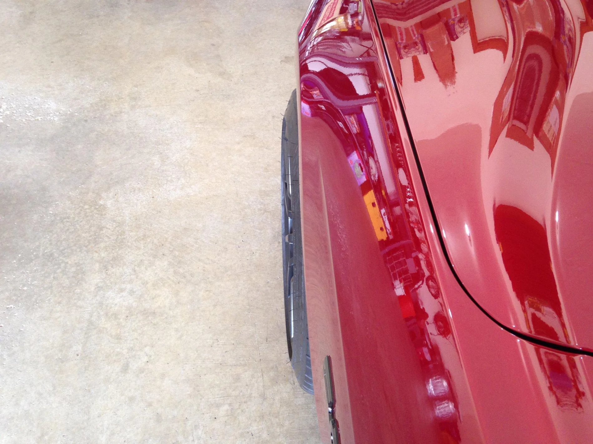

No poke at all on the rears. Here are better pics showing the front and rear tires relative to the fenders. Although the fronts do poke out a little, the sidewall slope matches up perfectly with the fender so the tread does not extend past the fender.
The GT350 wheels are front 19 x 10.5 ET30, rear 19 x 11 ET62. Single best mod I have made to the car. The handling and turn-in are dramatically better. No rubbing, stock PP1 springs. The TPMS sensors matched right up, I didn't have to do any programming. Stock lug nuts worked too. I had a custom alignment done by a local Ford dealer, the PP1 and GT350 alignment ranges overlap a little so it's possible to align the car so that it meets both sets of specs. It was harder to drive until I had the alignment done.
