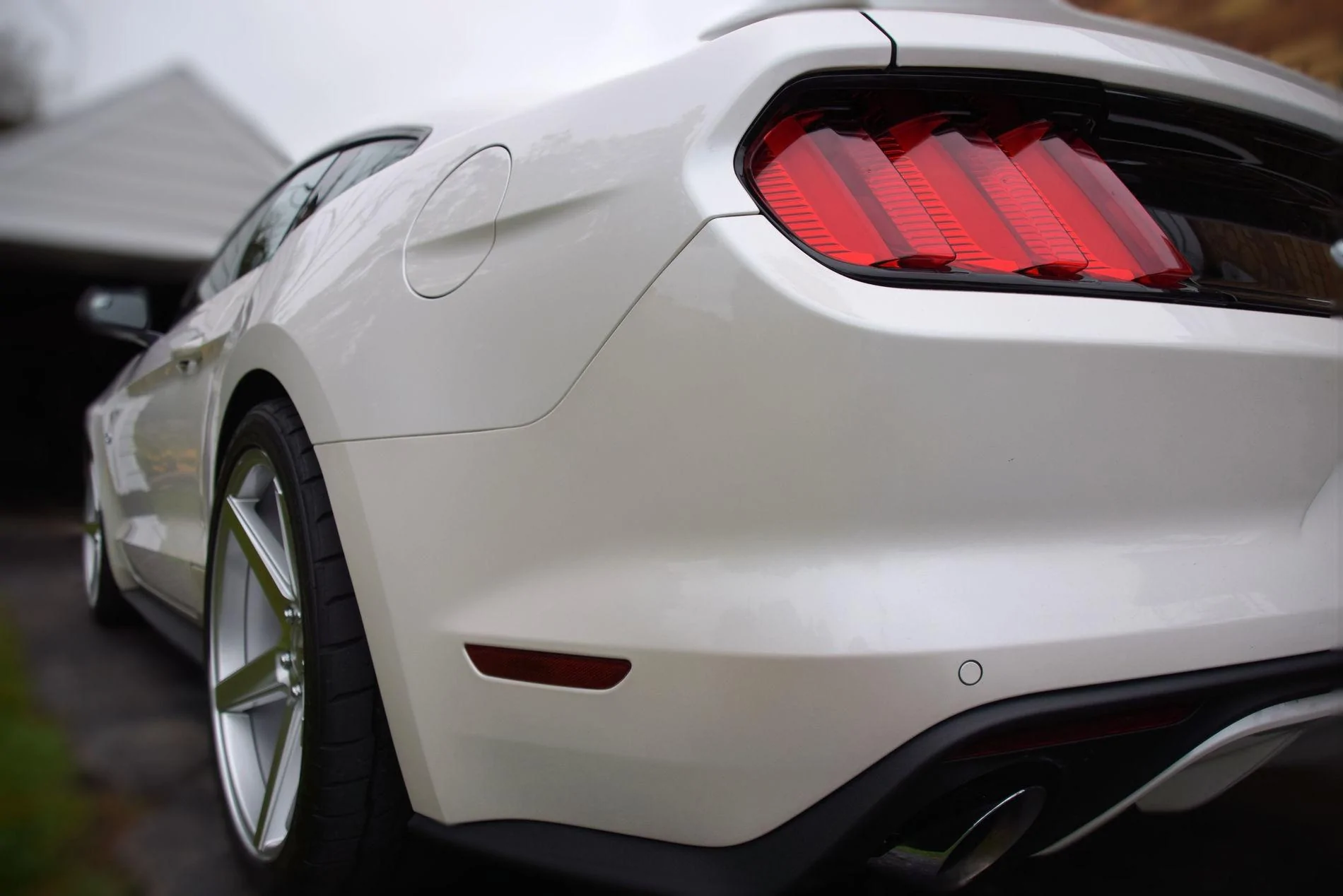

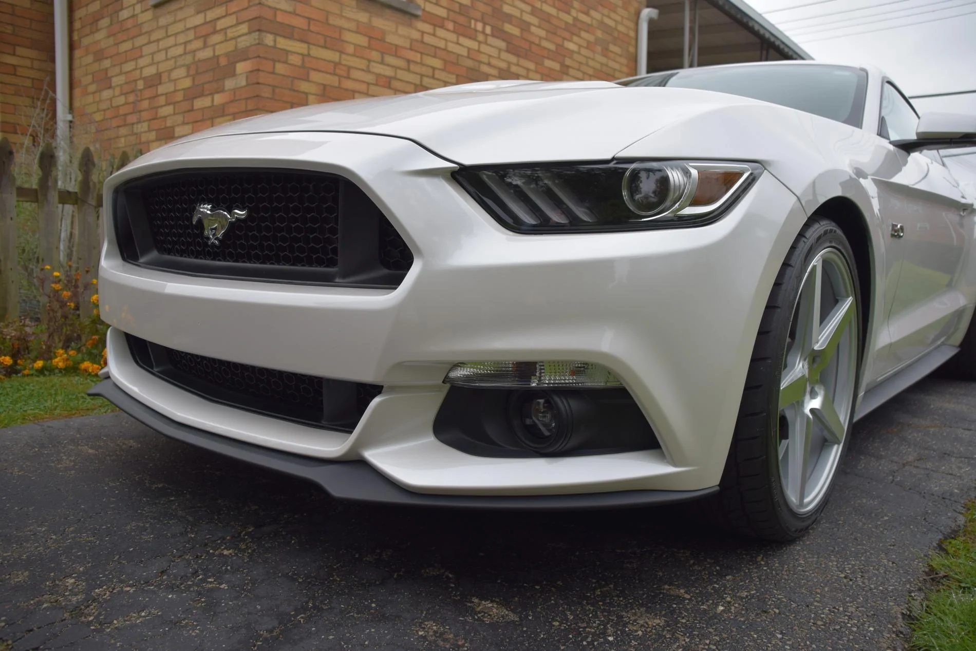

305/30/20 20x10.5 +45mm offset rear
255/35/20 20x8.5 +35mm offset front
Its just that simple...

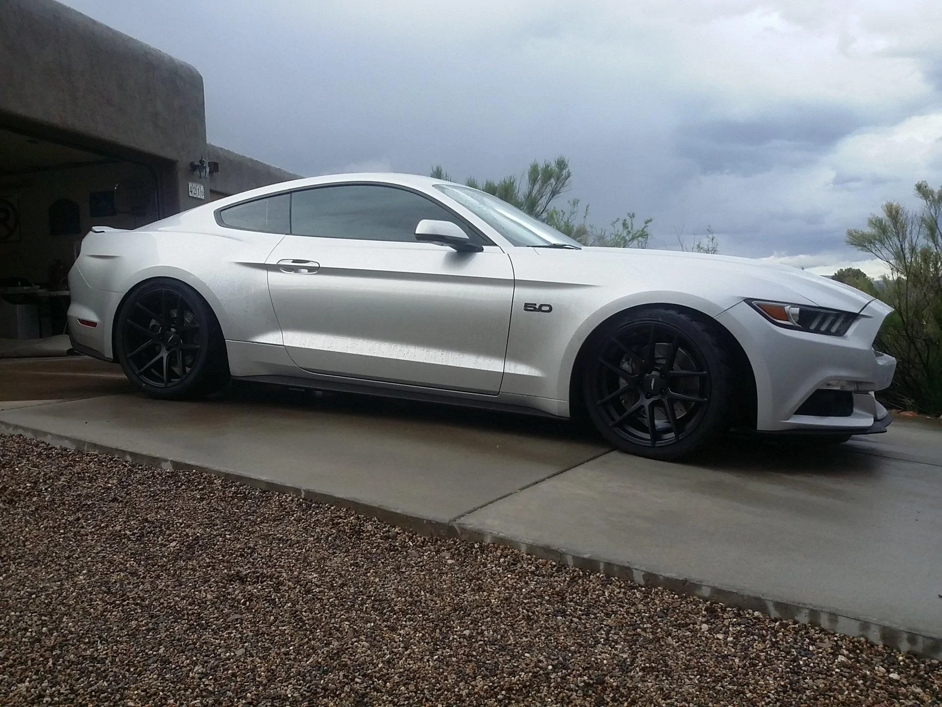

Same set up , but lowered 1.5 front 1.3 rear

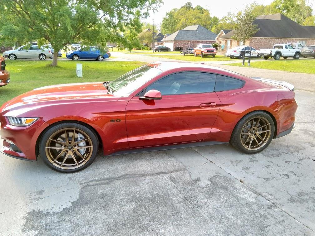

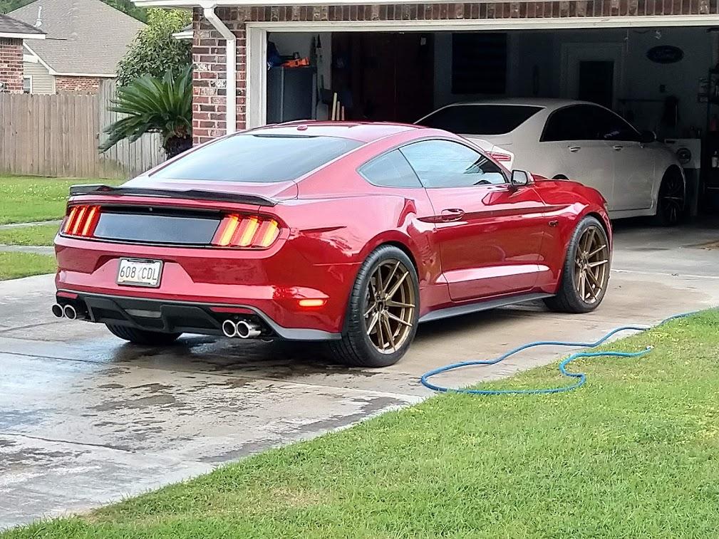

I really think 30 series tires are too small for these cars unless you are slammed on bags or coils. That's just my opinion though. lol
Again depending on offset, there is plenty of room for a 35 series tire with a moderate drop. I plan on dropping mine with the BMR minimum drop springs once I find some struts.
I will say this. I put my 20x10.5" +45 wheel on the front of my car just to see if it would fit. And it hit the front struts. Not by much but it rubbed it. So with that said a +40 probably would clear it.
So 20x10 with a ET37-38 will be fine. I don't see why a 295/35 would be a problem. I probably should have went with that on my front 20x10 because the 285/35 looks kinda short to me. lol
