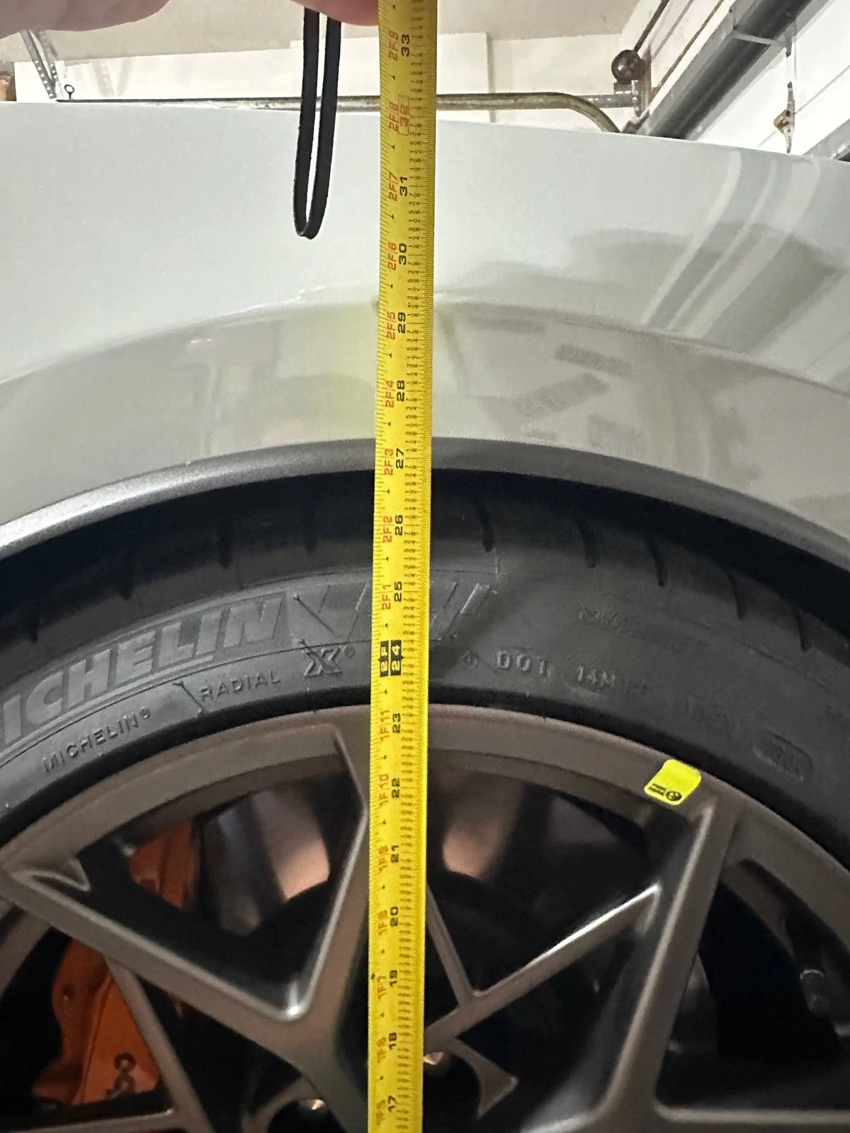

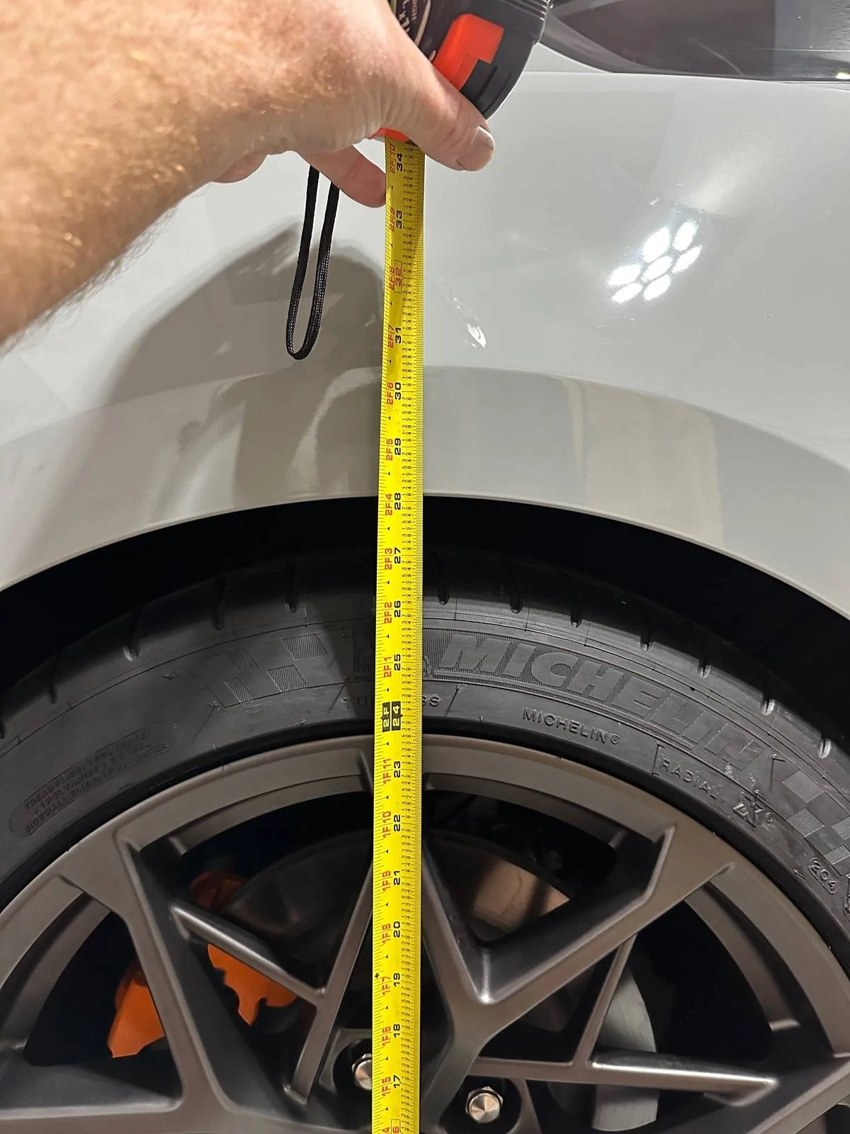

I'm taking my measurements from the ground to the fender arc (the plastic). The tire is close to the fender but you have to remember when the suspension compresses the tires cambers in so no rub happens.

Ah there you go. Measure to the fender lip not the plastic. It still shouldn't make up an inch though.
Also, do you have cup 2's or PS4s?
yeah from there it's 26 1/4" and i have Cup 2's on it at the moment.

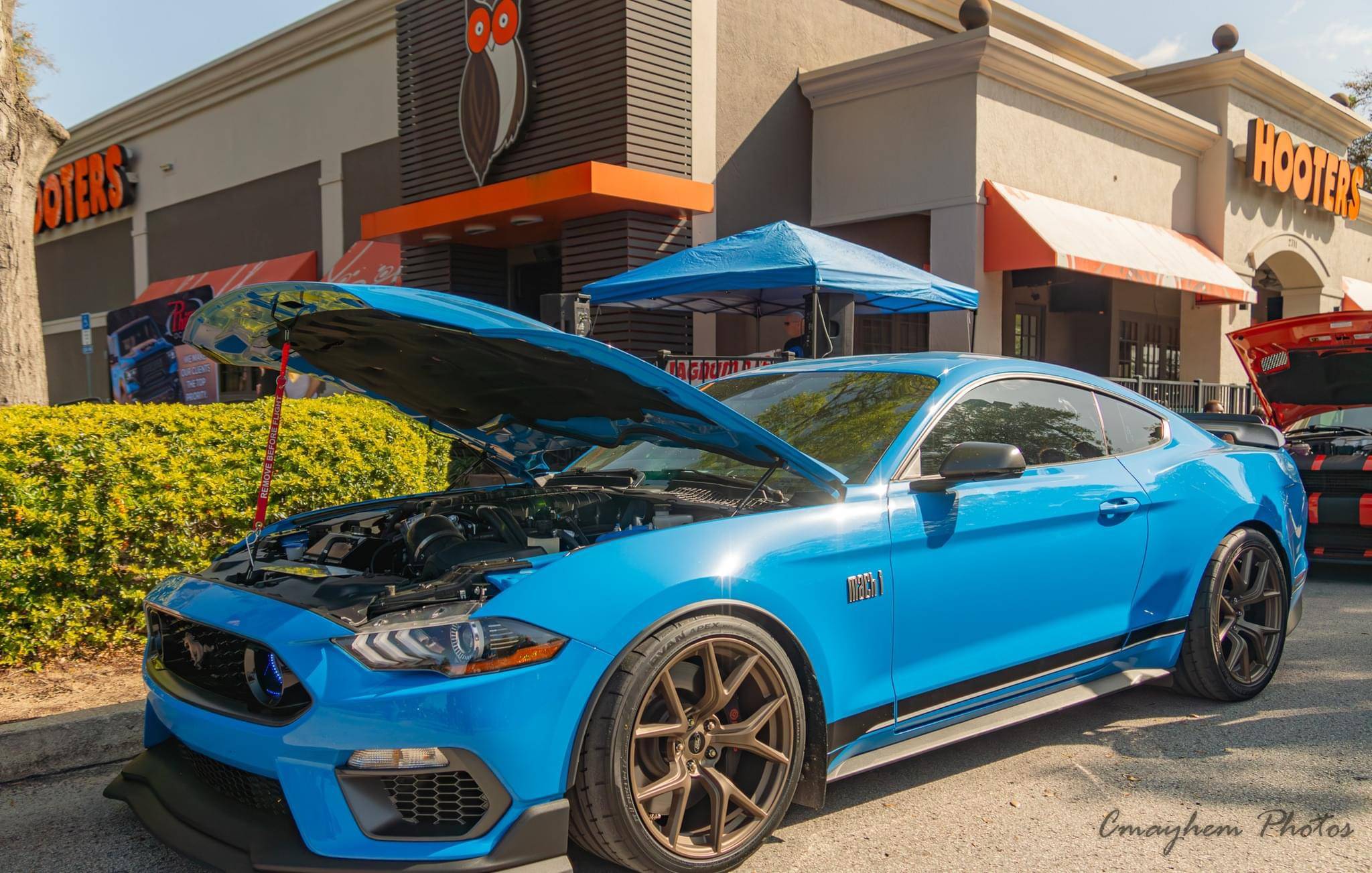

26.5 front
27.25 rear.
-2.5 front camber. 19x11 SVE PP2 wheels 305/30 front 325/30 rear.
2022 HP lowered on steeda dual rates.
measured to the fender lip ABOVE the plastic HP fender flare.

Thanks for sharing. Love the backdrop. 😉

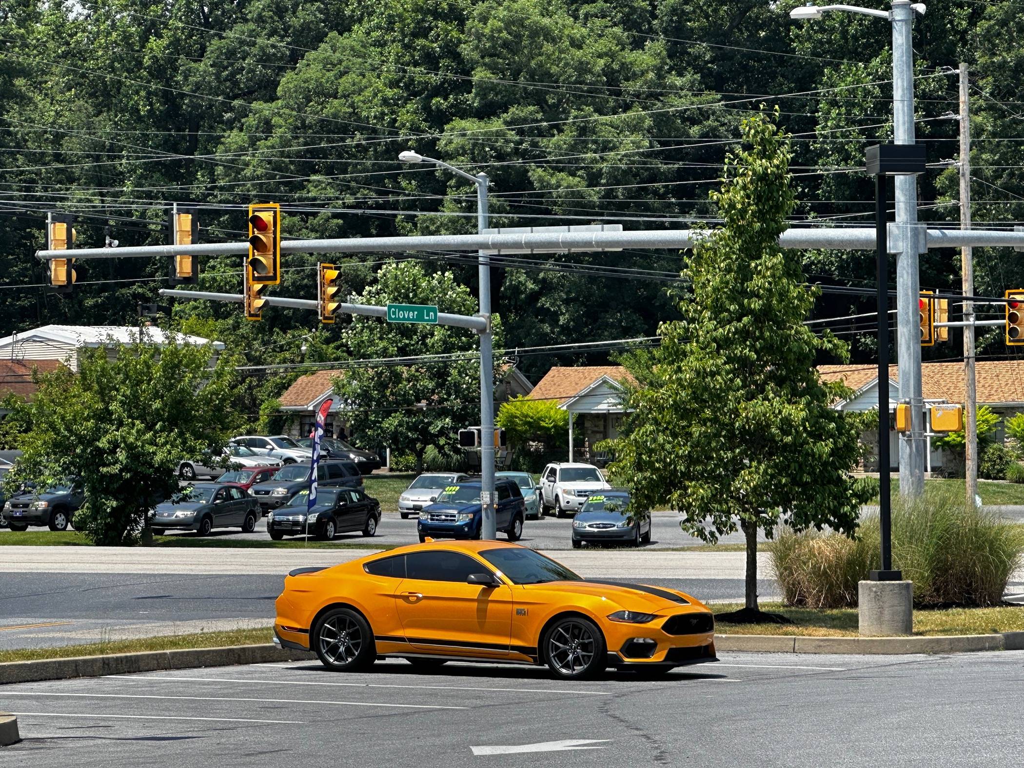

non-handling package Mach 1
handling package springs
FP camber plates front, set at 1.5 neg
Handling package rear stabilizer bar
Handling package original tires and rims
27.7front
28.10 rear
I’m good with it but some others disagree

Your car seems to be much higher than others with the HP setup. I wonder why that is.
I’ve been wondering the same myself, I’ve been told that it’s possible that the control arms might’ve been torqued and set while the vehicle was in the air rather than on the ground,

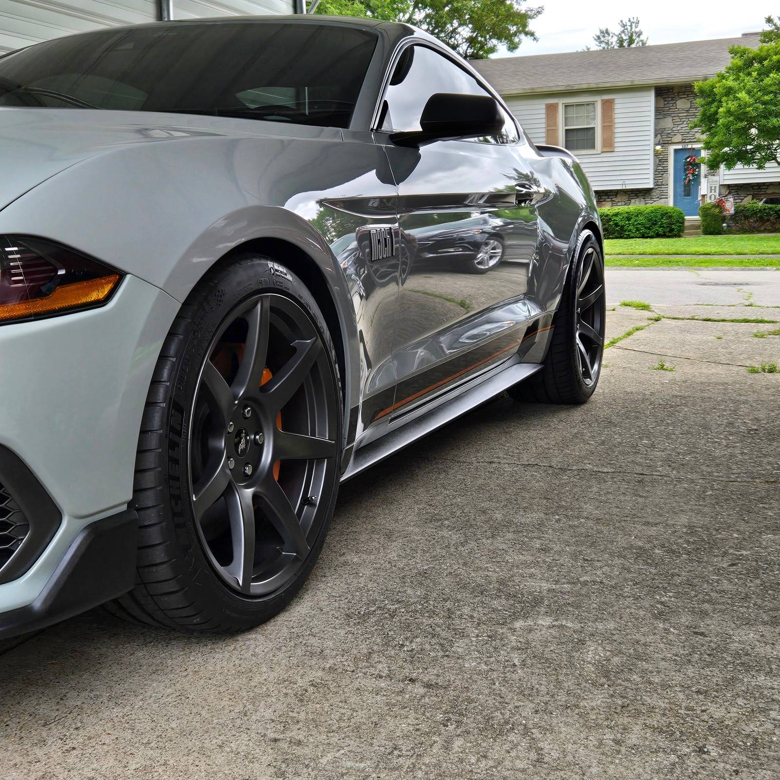

Stock Non-HP
Rear 28-7/8 305/35ZR20 PS4
Front 27-3/4 275/35ZR20 PS4
on Project 6GR 7.

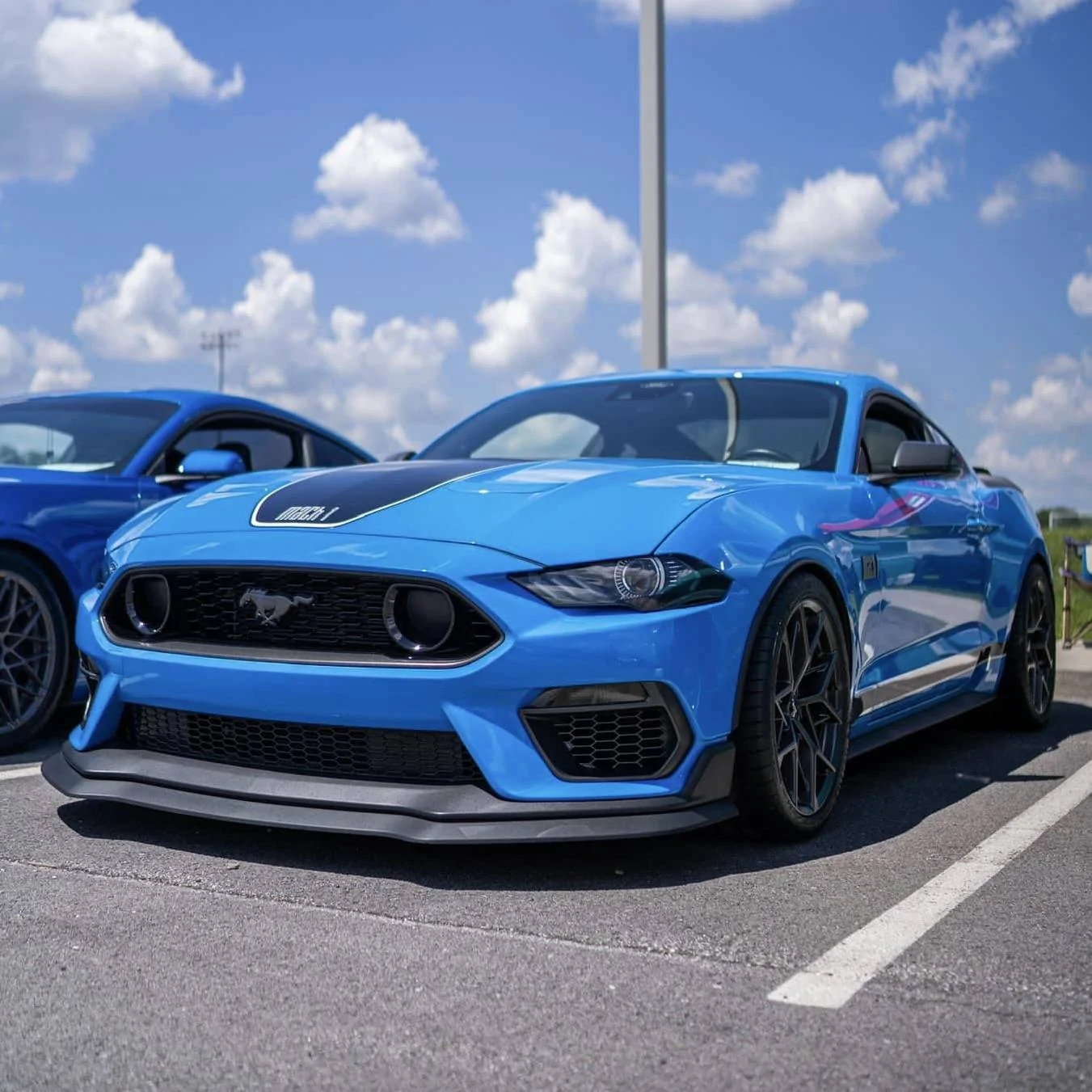

2022 Non-HP "Converted"
Steeda's dual rate springs w/camber plates
Handling Pack Wheels w/Michilen Pilot Sport 4S in 305 and 315/30/19 30psi
Front height 26.7in
Rear height 27.4in
Front camber -1.7°, rear camber -1.2°

The bronze looks incredible on the grabber blue! I'm thinking about getting a second set of wheels for autocross/track use. You may have just turned me onto those if I don't end up going Apex
