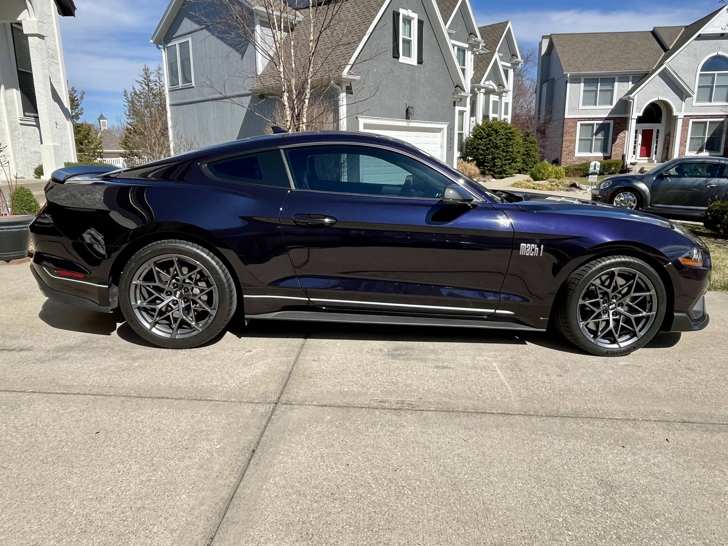

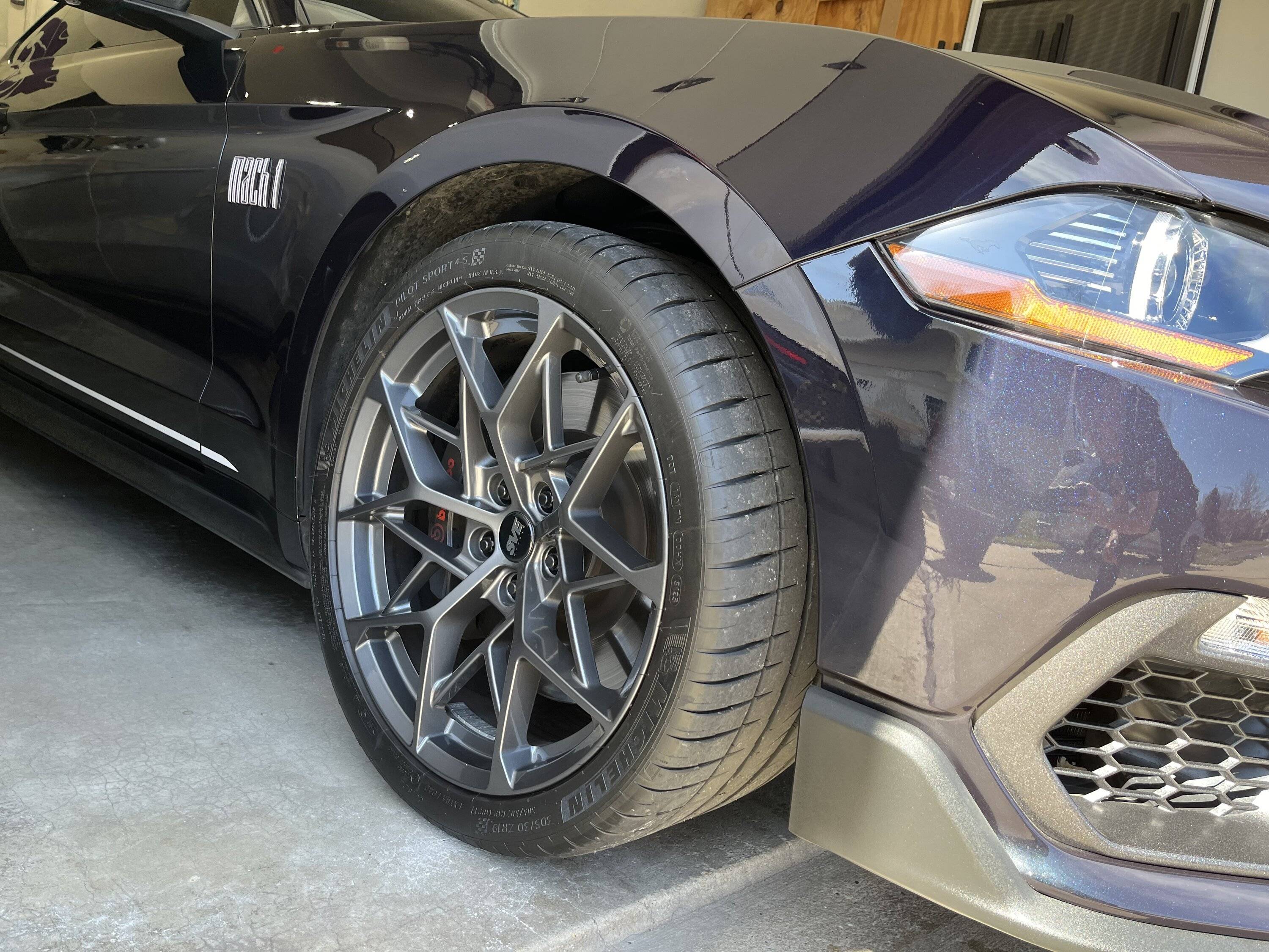

Non-HP with stock springs
Front with 305/30= 27 5/8”
Rear with 325/30= 28 3/8”
Driveway is not level

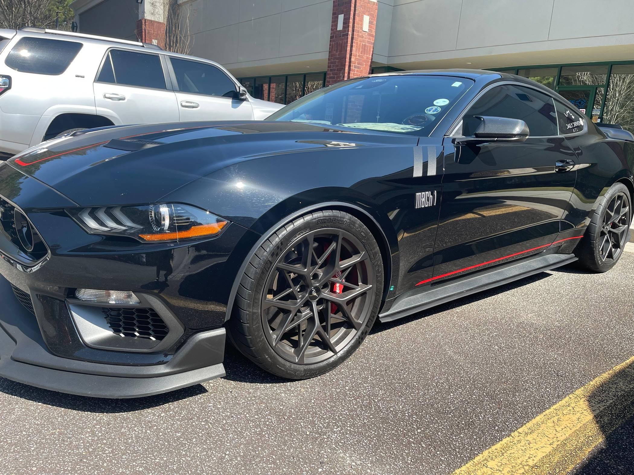

I'm at 26" in the front and 27 1/4" in the rear on steeda progressive sport springs on my HP Mach 1. They say a 1" drop but that is for everything but the Mach 1's. They barely dropped me 1/4" - barely.

Hmmm... If you are on Sport springs and HP wheels and tires, then we have the same set up. But yours is almost an inch lower than mine...you sure your measurements are right? Something must be off. 🤔
