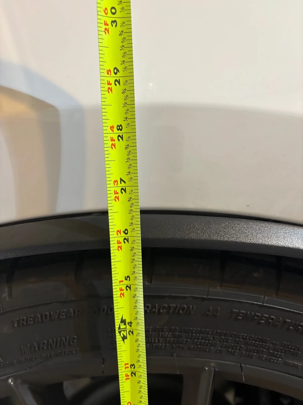

Currently have Steeda sports on mine
HP Michelin PS4 tires sizes.
Front 26.475”. Rear 27.375”
I have Steeda ultimate springs in the box in the garage I plan to install tomorrow.

Very interesting that those Sport springs didn't drop you more than that. They say it's supposed to be close to 1 inch. But that would be consistent with mine minus the HP wheel/tire combo. Got any pics?
You cant measure from ground to wheel arch if you want to get data on springs, wheel/tire is a free variable. Wheel arch to hub center is more suitable.
My ride height literally varies by 0.5” depending on which wheels I have on the car and thats not even that extreme. Ground to chassis or fender numbers are going to come back all over the place depending on what tires people run.
OEM PP2 mustang (for example) was 0.4” lower than a PP1 GT… just because of it’s tires.

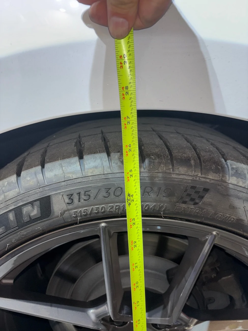

Reposting from earlier in the thread - this is the most accurate way of measuring we have executed:
I’ll measure this way as well before swap. Thanks.
I think of ground clearance when I reference ride height. Thanks for the knowledge 🤙
