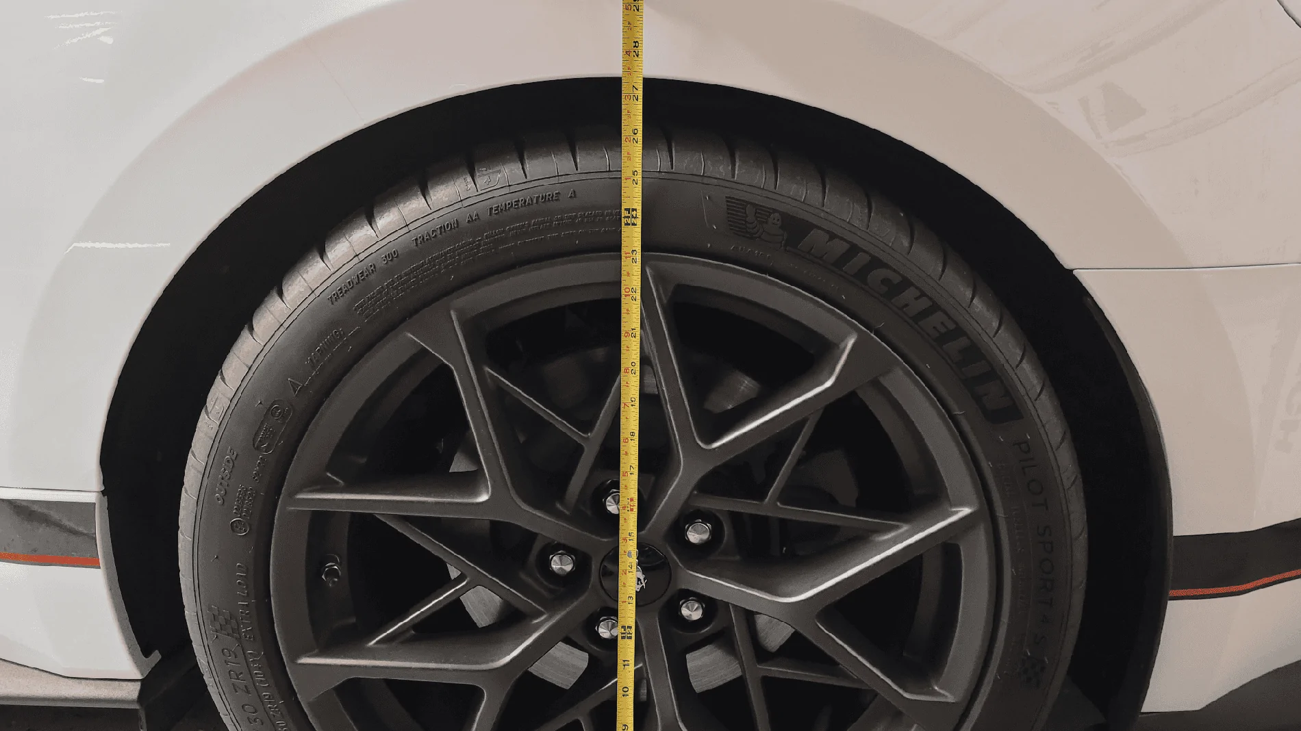

front = 28” with 275/35 20“ wheels/tires -1.0 camber
rear = 28.5” with 275/35 20” wheels/tires -1.3 camber
Roush front adjustable springs maxed out
Roush rear adjustable springs maxed out

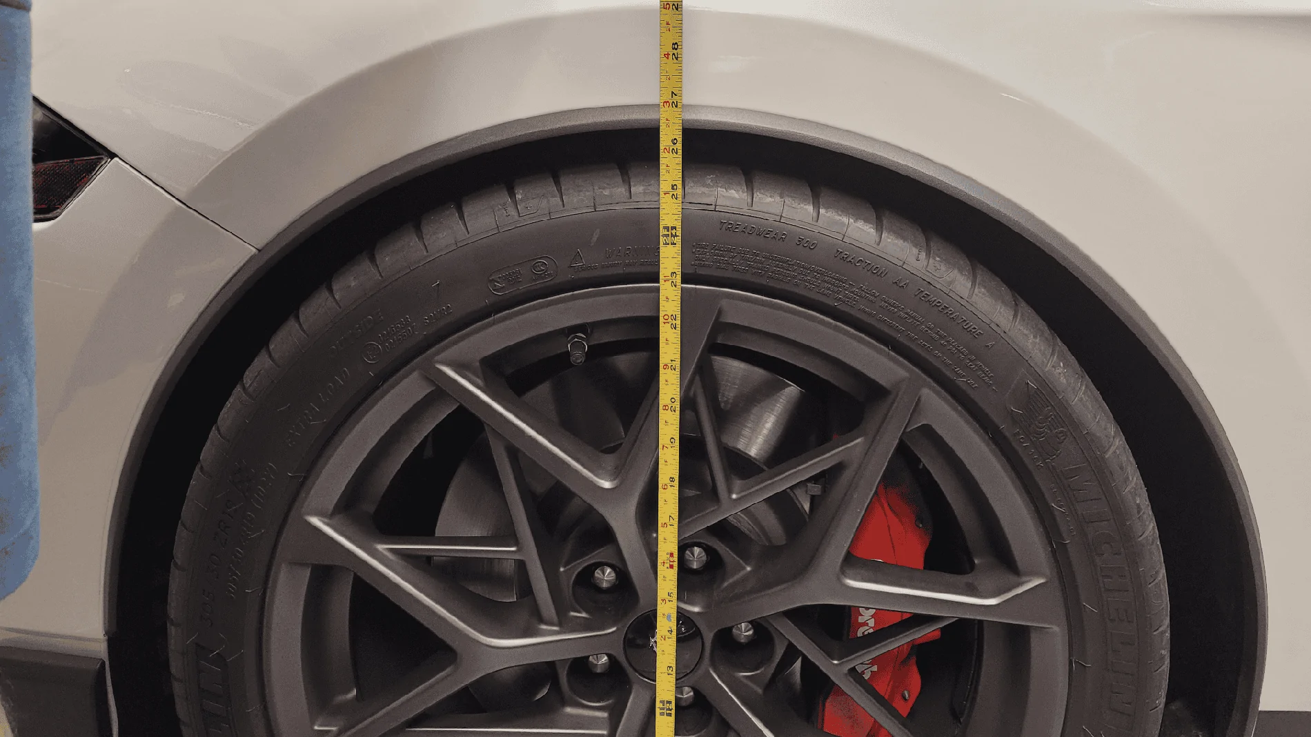

Front = 27.17
Rear = 27.75
HP Springs front and rear
Tyres are 295/35/19 front and 305/35/19 rear, FP Cup 2's
HP Wheels
Camber, Neg 2.5 front, Neg 1.5 rear
Steeda Camber plates

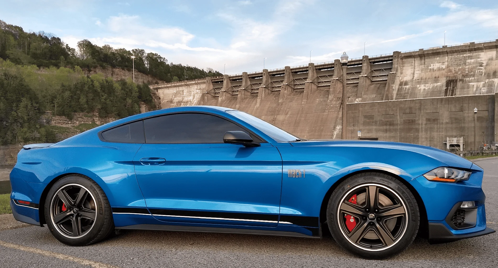

03 F-250 21 Mach 1
Non/HP, Base Wheels
Stock Front 28.15
Stock Rear 28.56
Steeda Sports / Steeda Camber Plates
Front 27.44
Rear 28

Very interesting that those Sport springs didn't drop you more than that. They say it's supposed to be close to 1 inch. But that would be consistent with mine minus the HP wheel/tire combo. Got any pics?

I think they are advertised as 1" drop for GTs with m.r. I think the mach sits a little lower from factory.,

Any tire rub with those springs?

No rub issues.
I'd guess it would be awfully close with if you had fender trim. But at least we have conformation the Sport springs only drop a M1 .7" front and .55" rear. Thanks for sharing. 👍🏻

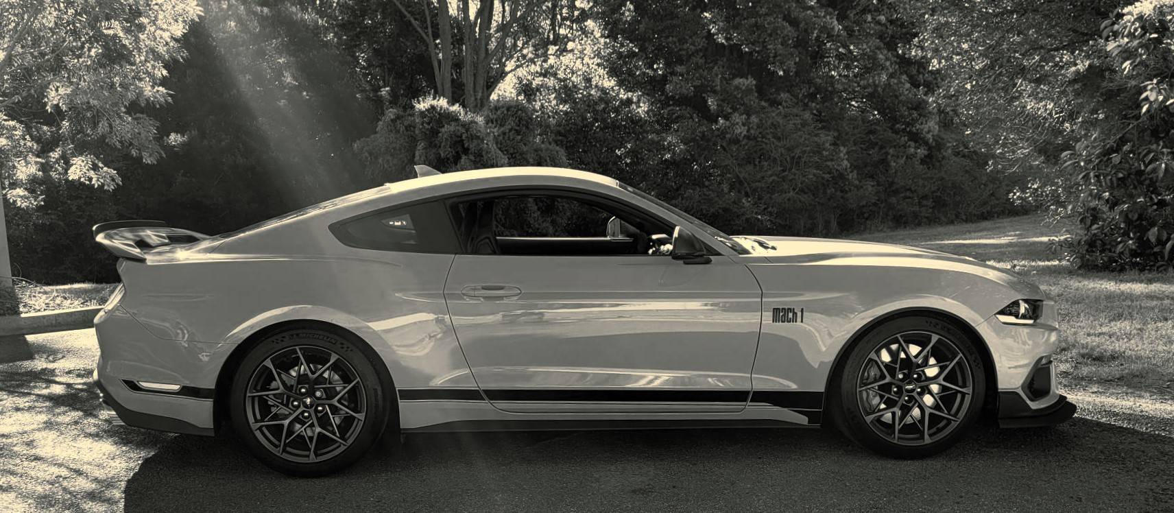

'20 Grand Cherokee Limited X, '22 Mach 1 HP
HP with stock HP springs
HP wheels with Cup 2s (305/30/19, 315/30/19)
Front: 27"
Rear: 28"

Wow. I'm surprised there is a 1" difference between front and back.
