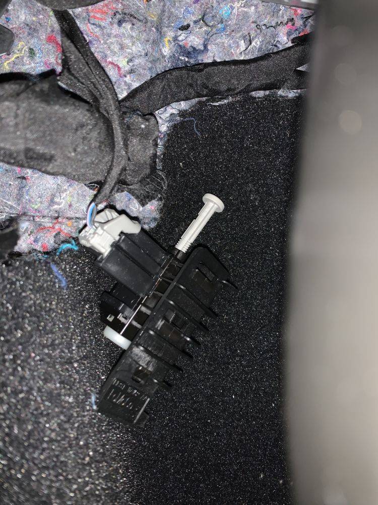

Hello,
This black box with a white plunger is under the clutch pedal and is not affixed to anything, it's just dangling there.
What is it?
Thanks.

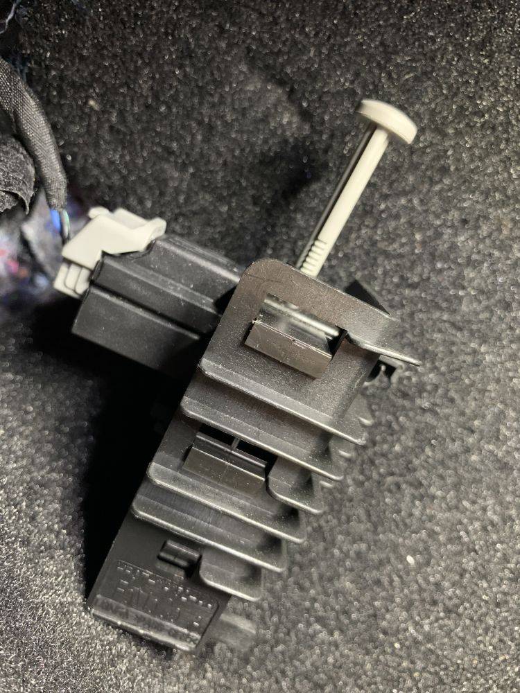

I see an electrical connector at the top of the pedal, which indicates there's switch there, but I can't see the switch itself, I don't know if it looks like a plunger or not.
Here's a better picture:
And a close-up showing what's inscribed on it:

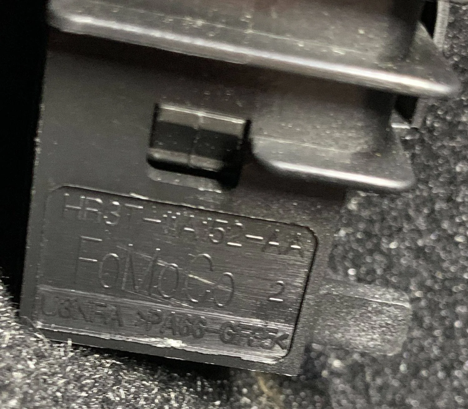

The part number is HR3T-11A152-AA. A Google search for this part number reveals nothing relevant.

Oh, yes, no problem so far. Everything seems to work fine.
But I'm just curious as to what that might be. It looks strange just dangling there, not attached to anything, and having a plunger that's obviously never going to be pushed.
I suspected it might be the switch from the clutch pedal, but it can't be, because in that case the engine would not start, would it?

That's the CPP switch. It disengages cruise control when you press the clutch in.
Here is where it is mounted:
Note the orientation is rotated 90 deg from the 2016 service manual, but this shows where it goes.
