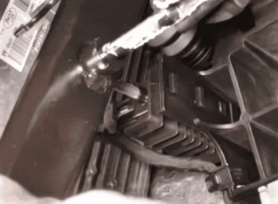

Thanks, guys. I managed to see the place where it should have been installed, though figuring out exactly in which position, and how it was supposed to be attached, proved much harder. And once I figured that out, actually putting it back in that position proved even harder still. It took fifteen minutes of contorting myself in all imaginable ways, and a lot of cursing, but in the end I made it. :like:

Glad you figured it out. Makes me wonder if the assembly line worker just "gave up" on installing it.

What's funny is that I don't even use the cruise control. If I hadn't been looking at the clutch pedal to figure out how to install the Steeda spring, I could have driven for years without even suspecting anything. :cwl:
I can't blame him. :giggle:

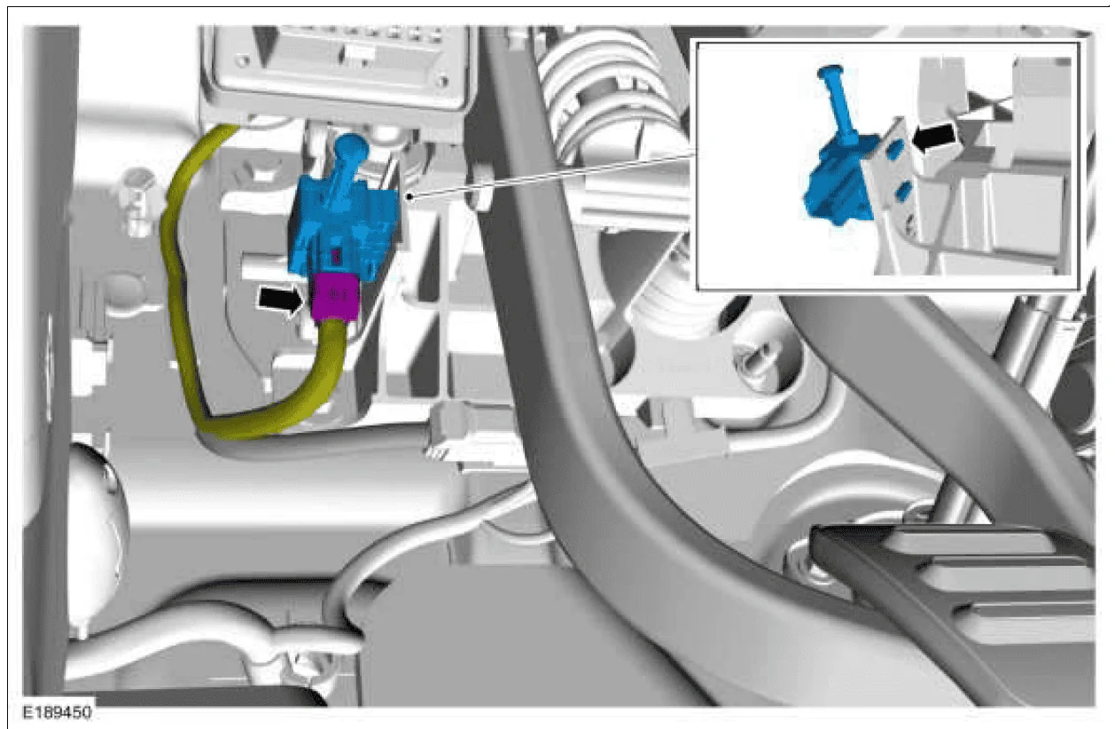

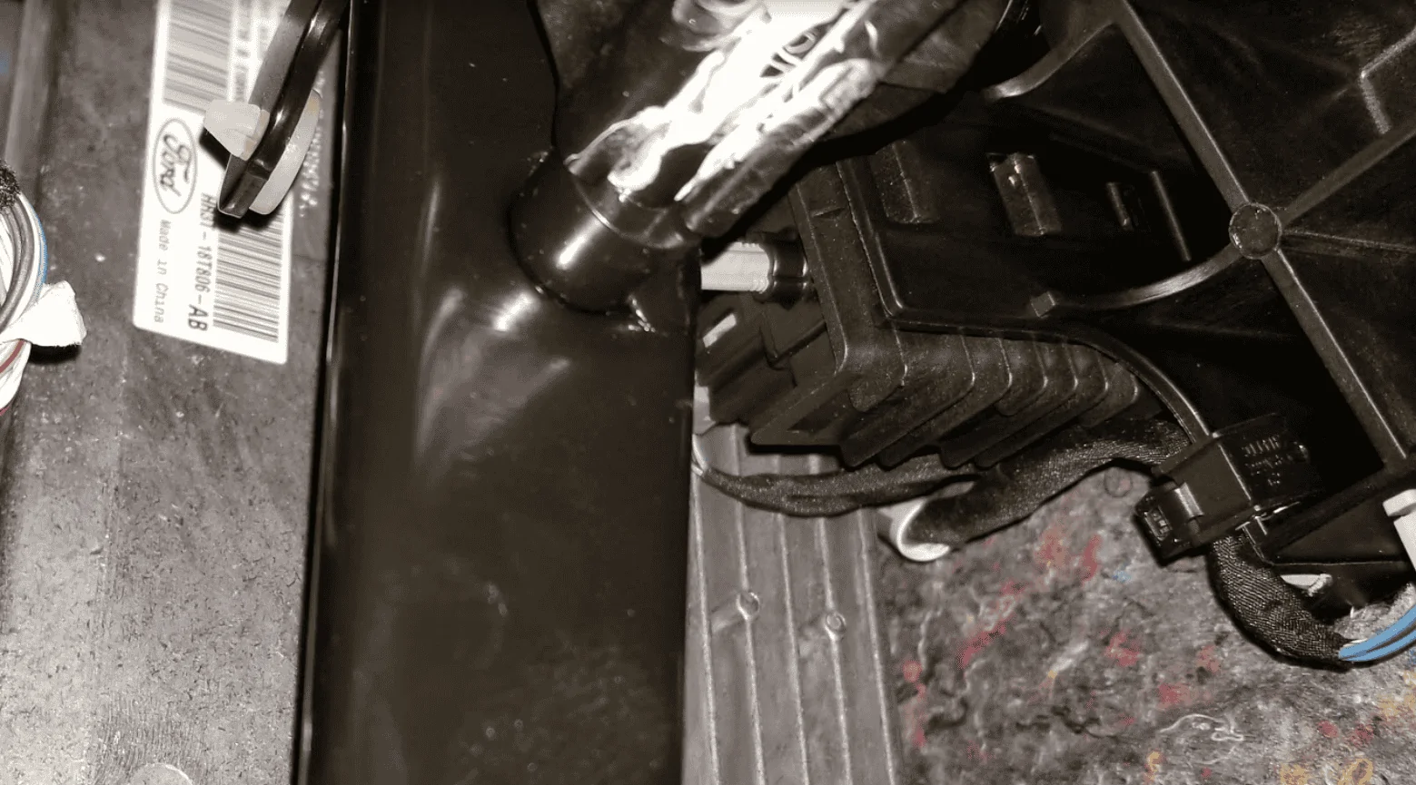

So I had to have a look at some old pictures I took before I removed my amplifier. I found this:
The clutch is in the resting position. So you would think that if this switch was working in conjunction with the cruise system that it would be on the opposite side of the activation arm (on the left) It would appear as though the switch in question is for detecting when the clutch pedal is pressed all the way in. Is there another switch?
