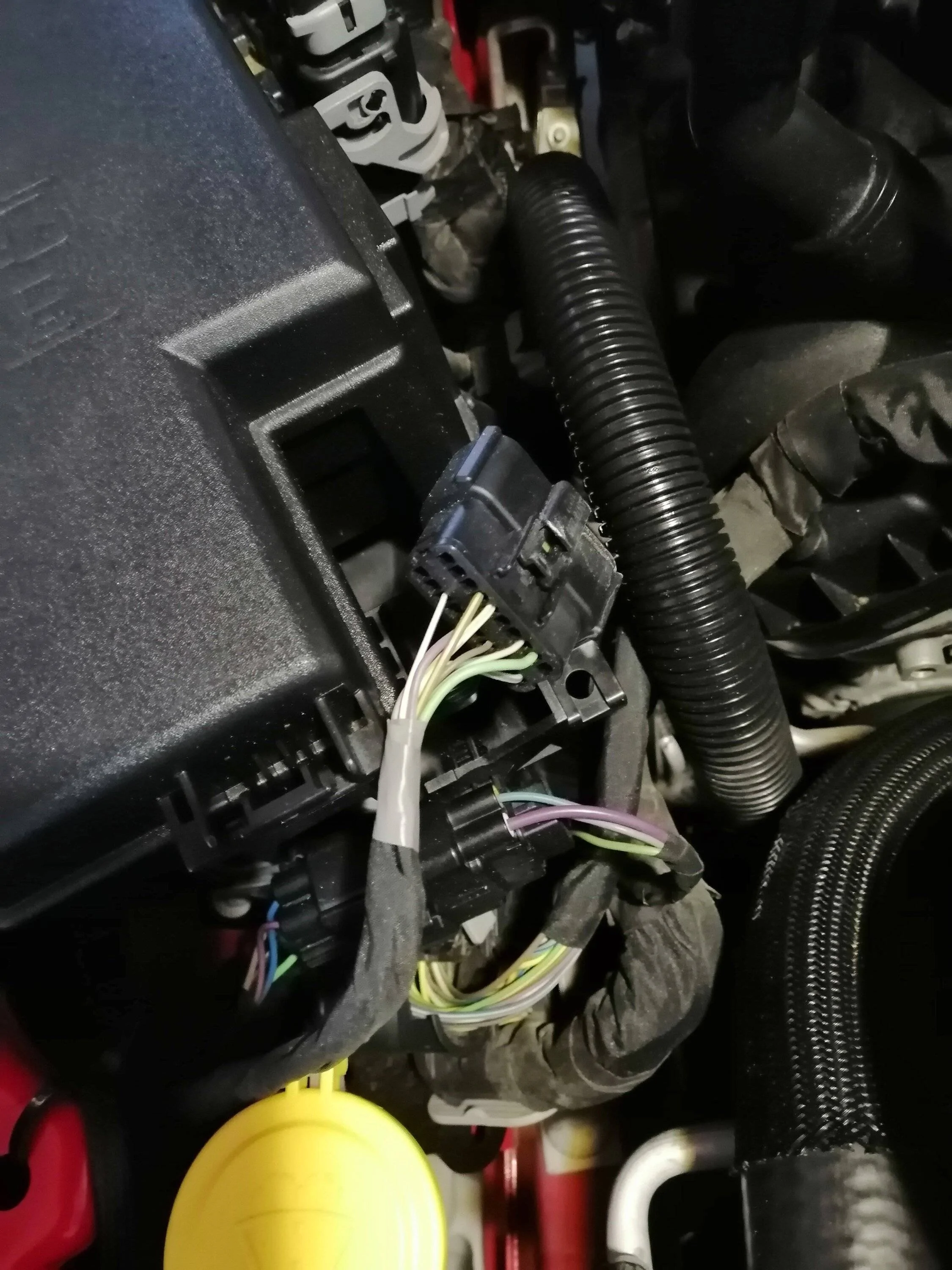

Hello everyone,
I found this connector hanging underneath the fuse box (passenger side). Can't seem to find anything to plug it in, anyone knows what is this for? Kinda have the same size as the headlight connector from the look of it.

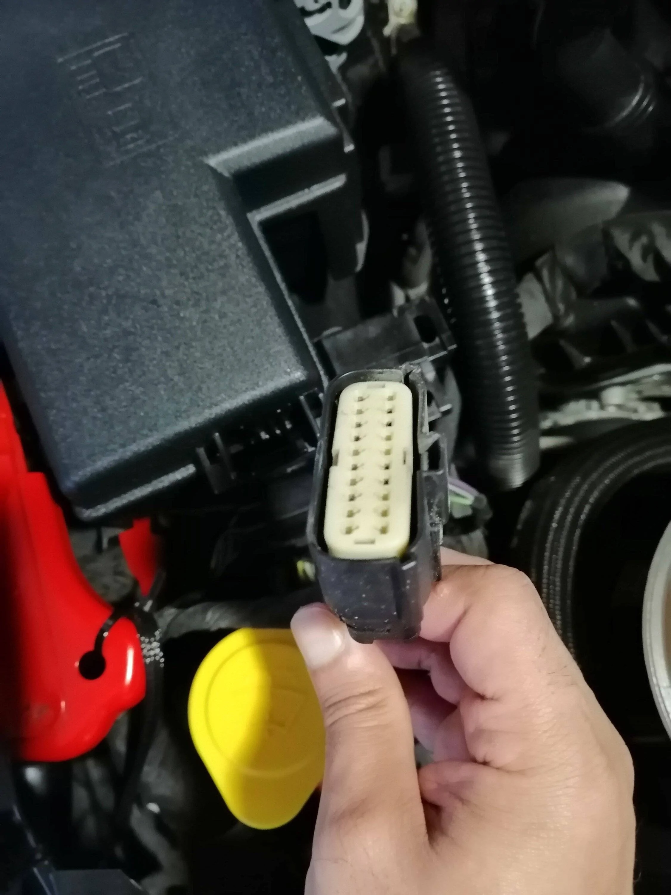

I guess you are an M6 car ?
I believe it is used on the A10, and redundant on the M6 :like:
Yours looks like it might have been disturbed though (maybe just for the photo ?), mine is mounted / secured - best picture I have that captures it :
WD :like:
WD :like:
Not sure what or who u talking to.

Lol. Hes talking to you. Zoom in on the fuse box in the photo and you'll see that the connector is secured by some sort of mounting attachment. Yours doesn't appear to have the mount any more. ;)

Oh my bad, i see what you mean. The thing is everything runs normally & I'm wondering if it matters to plug it in.. but it's bothering me not able to tell what is it for. Would you mind check where is that connector that my mystery connector plugged to? I wonder if its wire coming out the fuse box or which harnesses?

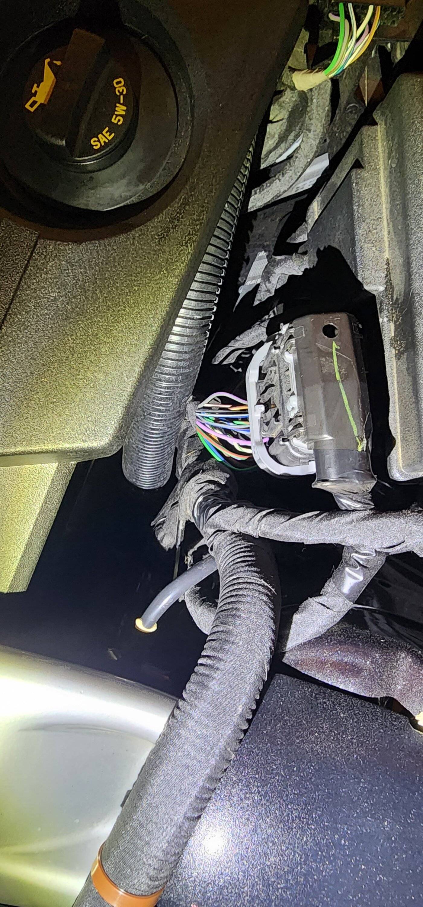

I've got the 10R80, so my connector is used. Can't tell what harness is involved - wires from both sides of the connector go into the same harness just below the connector.
If I were you I may try to replace the missing mount bracket and/or cover the open connector with something to keep dirt and moisture out of it and not worry. It seems that this is normal for non-10R80 cars.

Is yours look the same as WD Pro?
Same place and condition, yes. Occasionally I take a paperclip and short out the pins while the engine is running. :crazy: Nothing yet. :giggle:. JK.
You can imagine the Engineering, labor and cost of building these harnesses. Ford and others will make one harness for everything, then use only what they need.
It would seem for M6-type cars, the plug is a leftover.
