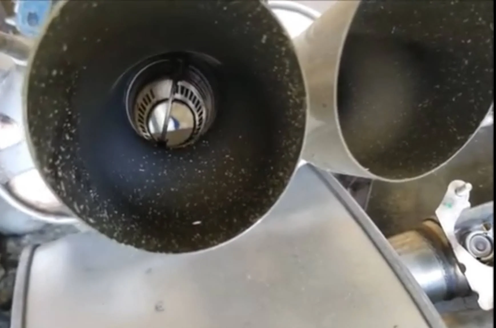

Just wondering if anyone has been curious enough to cut open a 2018 non-active GT muffler to see what the construction inside is like? Straight through, baffled, holes for resonator effect, etc.
I know this thread is old, but I am dropping this picture as a reference here. It appeared to confirm that the stock Active Exhaust muffler a straight through design with perforations to direct the gas to the muffling part of the second tips.
Source: My screenshot of a Youtube Video by Crossplane Nation

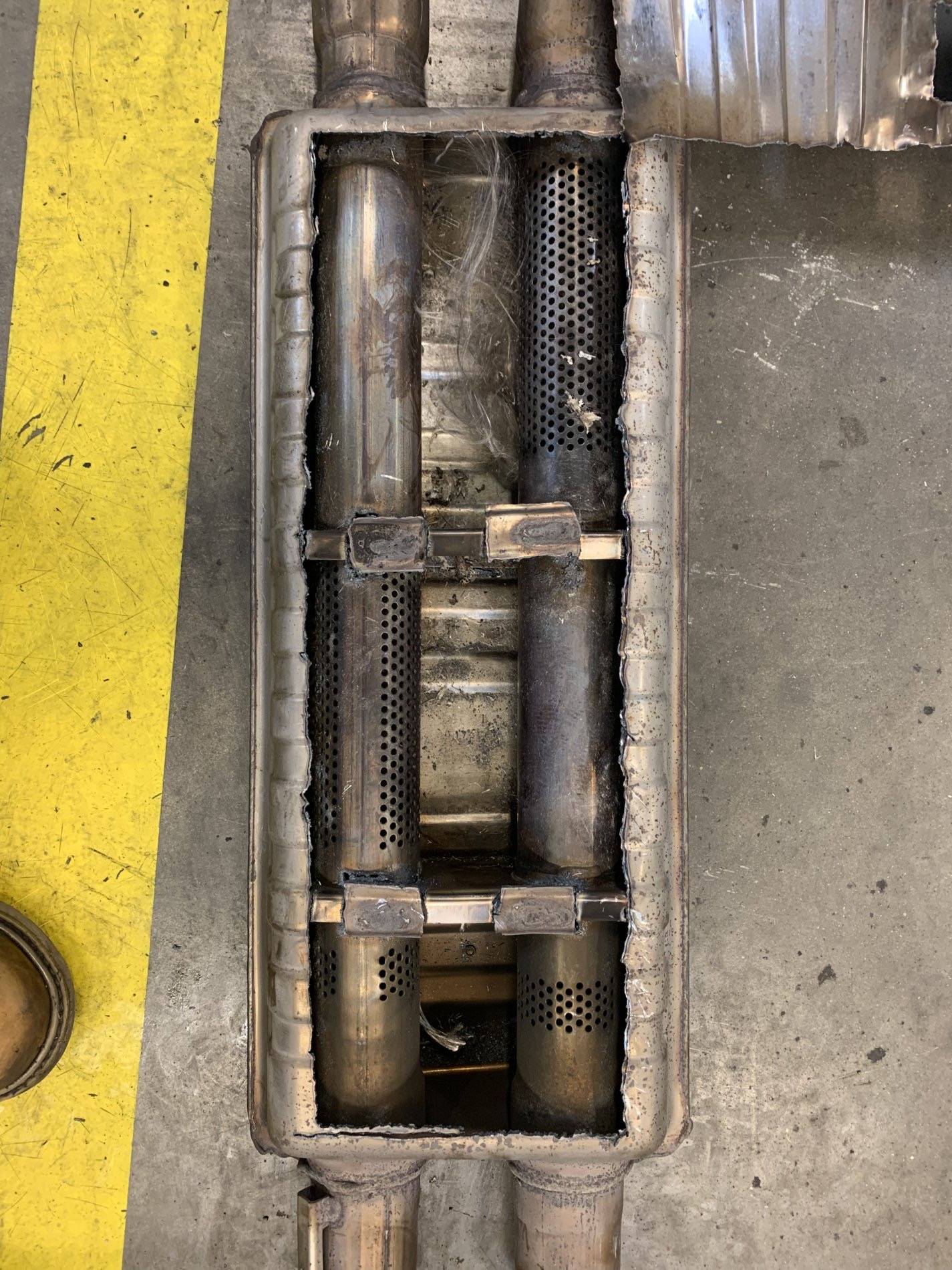

Check out this post :
Our euro exhausts get delivered like this :
Which looks a bit shit if your one of those people that doesn't just look at the wheel, but you are tempted to look past the wheel :
So why it was off I took the opportunity to strip it and have it metallic ceramic coated - it should keep it looking good (especially compared to 'as supplied') and it should keep about 30% of the radiated heat away from the diff without having to wrap that area.
Anyhow, the descriptions on how the box works further up this thread are perfect, but I can add a bit more info when you reference these three photos.
Note the spot welds around the box :
They hold an internal baffle plate. splitting the box into two chambers.
I will call the first smaller chamber number 1 and the second larger chamber number 2.
Chamber 1 has a condensation drain.
Here is the non valve outer exhaust pipe internals :
That's the outer box wall you can see (remember our euros have a GPF so the internals are pretty mush as clean as the day they were made).
That pipe is perforated and runs through both chambers, pretty much up to the outer box wall.
Here is the valve inner / central exhaust pipe internals :
Note it was really hard to get a good photo down there as the valve took all the flash and the focus.
By naked eye, you can see straight down it, out of the back of the box and right to the first bend in the exhaust tubing.
Like the outer pipe it's perforated and as best as my eye can make out, I think the pipe has a small gap in it that vents into chamber 1 i.e. rather than one continuous pipe, it looks like two pipes perfectly in line, but slightly separated.
So ...
Valve open = Gas is straight though both chambers with some pipe perforations.
Valve closed = Gas backs up behind the valve. (depending on the box stuffing in chamber 2) a small proportion of the gas will pass through the perforations into chamber 2 and out of the perforations into the other tailpipe. Majority of the gas will pass through the pipe separation into chamber 1, head to the back of the box, to exit the other tailpipe passing some more perforations on the way.
Hope that helps - and saves @skinnyb from taking the sawzall to his exhaust ... lol

Thank you for the details, WD. Were you able to tell if they have fibre /stainless wool/mesh around both pipes?
WD Pro
Jan 18, 2018
132
6,814
13,656
United Kingdom
Lime GT
I’m not sure to be honest and I’m not cutting mine up to find out … :giggle:
This photo of a resonator would suggest that at least one of the compartments is glass packed :
WD :like:
jpogi
Oct 23, 2019
54
Louisville, KY
JP
2019 Mustang GT Black Accent pkg
There is a youtube video of a kid cutting this open.
There are fibers and wool mesh in the two big chambers. But the small chamber does not have any, probably because both pipes are perforated and needed pressure to crossover for accoustics.
