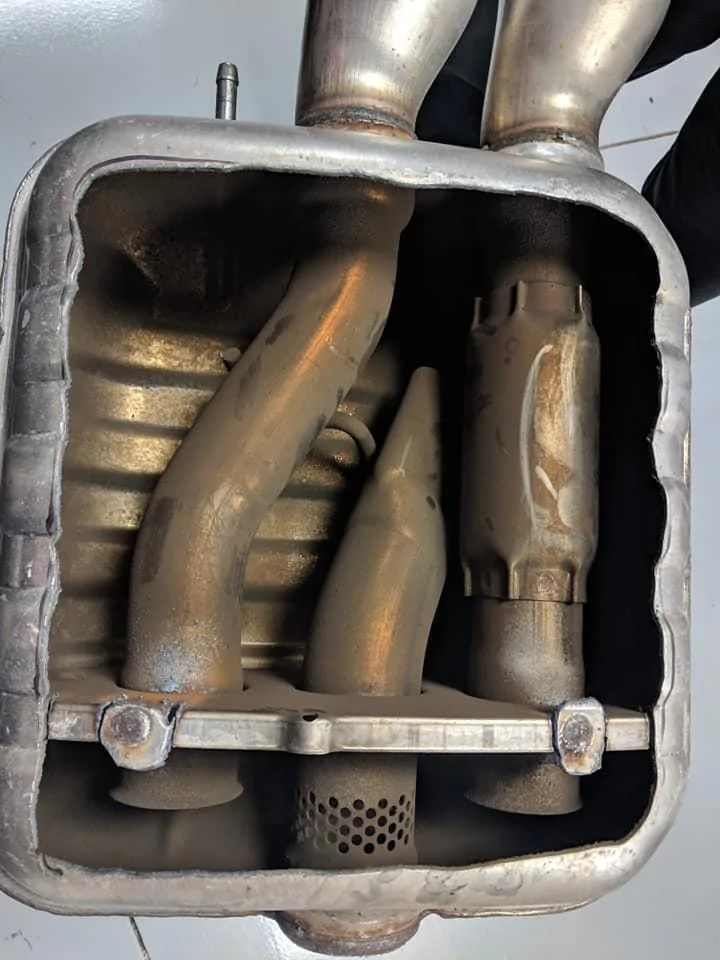

Actually seeing those pics was what made me wonder about the 2018's. The resonator looks pretty much the same but the outside of the muffler is a lot different shape.

You can look down the inside tip of an active mufflers and see straight through into the bend, it's actually a stellar design!

I don't know for sure, but most likely there's baffling in there. Straight through mufflers are pretty loud. I do agree Ford nailed it for a stock exhaust sound.

So I bought an inspection scope and looked into each tip. Both tips have a short portion of straight pipe with resonator holes that ends at the back wall of the muffler. The muffler inlet appears to be an internal pipe with large holes that is not in line with either tip, so the exhaust gas has to enter the muffler and be diffused to either side for exit. Definitely not a straight through design.
