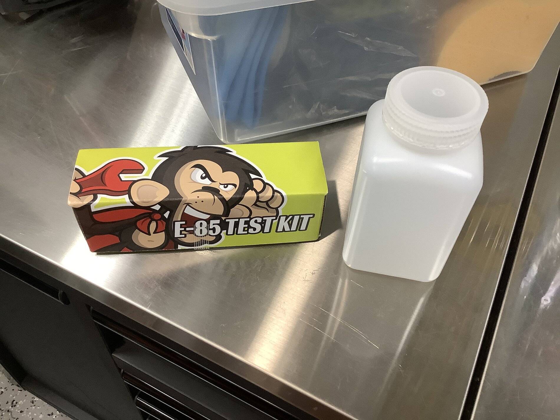

Just picked up an nGauge with plans to order a tune from Lund next week. Here is my dilemma:
  • Order a Flex-fuel tune?
    or
  • E85R and 93 tune?
I have E85 readily available within a few miles from my house. I also have 93 octane available. I've seen the debates about flex fuel vs. straight E85 and 93 tunes. I have a test tube arriving tomorrow. If the fuel tests out near or above 85% should I just run E85 with plans to switch over to 93 when it gets cold?

I’d test it every time. The station where I got 84.7% has also tested at 72.5% within days between fill ups. I keep a little container, along with my E85 test kit and a bottle of drinking water with me in the car.
