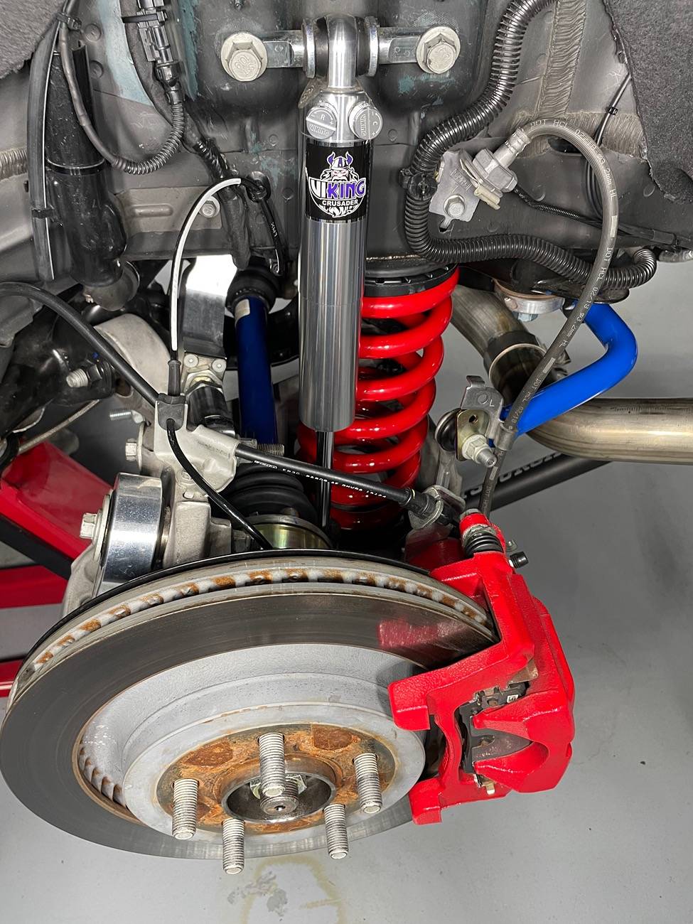

Gonna need some double adjustable shocks out back. The only problem is, you’ll have to perform the workaround (install resistors to keep the PCM happy), in order to use them on your Magneride suspension. I did this on my 2019 Bullitt, along with BMR Magneride drag springs and it works great (no warning lights or codes).

I like my shocks! They’re actually KellTrac - Ultra Spec Inverted double adjustable Vikings. The adjuster knobs are up top and much easier to access than a standard Viking shock which has the knobs at the bottom. They also provide more clearance between the shocks and half shaft boots.
If you decide to buy shunts to bypass the signal to fool the PCM, just FYI, I bought Shock Delete Engineering sensors for mine and they only worked some of the time. Other times the car would into Suspension Fault mode - Speed restricted to 80 MPH.
Now that I’m running the DIY version, I haven’t had one issue at all.
