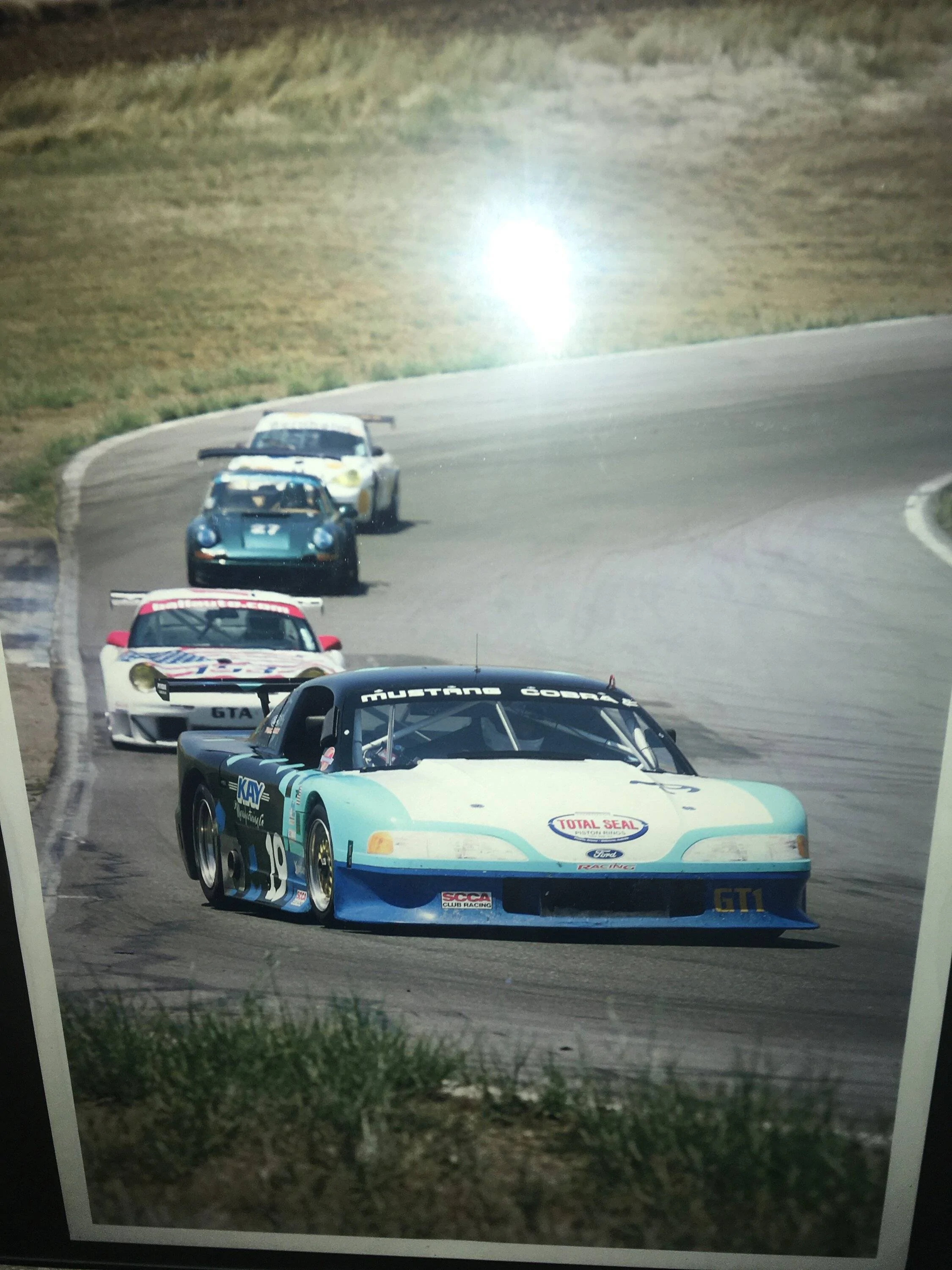

So, my old race car, a 1989 Mustang Trans Am built by Jack Roush, pictured below, had rear camber that did not involved bending axles or extra load on bearings and my recollection was about -1.5*
here how it was done:
First the car had a full floater rear axle, for people that don’t know what it is, it’s simply a system where the weight of the vehicle is 100% supported by the axle tubes and none by the axle shafts, therefore the “full floater” term
The wheel hub/stud assembly was mounted to the axle flange with 4 bolts BUT, in between was a spacer that was machined with a taper shape, meaning 1 end was thicker the the other one. That created the camber for the wheel and because it was a full floater the splines could work at a small angle…
Pretty smart engineering and really show how good Roush was
