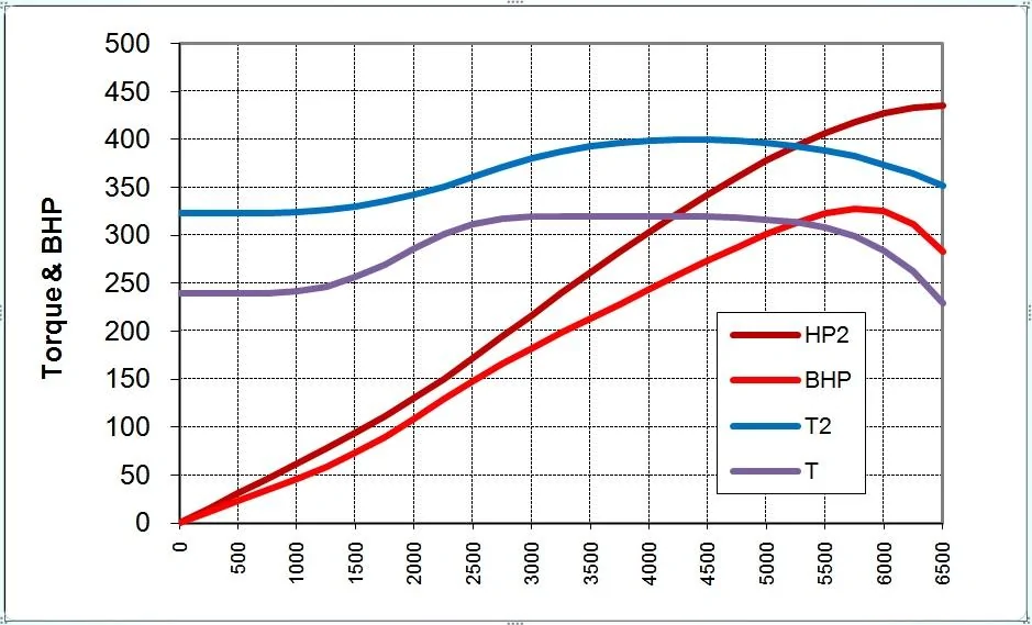

http://www.mustang6g.com/forums/showthread.php?t=19465
torque curves on the EB & V8 are fairly similar out to 3000-3500 RPM
theoretically you could look at the torque curves and figure out what RPM is required to break traction when turning off of a stop sign, and then just keep RPM's below that when taking other turns. That might be 200 lb ft on dry payment, and 100 lb ft on web pavement. I just made up those numbers.
I am not sure how HP factors into this
