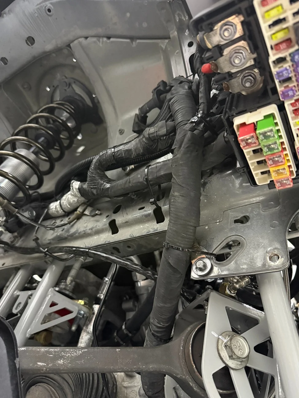

My G-trac brace was rusted to hell. I literally just threw it away the other day, as I didn't need it anymore since I have the Steeda tubular sub-frame now. I sure hope this subframe holds up and doesn't look like shit in a year.... You can kinda see the subframe in this picture when we relocated computer and fuse box under the passenger headlight.
I double checked my g-trac brace today and all powercoat is intact aside from some road dust/grime build up in some areas. It is actually the later revision of the part where it is now angled down to be more compatible at clearing A10 transmissions, the original straight bar version I had to return years earlier cause it made contact with my transmission pipes that sat lower vs some, the new Steeda revision fixed it.

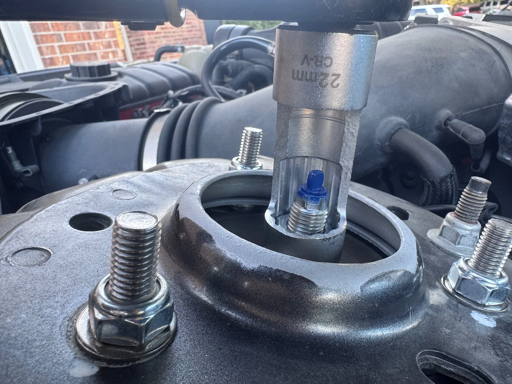

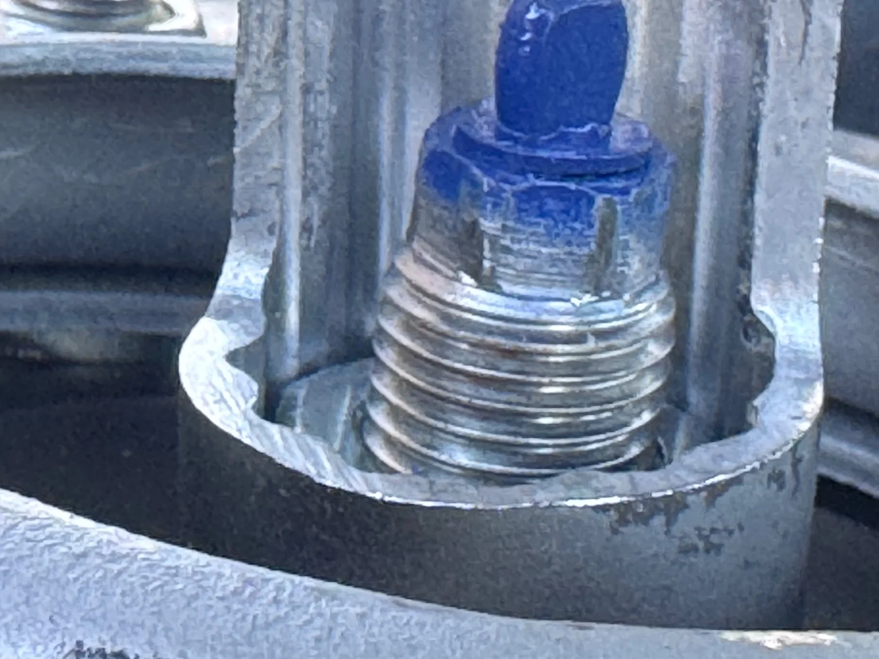

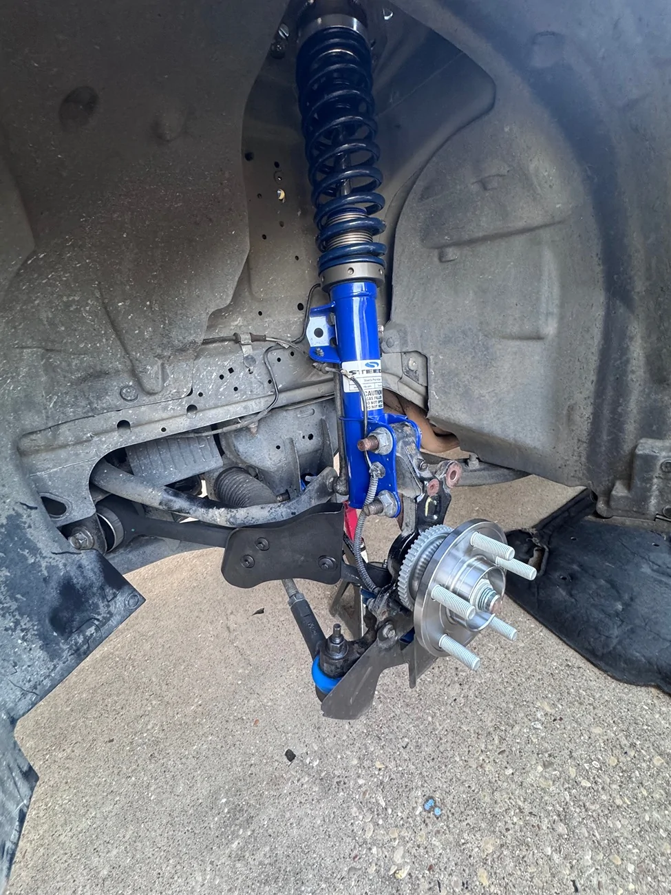

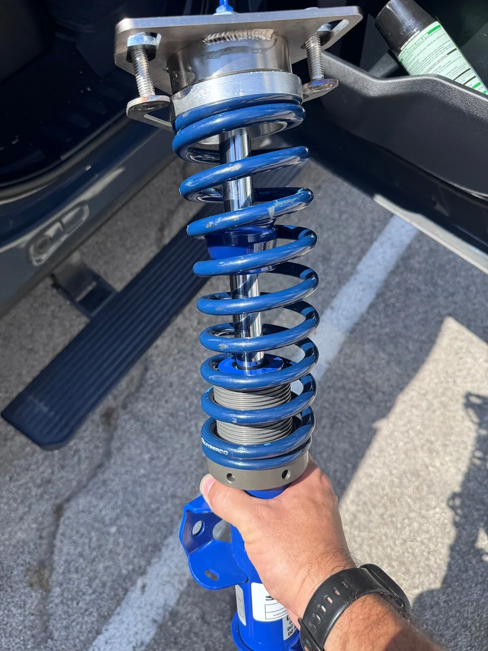

Ohhhh how did I forget this gem. Ordered the Steeda Pro Action front Drag Coilovers and they don’t come assembled. No biggie I’ve been installing suspension for over 20yrs. Go to put it together and for life of me I cannot get the coil compressed enough to get the top hat on. I email/call Steeda a few times and they swear it’s the right springs. Visit two shops before they could barely get it compressed enough to get the nut on. Run it down some and the picture says it all. I bought Steeda’s sockets to torque correctly and there was so much pressure from the spring that the cheap nut started to round. At that point I called again and emailed with pictures and they admitted they sent the wrong spring. They tried to replace the springs and I said no, I do not trust the product and want a full refund. They were fair and did provide me a full refund. I turned around and ordered the KellTrac long travels and couldn’t be happier.

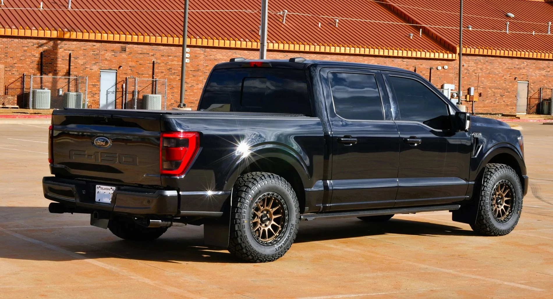

It's cool but I get your point. I had the headlights and tailights of my F150 tinted for awhile but then I took the headlights tint after about a year since it was bleaching a bit. But that truck had very bright headlights so even with them tinted they were still better than any vehicle with halogens. I also had my windshield tinted lol.
