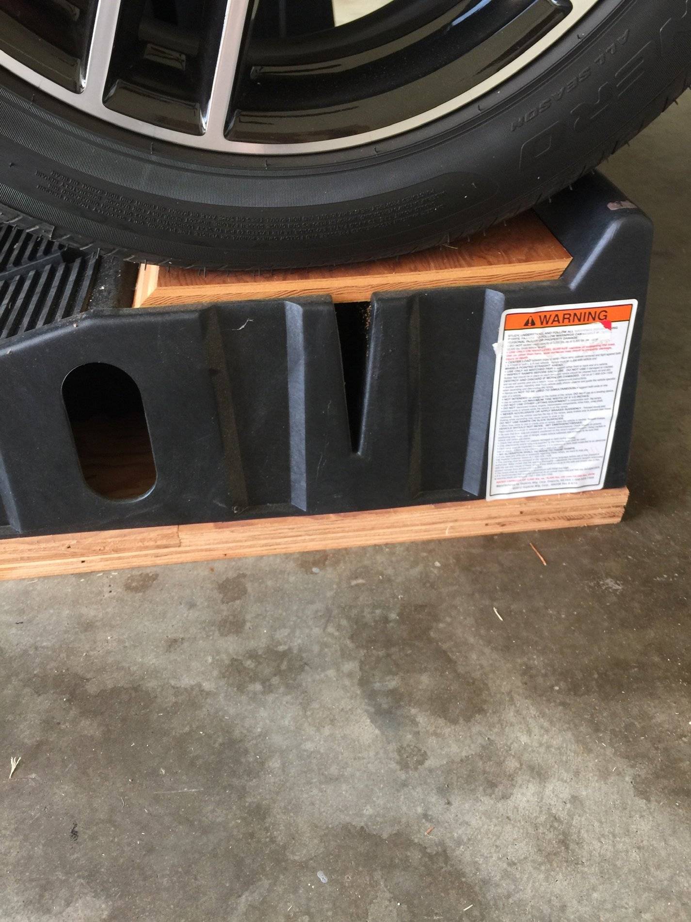

I have ramps but it looks like I will not be able to drive up on them due to how low our mustangs are.
Put 1”x 2” or 2” x 4” in front of the ramps so the tires ride on them before the ramps and it will clear.

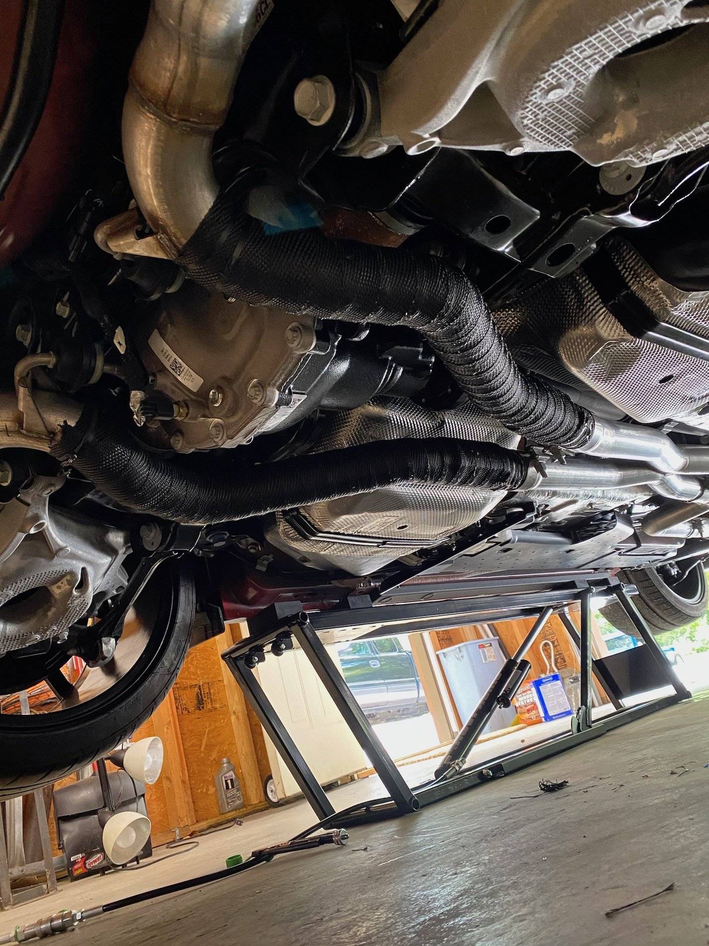

I am using the bit expensive, but when bought perfect, Quickjack BL-5000SLX.
It works like a charm and gives plenty of space to be under the car. It also have a build-in faliure safety so if the hydraulics fails it has a locking mechanism so the lift won't drop.
When lifting I just use rubber blocks on the pinchwields where the side skirts has a cutout for lifting. Works great! :like:

Used one time, value is realized, the perfect addition for the Mustang & owner.

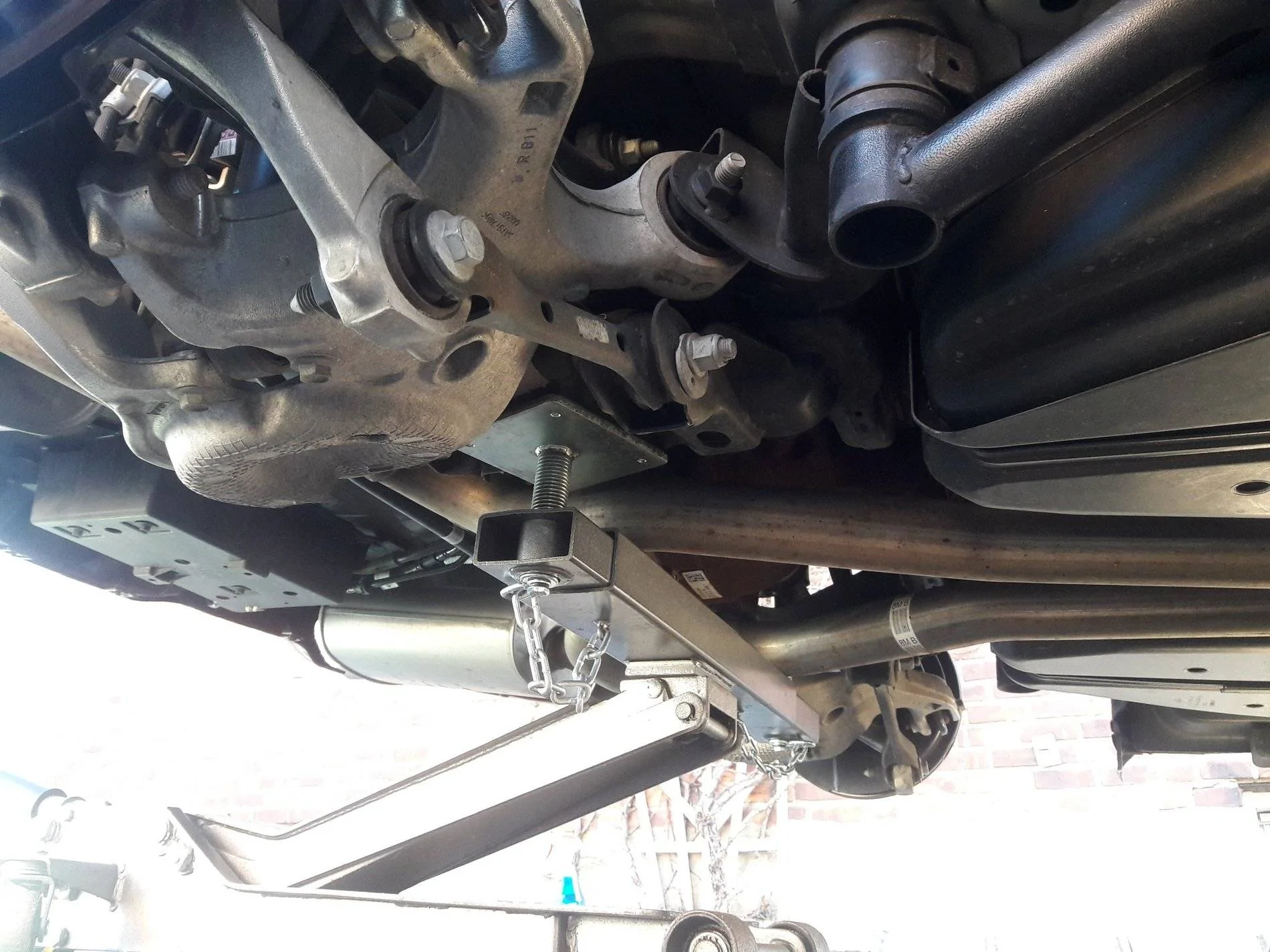

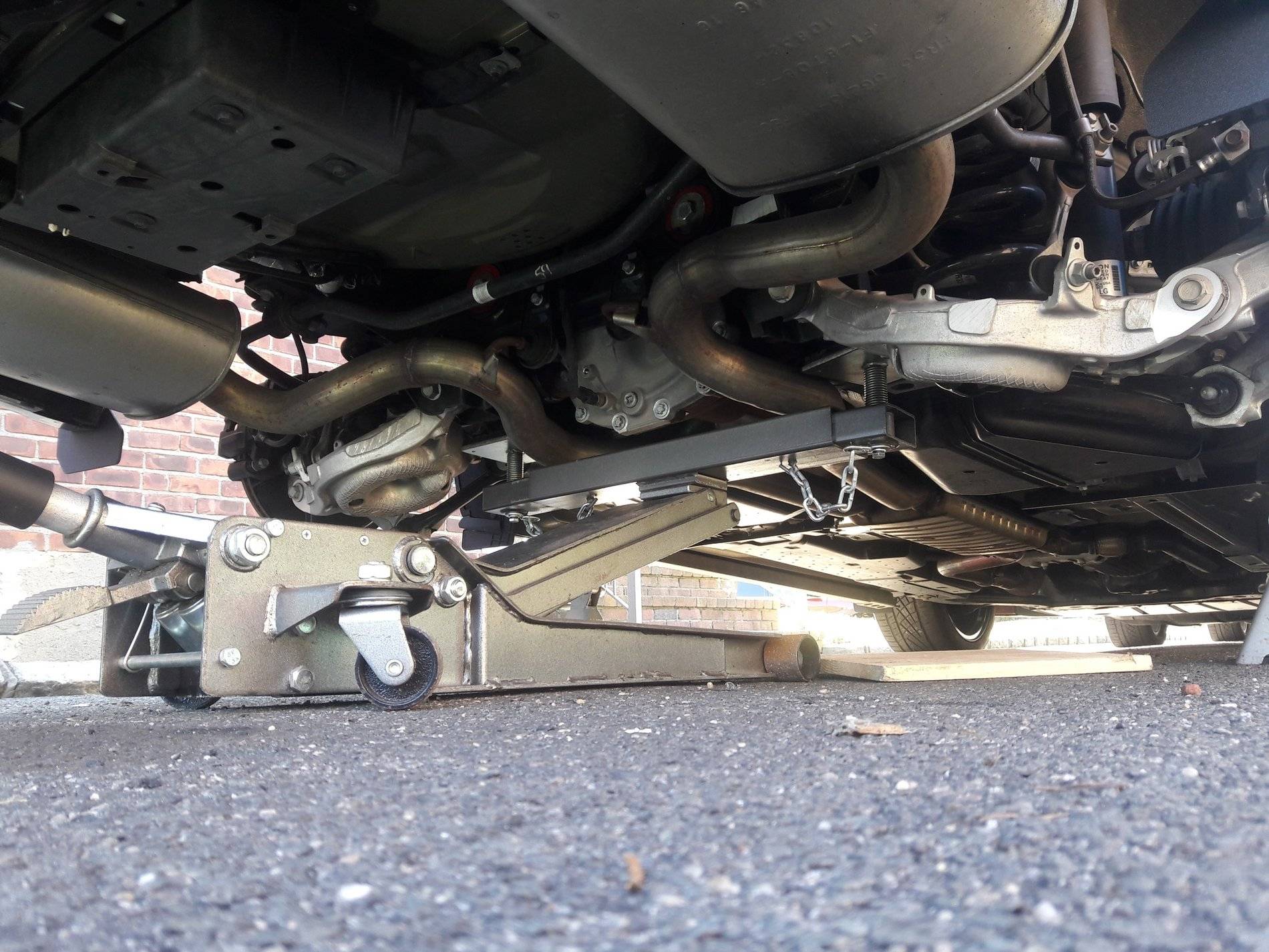

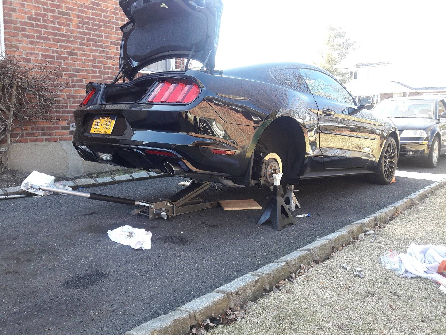

You can get by without jacking rails but it does make it so much easier. The pictured set up is a low profile extended reach jack and cross beam attachment , both from Harbor Freight. Once in the air, position the jackstands where you like
