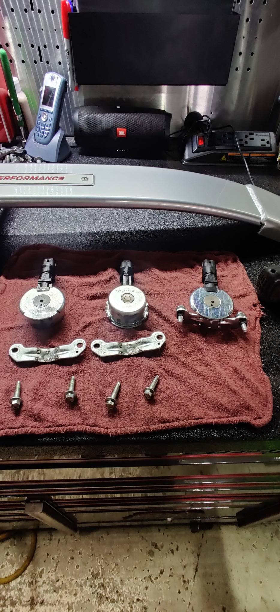

Could be an issue with the VCT’s, which are a known weak spot. I had issues with the VCT’s on 4 separate occasions. 2 times it was the wiring that went to the VCT solenoids on the valve covers. The other 2 times are when the VCT solenoids themselves detached from their brackets. Keep in mind, my car was heavily tracked, but it could still be you issue and may not throw a code until you redline the old girl a few times.
edit to add the picture: The item on the far right is how the VCT solenoid is supposed to look. The two on the left had the welds fail between the solenoid and bracket that holds it in place.
