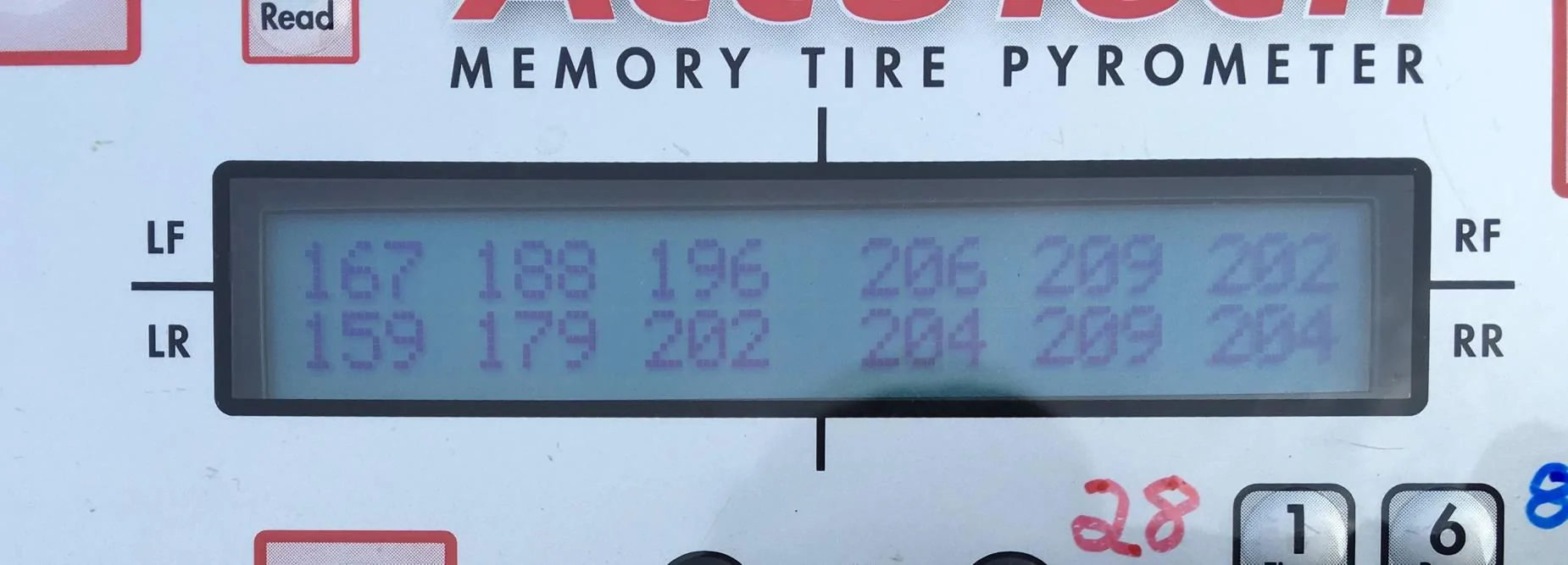

Right, but as a novice, isn't the delta good enough for me? I.e. the temps may not be accurate but their differentials would be.Not accurately because surface temps cool down so quickly.
You need a PROBE-type pyrometer, sticking the entire needle into the tire (in the center of a tread block and not further any less than 1" from the outer & inner edge of the tire for the outer/inner measurements).
My other option is a DVM with Type-K temp probe.
