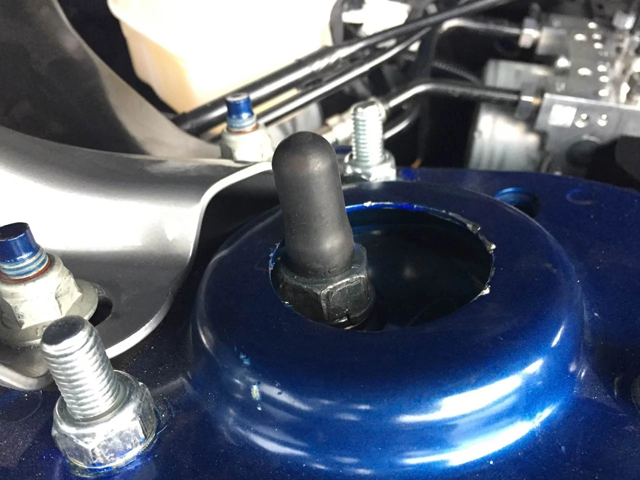

Update on my max camber. I was able to get -2.6 on the drivers side. Passenger could have gone a bit more, but I am happy with this amount. See updated pic below.

I believe I was able to get to -2.8+ with mine but the strut was wacking the edge of the hole it sticks up through. I run -2.4, which will be just fine for you. Steeda's race car uses the same camber plates but to get to -3.X camber I think they slot the strut.
Mine hit the edge of the hole on the car at about - 2.5.
Still room on the plates themselves, so a little grinding could get you to 3+. I am going to see how it likes 2.5 before modifying the stock strut tower hole.
