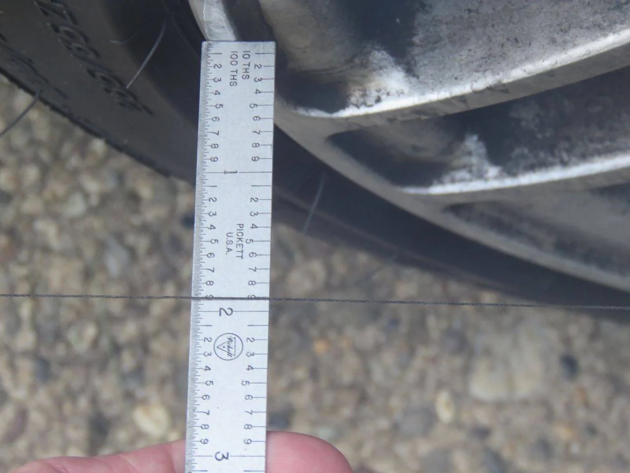

So it sounds like maybe 1/8in total toe in at street camber and then as negative track camber is added, you will get toe out for track setting. And i agree with jam nut comment, it helps keep you grounded when upside down under the car.
That's the general idea. But I can't confirm that 1/8" in with street would be exactly what you want.
OBTW i have an aluminum fixture that goes the width of the car, with a vertical fixed pointer on one end and an adjustable on the other end. Manufacturer is out of business, but this works great. Also its measuring toe at widest point of tire.
The issue with referencing off the sidewall is that tires are sometimes uneven and they all include embossed numbers and lettering that one end of your toe gauge might land on and the other doesn't, or it does and the embossing isn't the same height. Sometimes there's a rub strip, which in some cases might be the widest location, but could be gouged by a curb strike.

I run 1/8in total toe on the street for all my vehicles and it seems to work. Stable and no tire wear. Not saying its perfect. When i track, i go 1/8in toe out, again not racing just HPDE.
WRT to my toe fixture, i agree you need to be careful with were you measure. This device is used by the Legend aspalt oval guys and can measure anywhere on the wheel/tire and its repeatable. Toe measurements in inches is referenced to the OD of the tire, so measurement at rim would have to be adjusted accordingly.

If toe settings get changed while adjusting camber. How do i adjust toe at home on my driveway?
At the tie rods. You'll need a method for measuring how much toe you have (I use parallel strings and a 6" machinist's scale, but there are fancier and more expensive approaches). Loosen the jam nut and adjust. Keep in mind that steering wheel centering will be affected if you don't adjust both tierod lengths equally (and both shorter or both longer).
