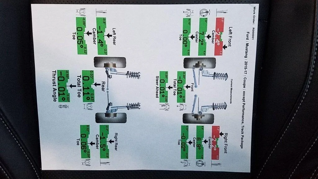

Noticed this post today. Note that I recently installed Steeda camber plates + Steeda Adjustables (F&R)+ Steeda dual-rate springs (F&R).
Finally got to go get a my track alignment done yesterday, but they could only get -2.1* max with these camber plates. I don't think it was an install error, so not sure what could be the cause. I have a question in with Steeda on this now.
For reference, I was trying to get to -2.5* Front, but my setup guy (a racer himself) was wanting to get me up to -3*. Was able to get -2* in the rear, about the max with factory setup. Also... 1/32" toe-out in front, 1/16" toe-in at rear.

Just had a great chat with SteedaTech. We confirmed that the assembly is correct, so it is likely the biggest issue is the weight on the wheels just not letting it move enough. I should have time to get this re-checked before my track day in Oct. (I'll post pix of where the shafts are located in the opening on top after getting home tonight.)

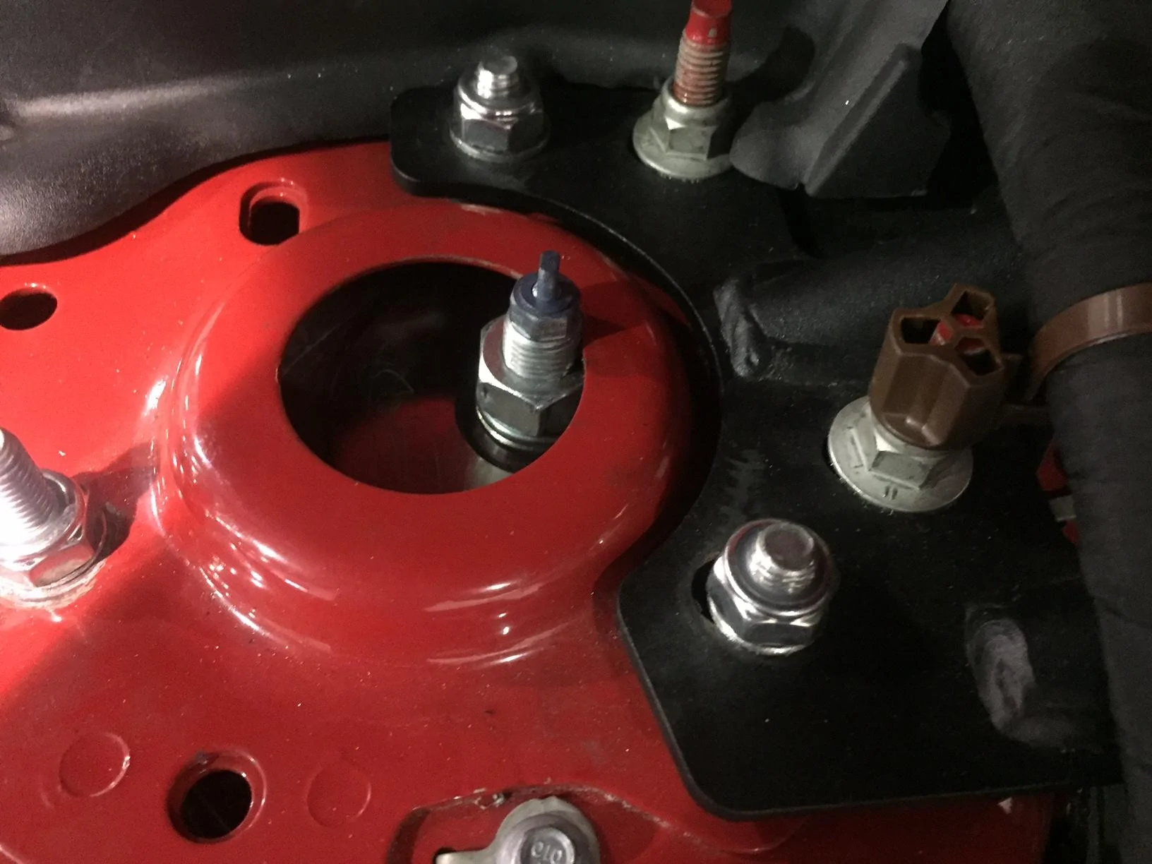

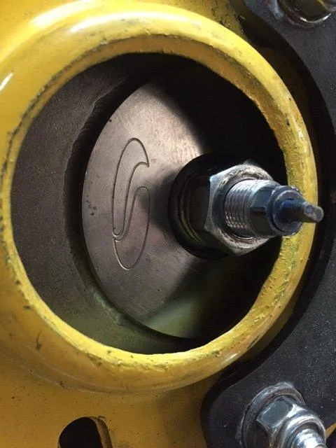

See attached pics for each side. The driver's side is close, but there is some more adjustment possible. The passenger side has even more available. Will get my shop to free it up and try to get more camber.

This is what 3 degrees of neg camber looks like. Also, once you have both plates max out to neg camber, you can easily reduce or adjust the camber with raising the center jack on the alignment machine slightly. It really is not a big deal, it takes literally seconds.

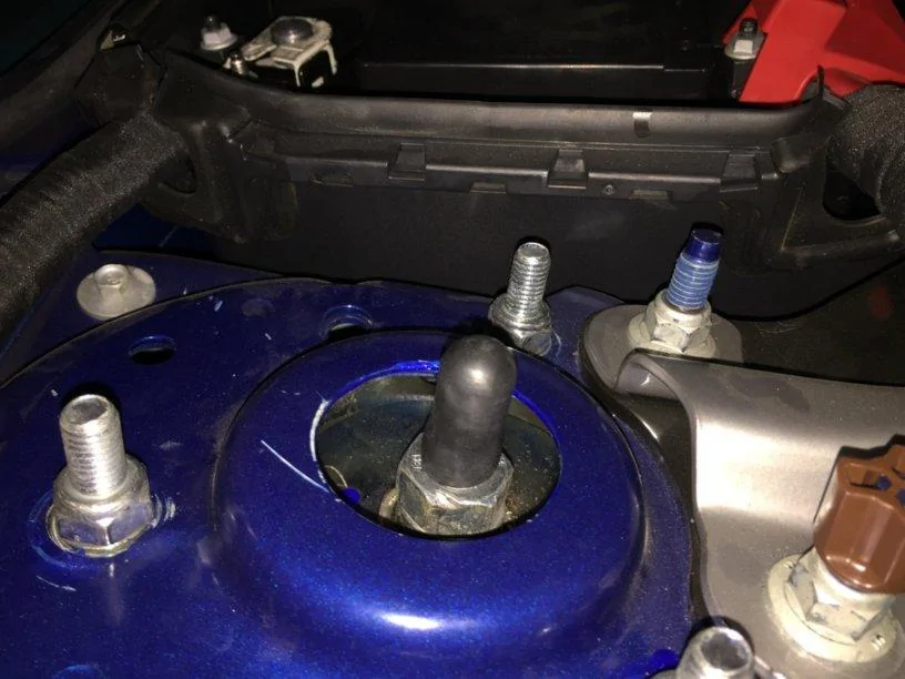

Well, I got my answer. About -2.4° max for me. This is after GT350 springs install. They did not drop my car at all (one reason I chose them).
To go higher would require slotting the struts or combine with camber bolts.

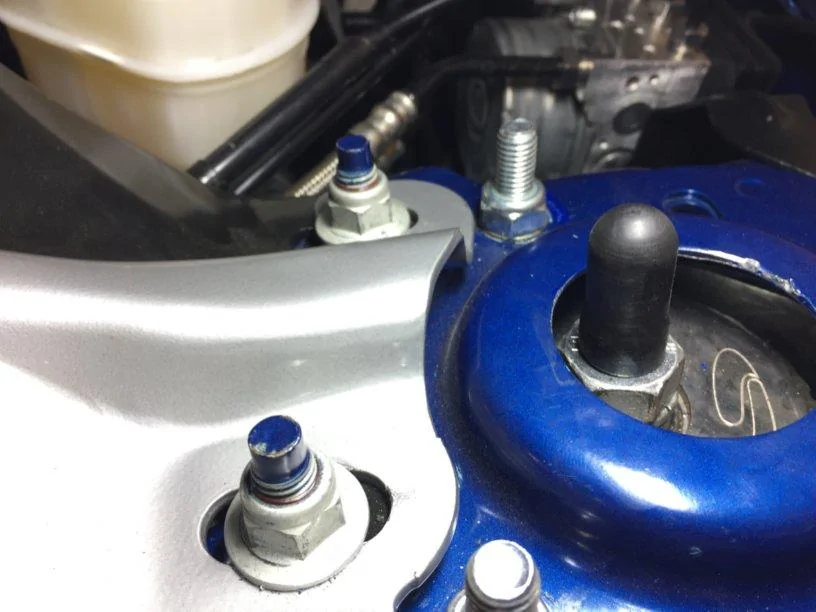

Another method would be to take a hole saw and make the hole larger dia as shown in the pic. This what we did to get 3.5 neg camber on the 20 car.
In competition we found that the slotted strut method would slip.

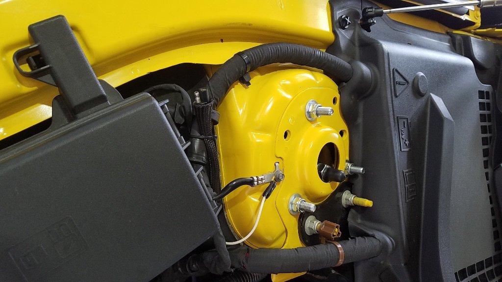

^This exactly. Slotting the strut seems unduly risky to me, unless a crescent-shaped piece was put in to take up the gap in the oval hole, to prevent slipping.
Opening the body hole above the strut mount is a more acceptable solution that I thought about.
There is obviously more camber available with the Steeda plate that the hole is blocking. Since caster is fixed (my preference) one could instead just "slot" the mount hole.
