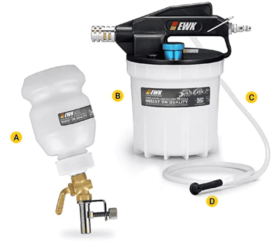

And while you are thinking brake fluid, Hands down the best method I have ever found to bleed brakes. The one pictured is a little expensive but it is a real nice metal piece, but for the same idea and will probably work just as good, harbor freight for the plastic version.
