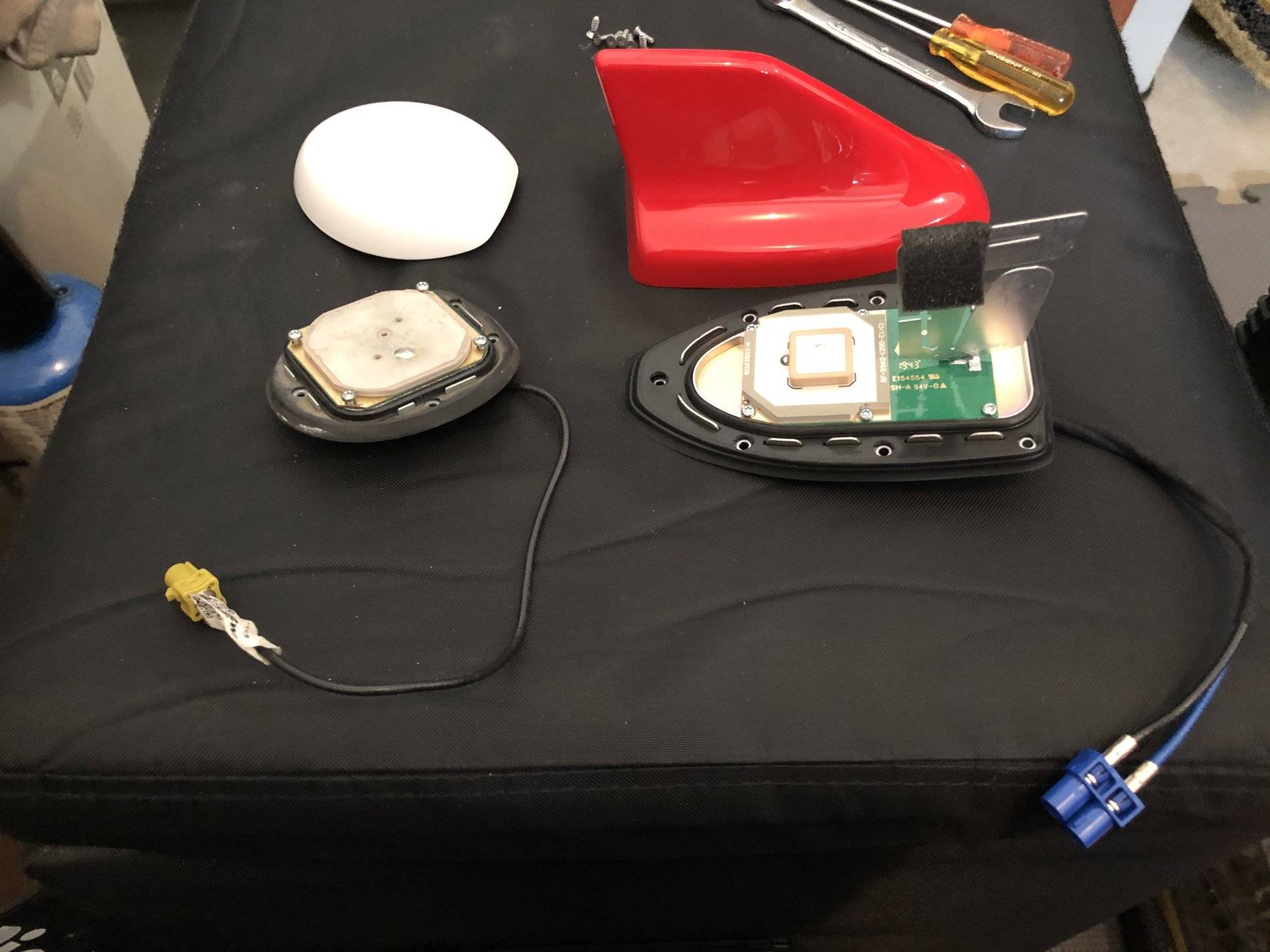

So I figured I would buy a older one and replace in myself. So I got a older and they can’t really be changed out here is what I found. So it looks like I’m stuck with the ugly shark fin.
It appears that the dual connector is set up on one side for satellite/GPS and the other for TCU(cellular). You could simply plug the cable from the bubble antenna into the one for satellite/GPS and leave the other alone. If you can't tell which wire is which you might have to experiment by plugging into each of them until your satellite/GPS started working. You will have to shave one or both of the "keys" off the sides of the connectors. The gold and blue Fakra connectors are keyed differently but if you remove the keys (use a pocket knife or razor blade) the gold connector should fit the blue one and still lock in place. You will have to align the lock up by sight since you won't have the keys guiding you anymore. Of course you will still have the mounting holes situation to deal with.
