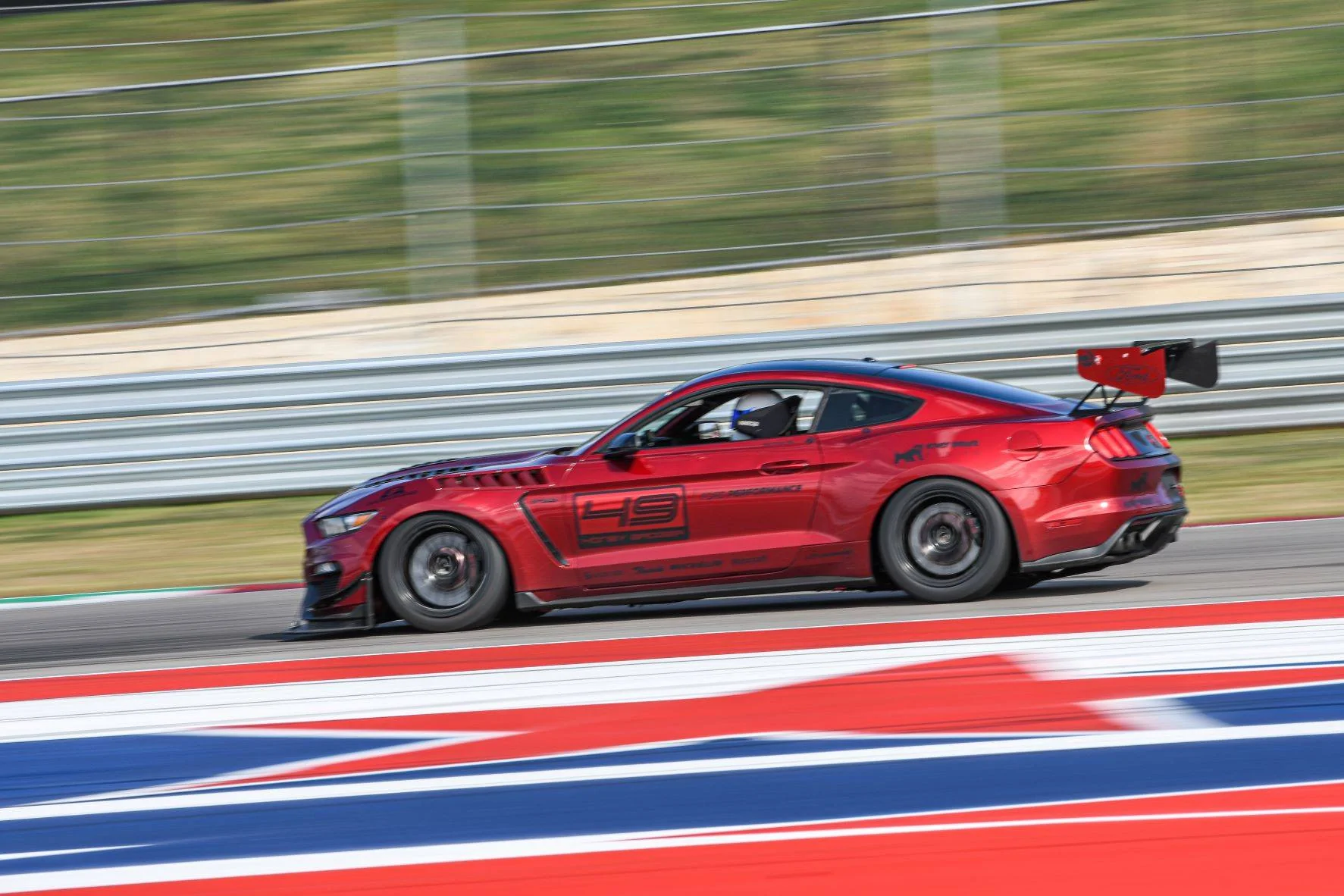

I agree. You really don't want the same compound on the rear as the front. In addition to the ABS issue, you'll want to keep in mind you probably don't have the downforce in the rear like a GT4 car, so its affects are even more pronounced. The only reason I run XR2s in the rear is because I have a fair amount of DF. If I was in a stock aero'd car running on slicks, I'd probably run XR1 front and XR3 rear.
DF makes a big difference in what rear pads you can run, IME.
