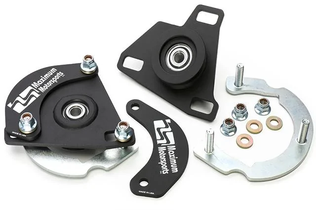

Hey this is Junior from N4SM. I have heard maximum motorsports camber plates are great!
A buddy of mine has them, he said he hasn't had any issues.
