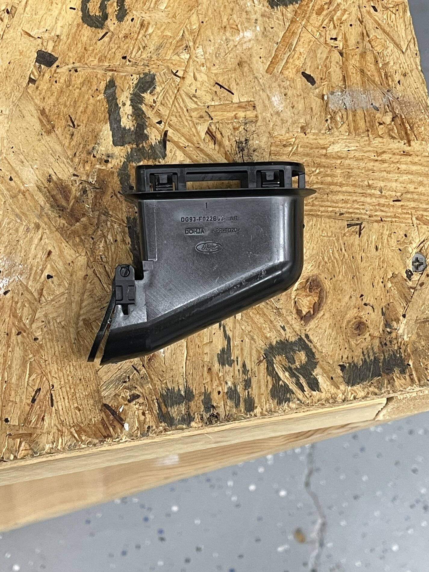

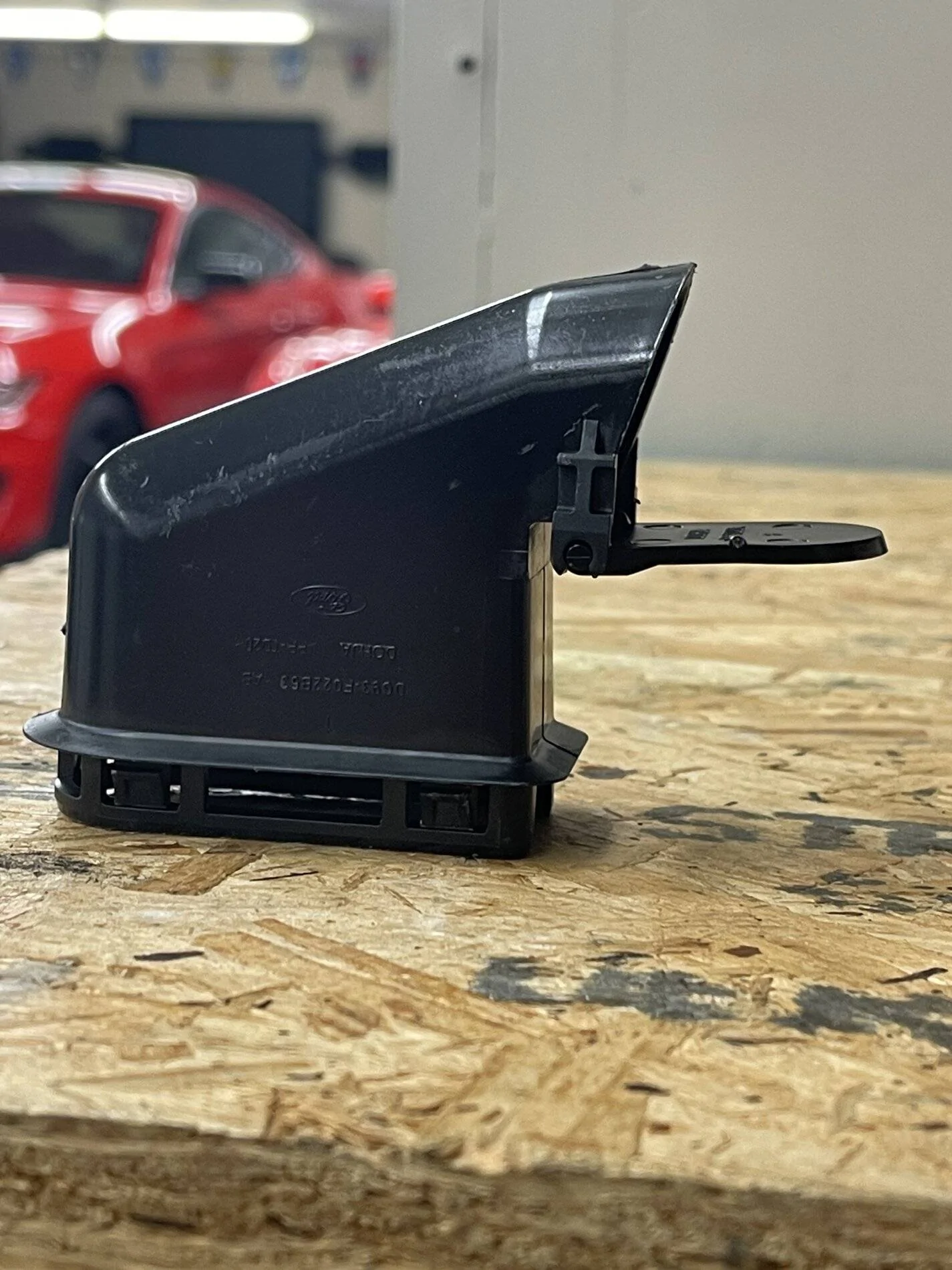

Cleaning under the car today and this fell out from the front passenger side fender well. Tried looking up the part number with no success. Guess I’ll rip the fender liner out and investigate.
DG93-F022B53-AB

I beleive its a drain valve for the cowl.

...fits directly under your battery box.
pull the battery and the box and you will see a hole that it snaps into.
...that’s where I ran my amp wire :wink:

Could also be an extra one that they dropped during assembly and were too lazy to retrieve. I had an extra hood pin nut (the underside of the hood nut, large diameter) that was laying on my belly pan.

Sweet. Thank you that will save me a lot of time. The guys that installed my sub probably knocked it out.

You have to pull back the fender liner to snap it in from the bottom. Leave the battery in.

agreed...I ran the wire thru mine first so it was easy to pull it back up into place from above :wink:
