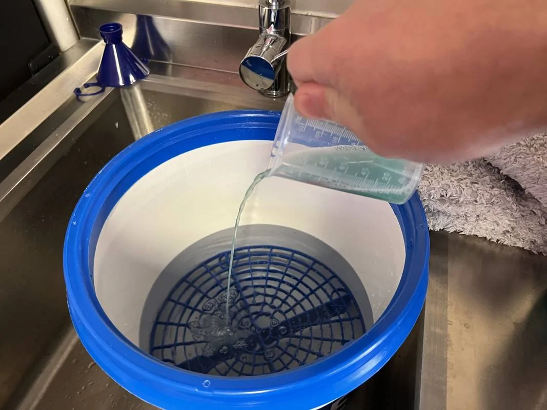

-Mix up your bucket solution following the recommended ratio. If you suck at dilutions like I do, try this website to work out the quantities of water and product -
Dilution Ratio Calculator (omnicalculator.com)
-Then add your towels to the bucket. For a Mustang, you will probably use about 6 - 8 towels.

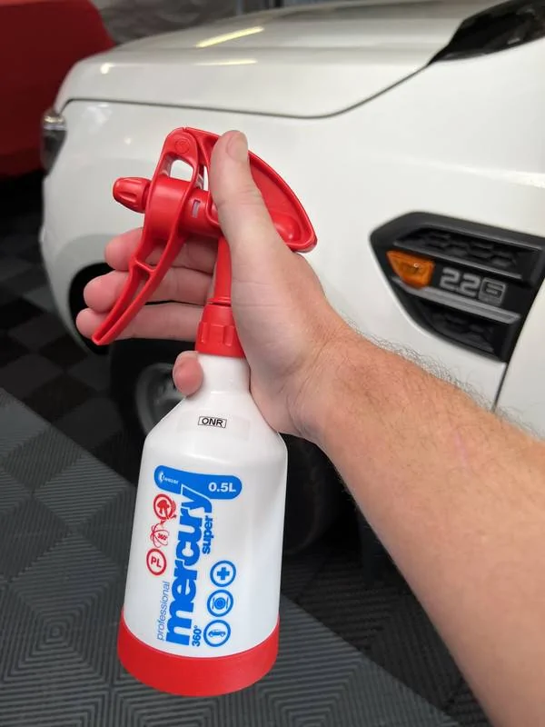

-You also need to mix up a pre-treatment solution of your chosen product, this is then sprayed onto the panel prior to wiping with the towel -

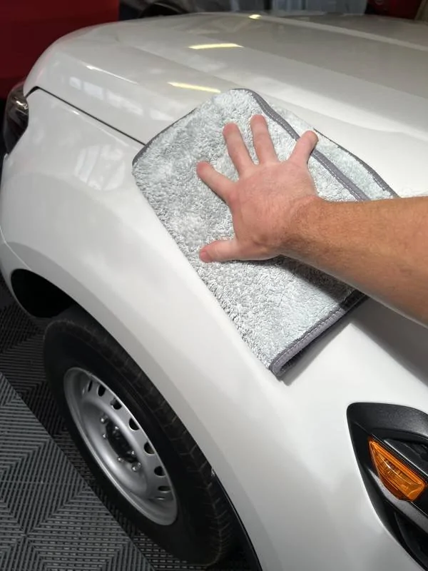

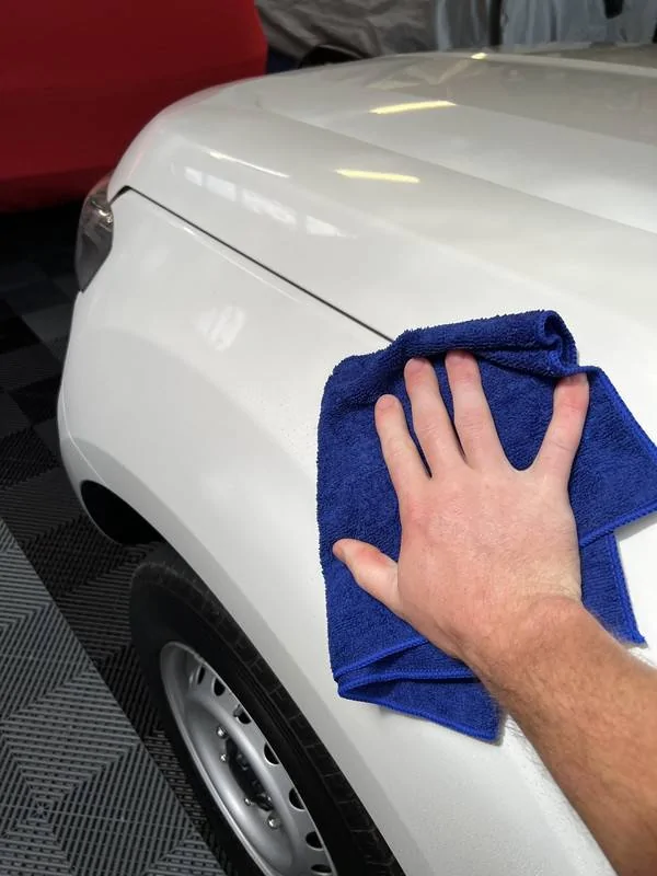

-Once pretreated, remove a towel from the bucket, lightly ring it out and then fold it so that you end up with 8 sides to work with. Then start wiping with light pressure in the one direction. Flip the towel to a clean side as needed.
-Then return with a drying towel to mop up any residue left behind.
Because a dirty towel is never returned to the bucket, the washing solution remains clean. And the fact you keep flipping to a clean side or towel regularly, it can actually be a safer wash method. It also means you can re-use the solution for the next wash if desired. I tip it down the drain myself.

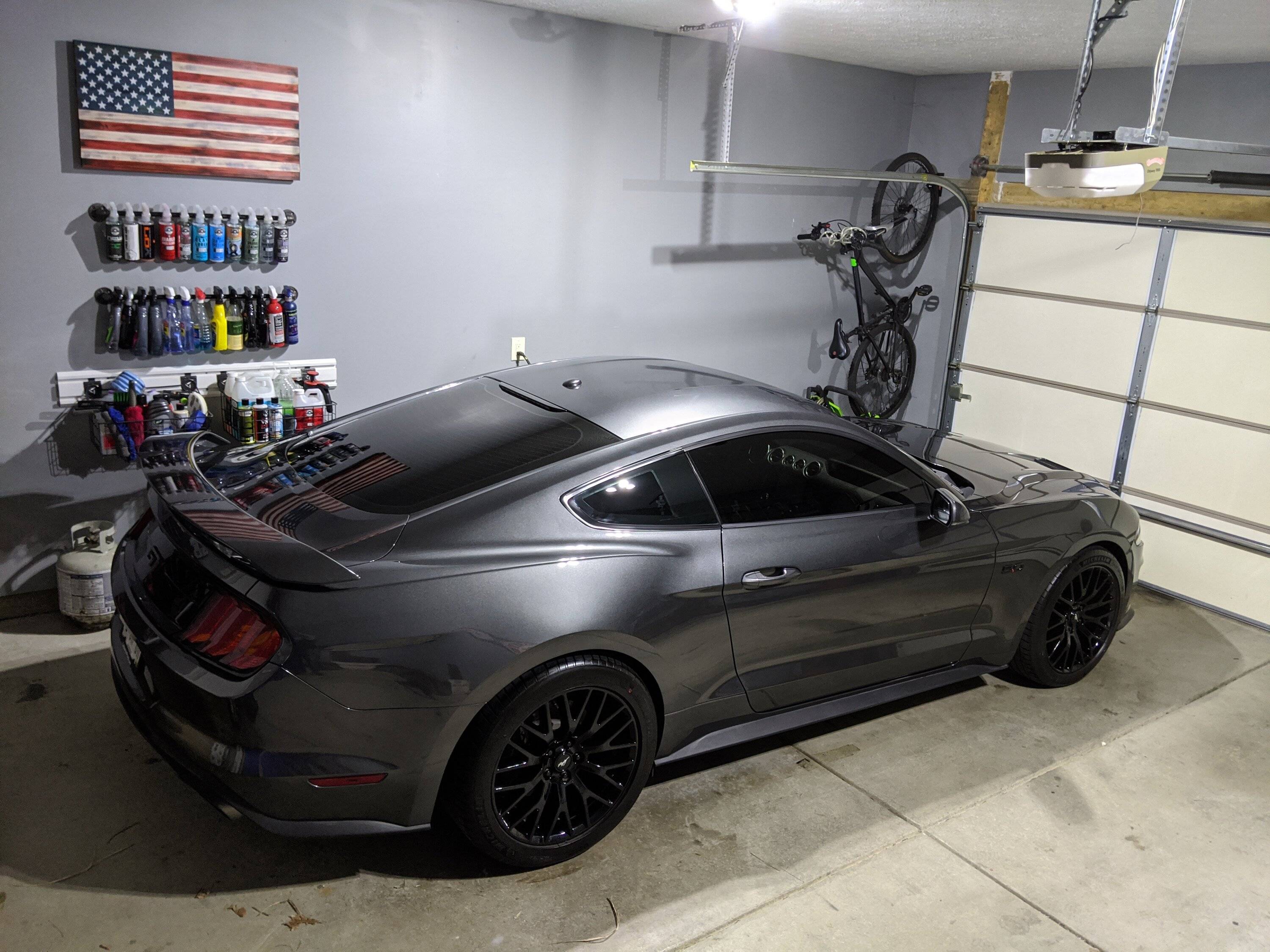

Love it. What wall mounts are you using for the storage? I've got a garage with no real room to put a big cabinet in behind the car so having something like this would be ideal.
Thank you. The bottles are hanging on 1/2" iron pipe with elbows and flanges mounting them to the wall. There's 2 baskets on a track. Mine are a Gladiator brand from Lowes. Works perfect for making my cleaning supplies look organized.
