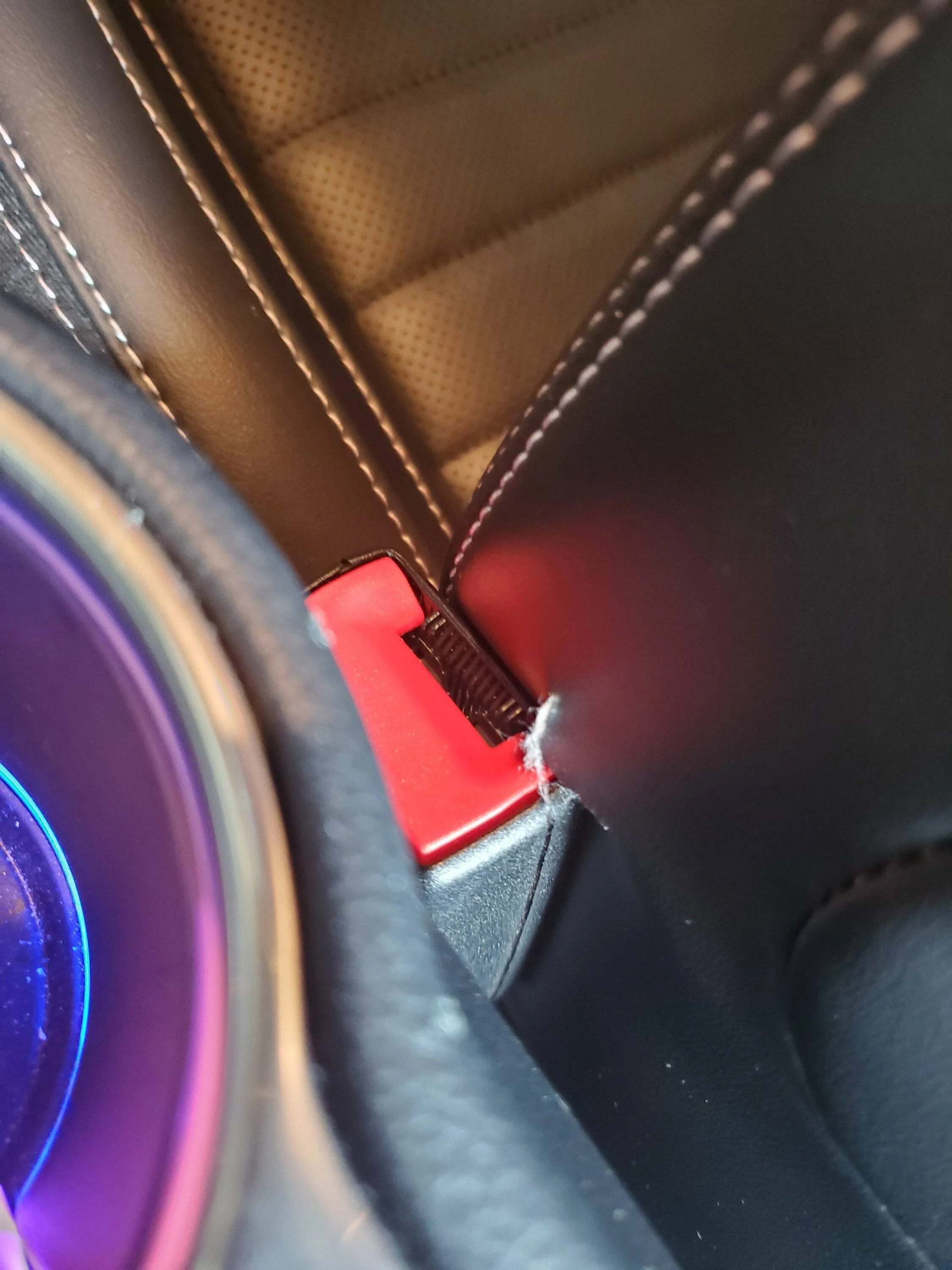

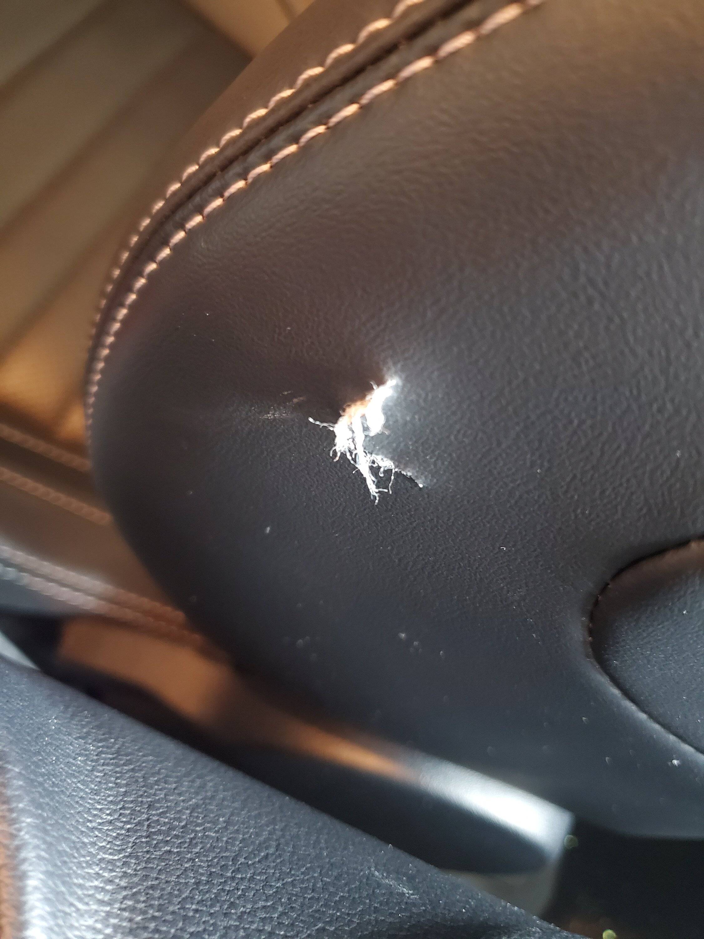

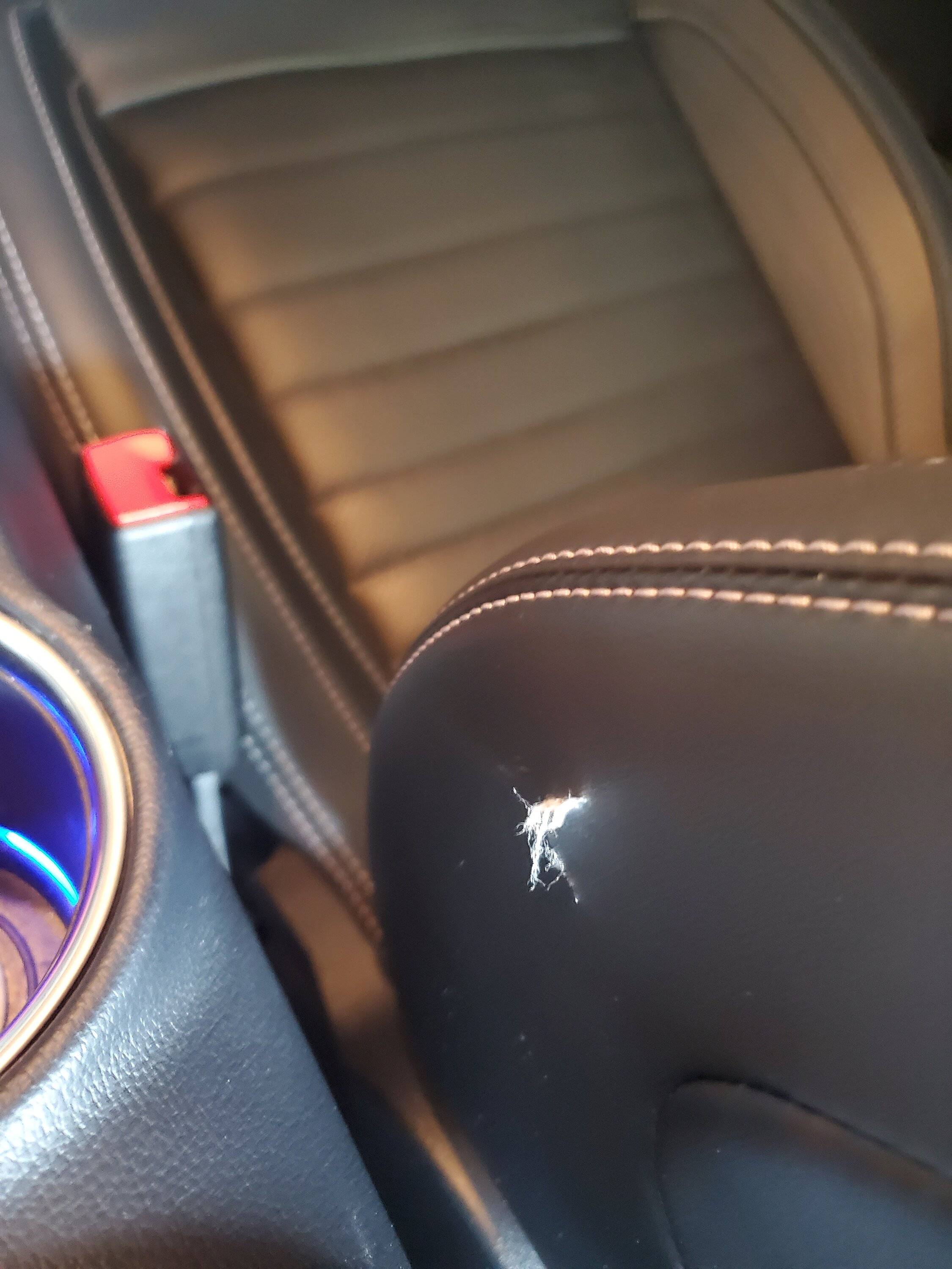

My car is barely 2 years old, I got it in September 2021, it has ~7,500 miles and already the leather has ripped on the side of the passenger seat!
What I determined is that when you fold up the seat back of the passenger seat up to allow passengers easier access to the back seat, the seat will rub against the front passenger seat belt buckle. The hard plastic edge of that buckle is sharper than you would think, and it has punctured my seat! The leather as you imagine, especially on a trim piece and not the seat backing or base itself, is paper thin!
I take extremely good care of this car, and to have this happen is very upsetting, especially from way below average use. Obviously I'm going to see if Ford can help me out with this, but I doubt they will. Its just a real pisser because this isn't the result of years of normal wear and tear.
If anyone has a good leather repair kit they recommend please let me know. If Ford wont help, I will get advice from an upholstery shop and maybe try this home repair kit. At least the kit says it will match the Factory color, but I have to do the repair myself....
I'm in some unknown waters here, so advice is appreciated.

This is strange, I would expect you should be able to fold the back of the seat back and forth daily without any issue.

You can tell by the pic, that is not leather, it is vinyl. Only the front of the backrest and the top of the bottom cushion that you actually sit on/against is leather, the rest of the seat is vinyl. If it were real leather it would not have torn like that.

With everything in its regular operating position, is there a gap, from the console to the seat belt latch and from the latch to the seat? I haven't noticed mine, but I'd think there'd be a natural gap, to prevent the very thing you've experienced.
As for leather repair kits, my experience has been, "Well, it doesn't look as bad now as it did before."
I picked up a small hole in a leather couch. Matching, colored duct tape was certainly an option, but I also noticed a vinyl/leather repair kit from Permatex. If you watch videos on-line, the people that use these materials all the time can produce some really good results. For people like me, who use it occasionally, I got a OK result.
Matching the color of the replacement material to the original fabric is somewhat easy. But the application involves loading up the area and using a small wand to heat and seal things. As a first effort, I was pleased. Didn't hit it out of the park. The repair wasn't obvious. About to go into my "indoor $hi! list" for Winter. I'll tear off my original attempt and try again.
Best Wishes on the warranty claim. Please let us know what happens.

My ranger has a felt pad on the side that is up against the seat cover .
Might want to get some same colored felt and some 3M double sided tape and install them.
Or someone with fords parts dept catalog could look up the part number for those pads.
Our '19 lariat has them on all 4 buckle locks .
My 2017 had a felt sticker on there too, guess it was for this purpose. Not sure if my 22 still has the same thing or not.

Warranty. Don't get offended, they will take care of it. Not like you took a knife to it.
Also, as others point out, it's obviously vinyl. If you want leather, go aftermarket seat covers. Won't be cheap, but will be real, and definitely last way longer. Just have to condition it and clean it more.

These are the heated and cooled leather seats, not the Recaros, the car is a premium pkg car, don't know if that makes a difference.
listed as EBONY LTHR-TRIM DOVE ACCENT on the window sticker.
I know exactly what you are talking about, and I will be equipping the buckles with these.
My thoughts exactly.
On a side note I checked the user manual and there is no warning, or special notes or procedures on operating the seat.
Car will be inspected for a carranty claim on Monday morning, I will report back.
