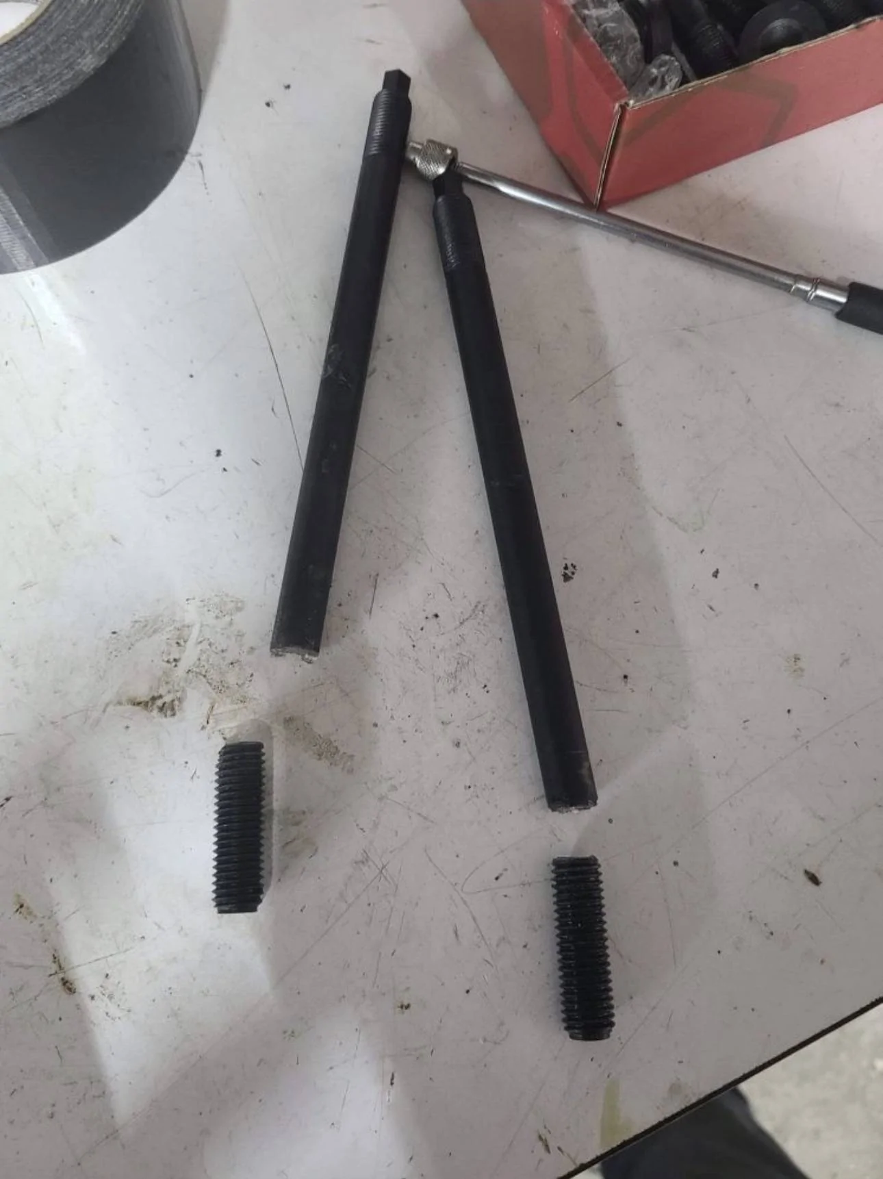

That is crazy!
I wish vendors would look at these things more seriously. I messaged beefcake about this thread and heard nothing.
I hope people find this thread and stay away from apex. Worth it to spend the extra for the arp headstuds.
Where have you found other people having issues?
Beefcake is the one that took down the allegedly incorrect torque specs back in January from their site. Seems like other folks had the same specs and sequence after that.

Yeah I just wanted two replacement studs for my client and maybe an assist with extraction charges but they said it was my fault and actually got my client to believe it. I have enjoyed sending them an email with these links and pics. And watch out Travis might try to sue us all for defamation even though everything here is factual.

His argument was that the 74/92 was only for one specific set of fasteners and that no one should have that info publicly as it’s wrong. He then admitted in writing that he did in fact provide those very same specs to Beefcake. He has no leg to stand on and apparently too much pride to admit there’s an obvious defect with their highly touted custom alloy. Maybe their redesign will be better.

Another potential apex stud failure on a fresh gen3 bottom end and not crazy boost. I don’t even think it made 800
