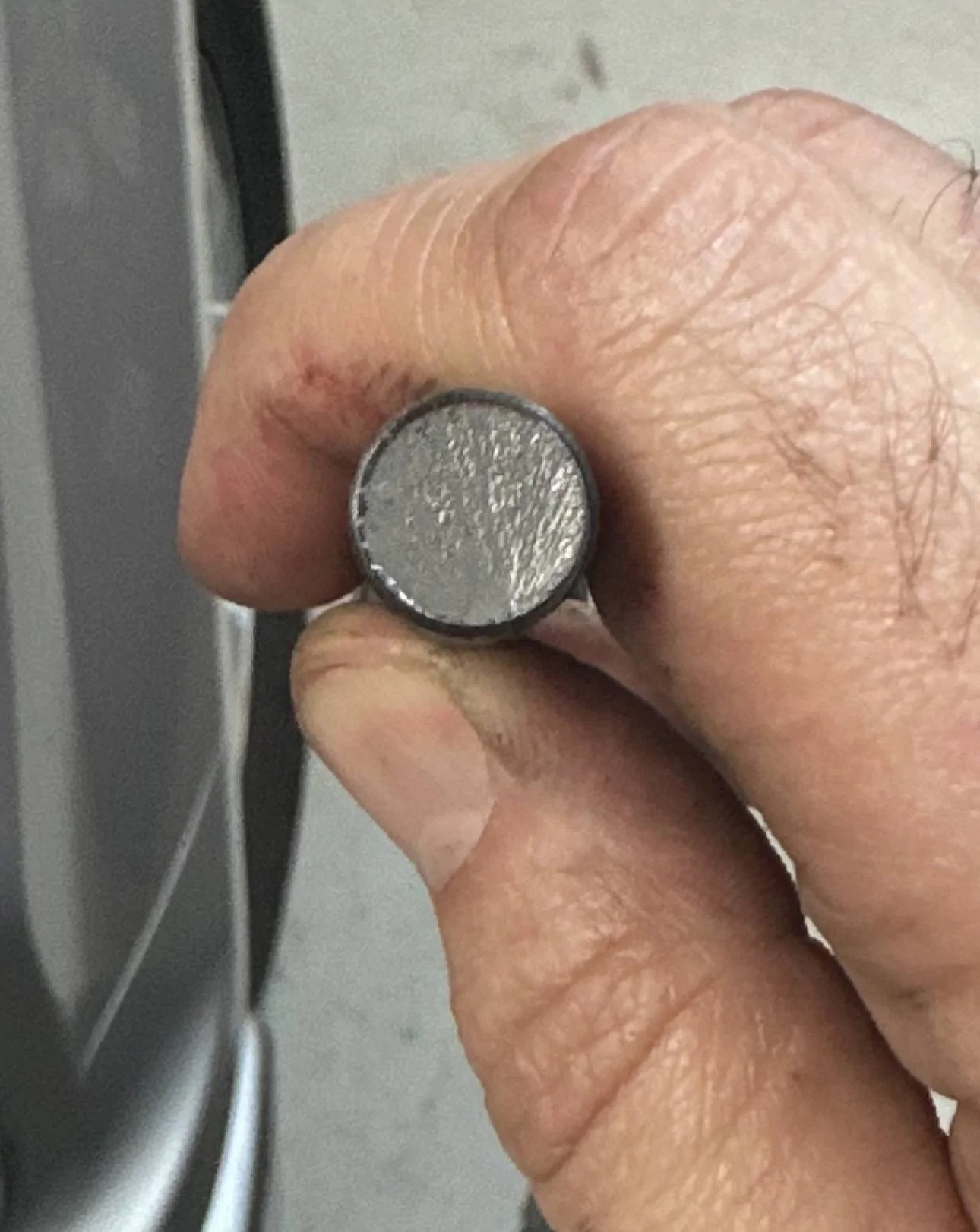

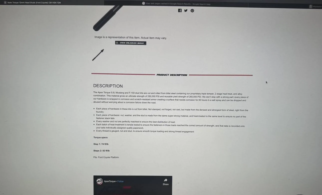

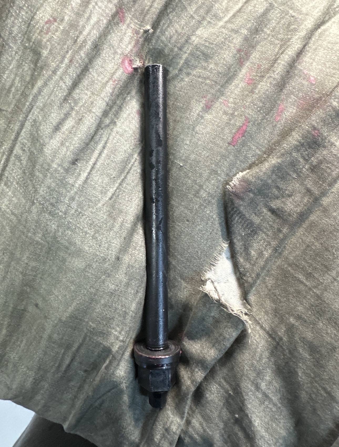

Ah, this is excellent! Also had Apex studs from a gen 3 that had two shear off five minutes after they were torqued, impaling my arm in the process. Had client contact Travis and he said they were overtorqued (74#'s) even though I got the spec from a website that sold their product and listed the same torque and sequence listed above. When confronted with that Travis had the website pull it from their page and said "Oh that's only for certain batches and that shouldn't be public knowledge." I used way back machine to snip a copy of the page before they had it removed. Travis also threatened to sue me for defamation even though everything I said is true. Searches will reveal other folks that have the studs randomly launching after install also. And strangely enough, their coyote line is "out of stock" so I messaged and they confirmed they're all being redesigned. Will find the pics.

Not over torqued, material defect. Note, this occurred in January of this year.
