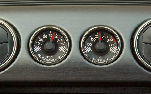

Well, if you want oil temperature, you can replace the manifold vacuum gauge with an oil temperature gauge from the GT350. I ordered mine a half hour ago.
https://parts.autonationfordwhitebearlake.com/oem-parts/ford-instrument-cluster-fr3z10849e?c=bD0xJm49U2VhcmNoIFJlc3VsdHM=
Under 30 minute plug-and-play. You do have to pop a few dash trim pieces off and you will lose MyColor on the center gauges. It does add another 50 psi to the oil pressure range, so you don't peg the gauge when the engine is cold.

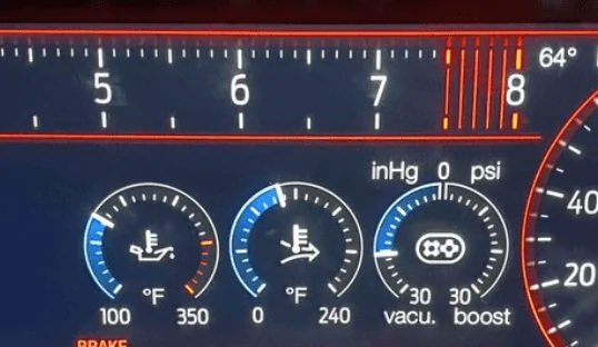

Oil temp can be added via "Show Gauges" on standard Bullitt...
(Note: that's not a picture of the Bullitt dash, but you get the idea -- I do have mine showing and happy to add a pic later.)

Really? I can't get Oil Temp as an option on my cluster, I just went out to car and double checked, no option for oil temp in any mode. All I get is Air/Fuel, Axel Oil Temp, Cylinder Head Temp, Oil Pressure, Inlet air temp,Vac and Voltage

Are you sure you're looking at oil temperature and not head temperature, which is part of the GT / Bullitt display?
How does the oil temp gauge get it's signal? Is a sender install involved?

The data is already on the control bus for the car. You literally just have to:
  1. Pop off the dash trim, starting with the piece to the right of the glove compartment and working to the left.
  2. Disconnect the plug on the back.
  3. Unscrew the existing gauges from the dash trim.
  4. Screw the new gauge to the dash trim.
  5. Swap the dash trim clips from the old gauge to the new one.
  6. Connect the plug to the new gauges.
  7. Put the trim back on in reverse order of how you took it off.
Plug and play with no modifications, cutting, or additional work needed. Half an hour or less if you have a trim removal tool. Some people also swap the trim rings from the gauge faces, as the GT350 apparently uses a slightly different finish.
You can see how it's done here (using a different gauge to get boost on a supercharged car). While the ecoBoost gauge used in the video does support MyColor, the GT350 gauge with oil temperature does not.

@sport160 You are correct, sir. I am using cylinder head temp...

+1 on this.. Easy to install and a much needed mod!
