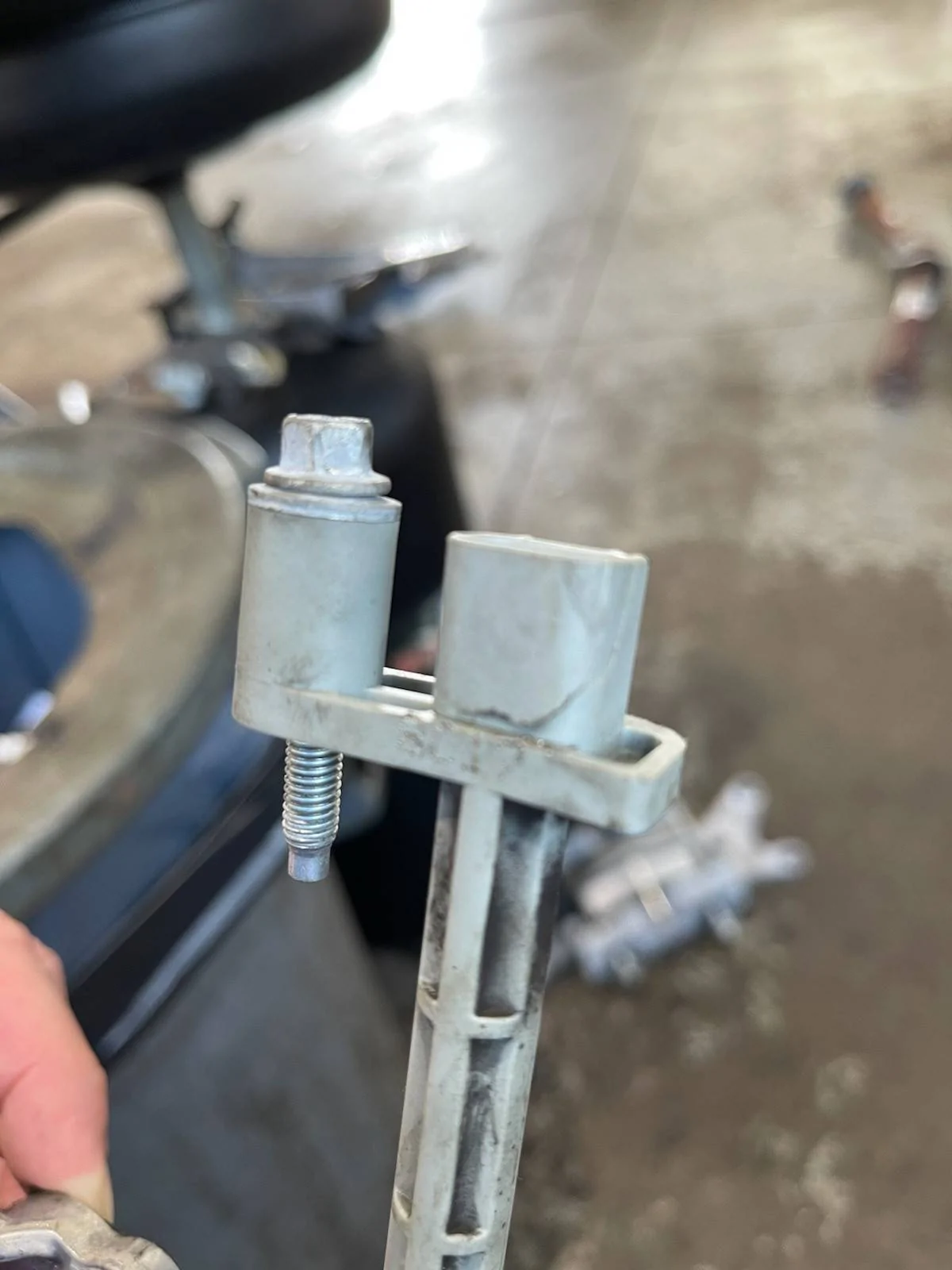

Looking at the sensor , where the crack is , did the also replace the connector? It looks like that would cause the connector to move in the sensor . If that happens there is most likely terminal spread in the connector. Poor pin fit will cause issue down the road . Good job on the tech for finding the issue , but if the connector wasn't inspected or replace the follow threw was a little light .

I believe you are referring to what appears to be the odd angle of the bolt?
in the picture the part that is cracked is where the sensor plugs into the wire harness . The sensor it self is at the other end that is not shown in the picture . For it to crack the way it is cracked would be caused by poor installation . With sensor being cracked the way it is , it would cause the connector to move around . What will cause pin fit issues in the connector itself .

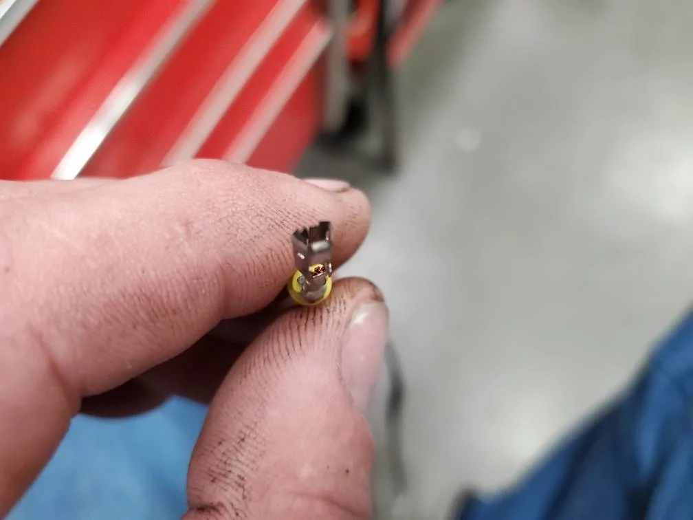

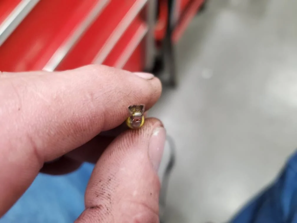

Here is an example of what a spread pin looks like . It is taken out of the connector to se better . With poor pin fit you would get an erratic crank signal to the pcm .

Thanks fmc_smt, much appreciated education. Fingers crossed the issue doesn't come back.
