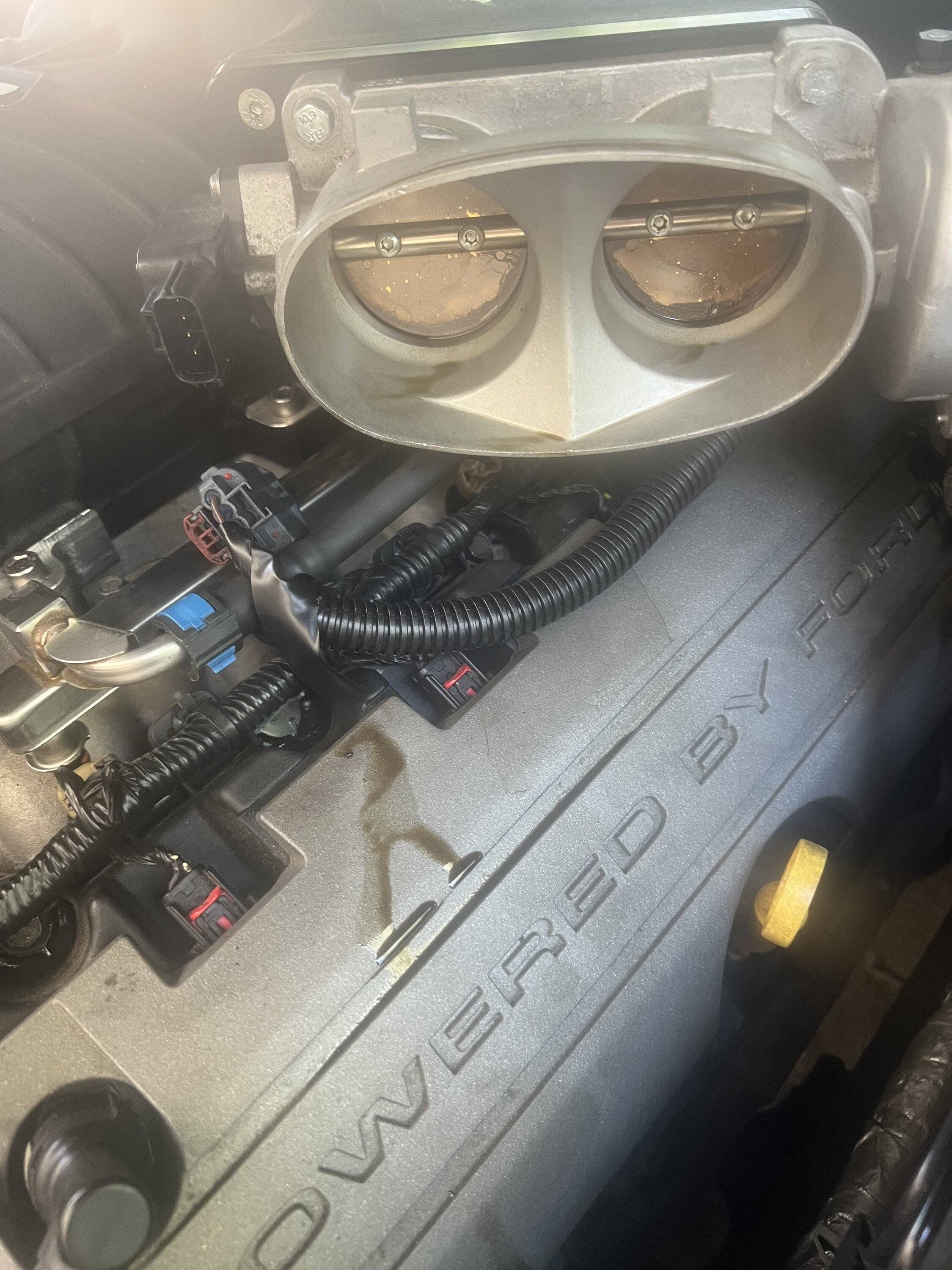

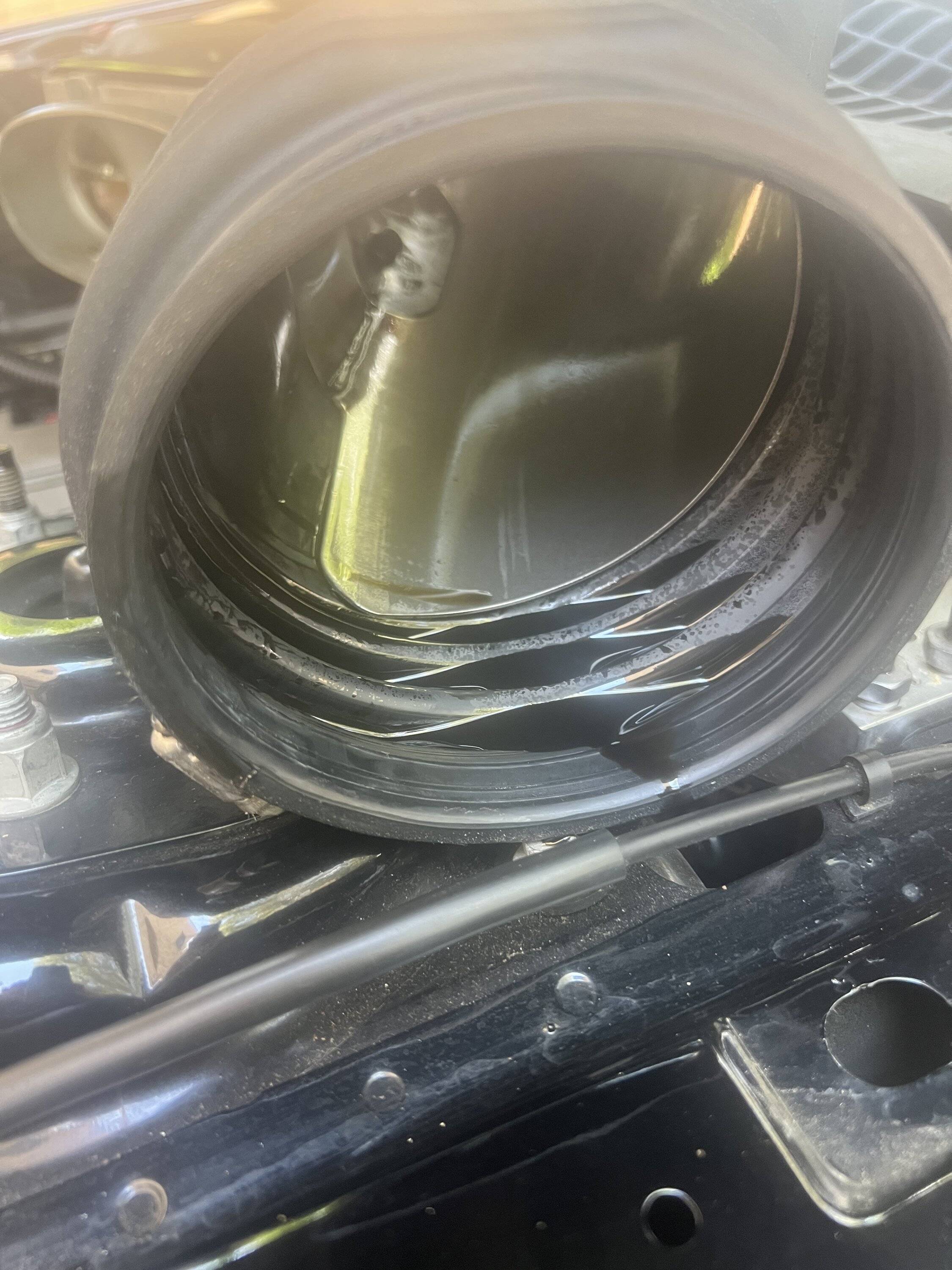

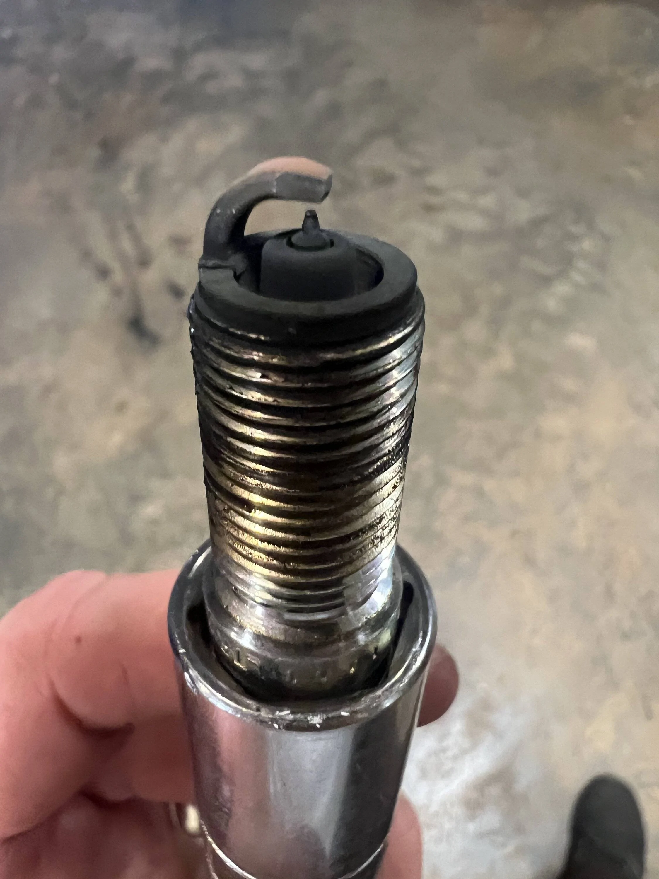

Ok so I changed the plugs and cleaned the pvc valve and the map sensor. When I took the intake apart in was pouring oil almost
