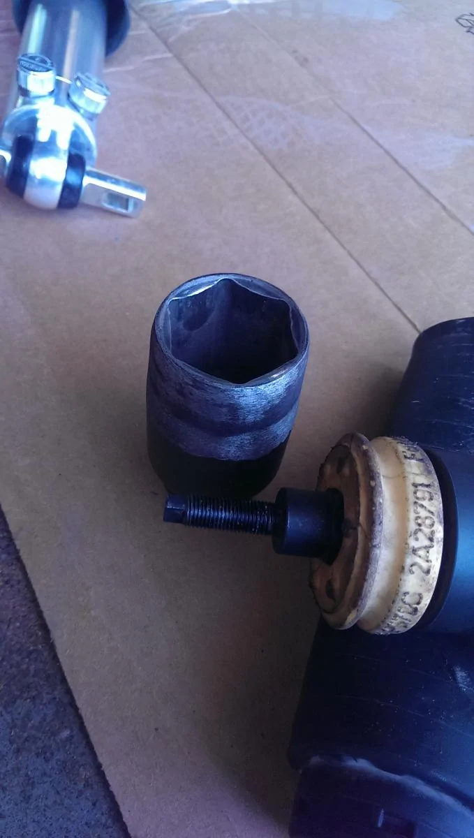

Have been working with the Viking guys on a fix for the few folks who have some noise issues. Thought I'd share an observation - you can get the OEM bump stops mounted on these shocks. It is not difficult with the right tool.
I used a big-ass socket and a rubber mallet. You'll want to up the compression so the shaft stays put. Works best to put the bump stop right at or slightly above the hex section of the machined post. The dust cover fits and everything goes together like stock. This may help if anyone else decides to "go agricultural". Just be careful you don't damage the threads on the post.

Just put mine on today and I have the rattle ... I did use the factory bump stops like you did but did it a much easier way ... Just remove the top of the shock mount and the jam nut and slide the bump stop and dust boot right on and then reinstall the jam nut and stud ..
