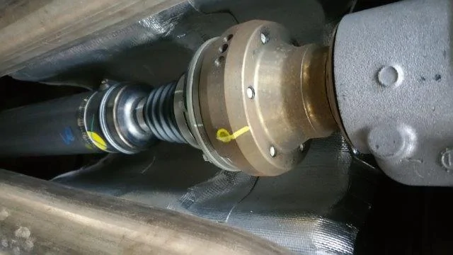

So Got mine back and seems to be good. My service guy told me the tech charged like 4 or 5 hours on just balancing the drive shaft. Had to keep adjusting and several road tests. I guess he successfully did a couple others is what I was told. Had the car driven like this from day one I would have never thought there were any issues. At 80 mph a tiny artifacting but pretty sure its tires. Now that I am sensitive to what it was like, looking very hard, but have to say feels like the tech nailed it with the hose clamping balancing of the Drive Shaft. Really driving they way it should at this point.
Here's the actual work and the Balancing marks and clamp
