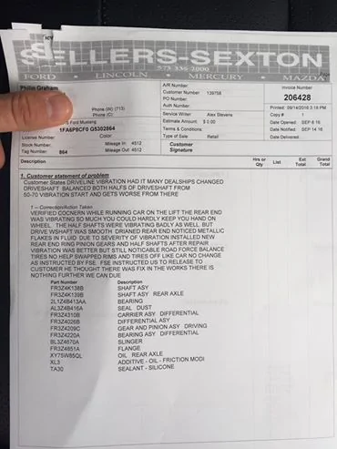

Basically. Today I was informed...
The dealership was forced to throw their hands up and said "Ford is working on a fix, we can't replace anything else " after their engineer came out and confirmed.
2016 Mustang GT with 4K miles.
(3rd) New driveshaft and balanced, rear diff and rear half shafts.
Road force Balanced the tires and switched out wheels with another mustang. No positive result.
I was informed to call my Ford Rep and request a buyback or other action.
Now the process begins... And it's a shame. This is my 4th Mustang.
How is it that many cars are fine, and the bad ones are not able to be fixed? So strange....

Car is even worse now :frusty:
40+ is vibrates your vision and hums loudly.
This car can't be safe to drive.
Can't believe this.
Ford needs to step up now and replace or buy back this car.
We will be in business.

Heard from Ford today, they are going to buy back my Mustang due to FSE stating (from my guess) that they are unable to repair my vehicle. I mailed an official letter, and they received it Today and called Today.
Talk about a response time! I wonder if my involvement of the BBB Autoline had any persuasion? (smirk) I did not initate the official packet but did submit complaint online, and received a response from the BBB that Ford was notified on my behalf.
Either way, I should hear from the procurement department within 7-10 days and have a check within 30 days from today. The search begins for the next car...
