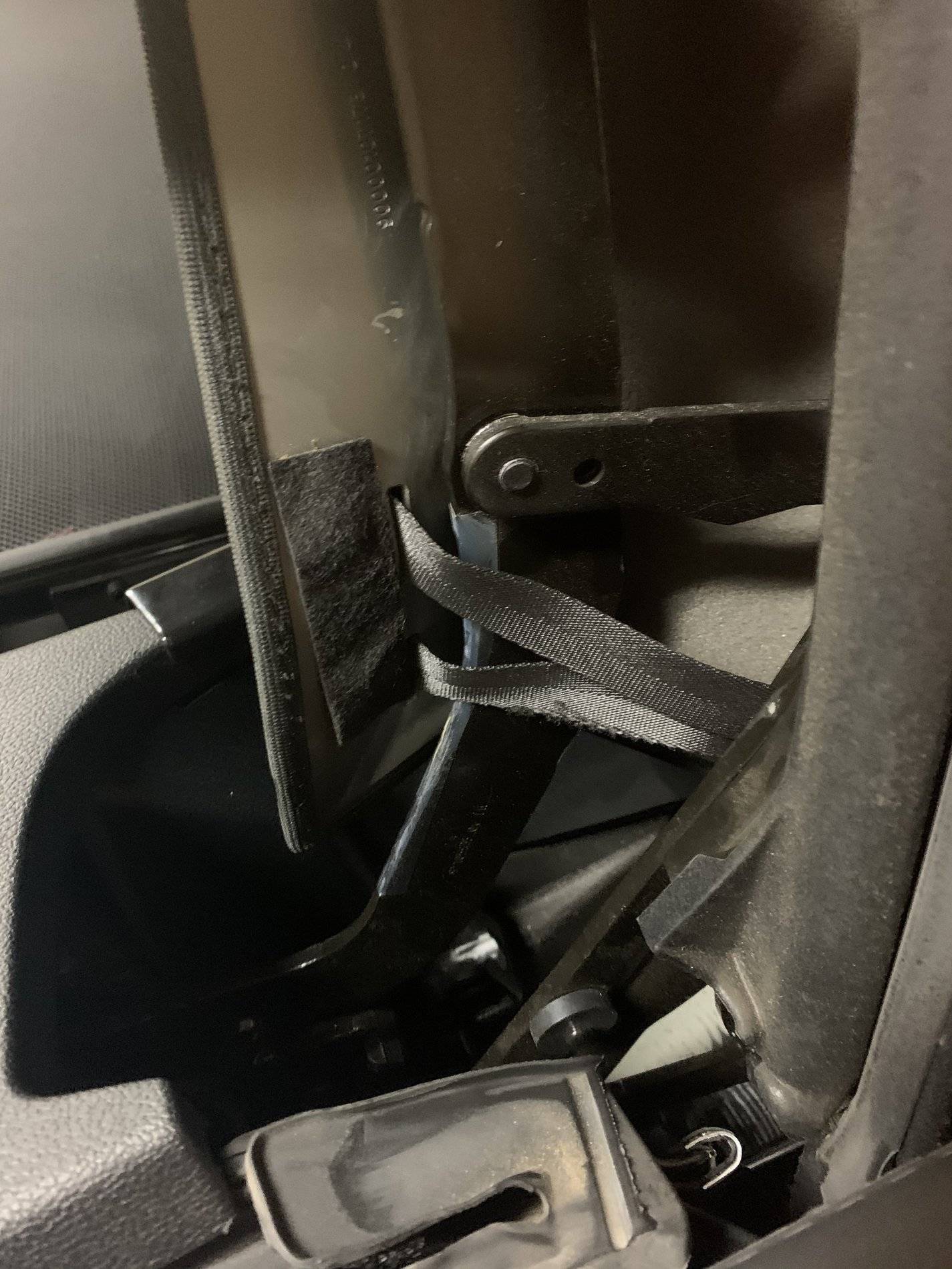

After many months of top down driving...a few days ago noticed an unfamiliar rattle/squeak with the top up windows closed just over my left shoulder. Annoying rattle/squeak was even more prevalent top down and no music to mask the sounds as I typically do. Further investigation and I discovered what's seen in the pics. The flap with the teflon/plastic rub area folds over and is trapped 4 out of 5 times when I drop the top. Didn't notice prior to removing from hibernation this spring. Straps and edge damage is evident. Dealership agrees there is a problem and have no idea why it's doing what its doing.They have agreed to escalate for top replacement under warranty. I am absolutely terrified having a dealer certified shop replacing it after hearing some of the horror stories but it is what it is. At least I get to keep the car until parts come in, just have to stop the top half way down and make sure the flap is in its correct position each time. Will update as this process with local dealership continues.

These **** straps man, seems like such a reoccurring problem. I have a slight amount of fraying damage on the same spot, just wrapped some gorilla tape over it for now. Not worth losing my car for a month while they replace the whole top.

They replace my inner roof for the exact same thing in one day. When i take it back it was cold (canadian winter), in my garage i open the top and hear the same sound as you describe. Bring it back and said wait until weather will be hot .... and now the same tears appears. Why since 1965 ford isn t able to build a good soft roof ? In my 2016 mustang my whole roof needed to be changed for anormal wears

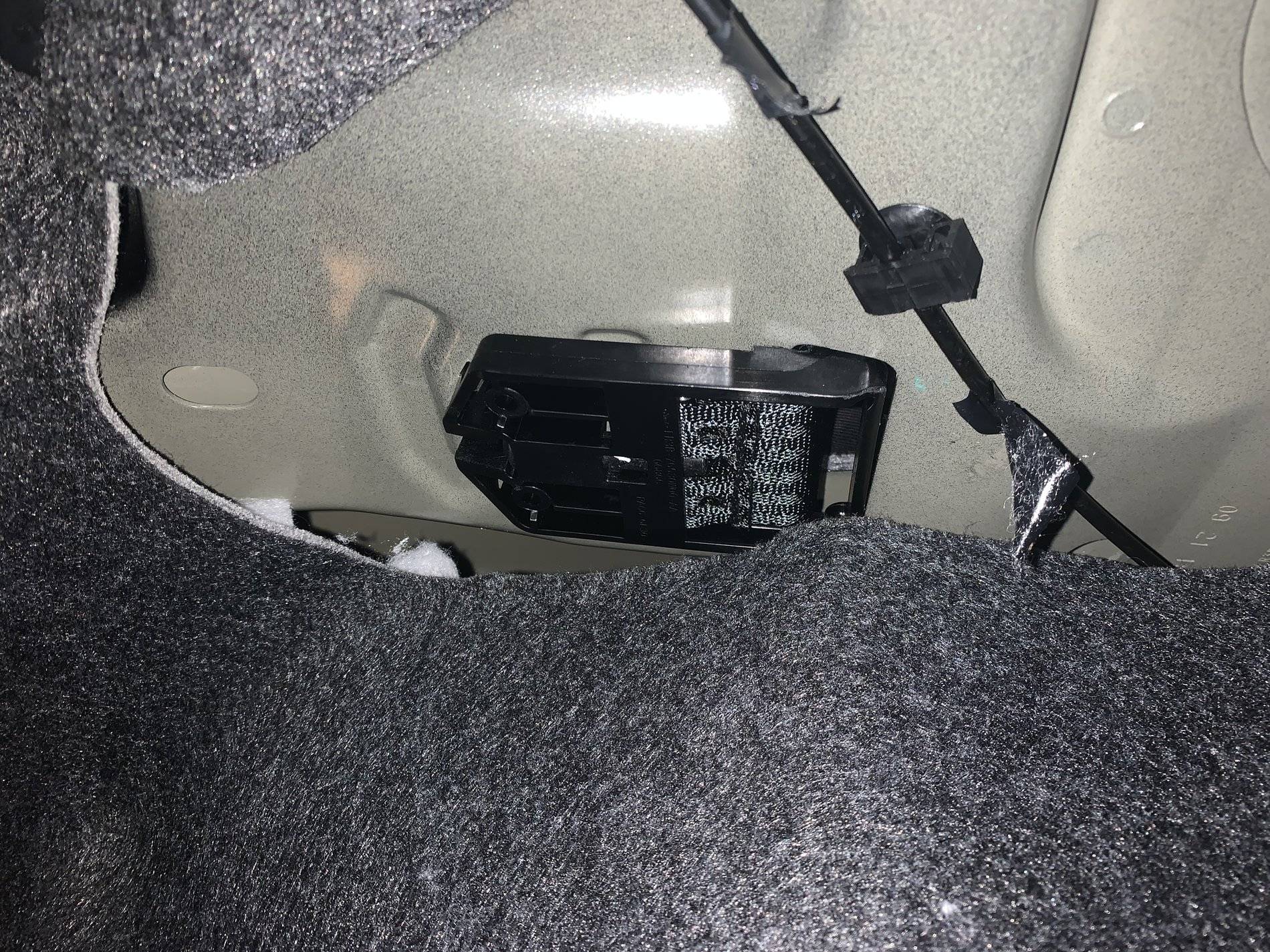

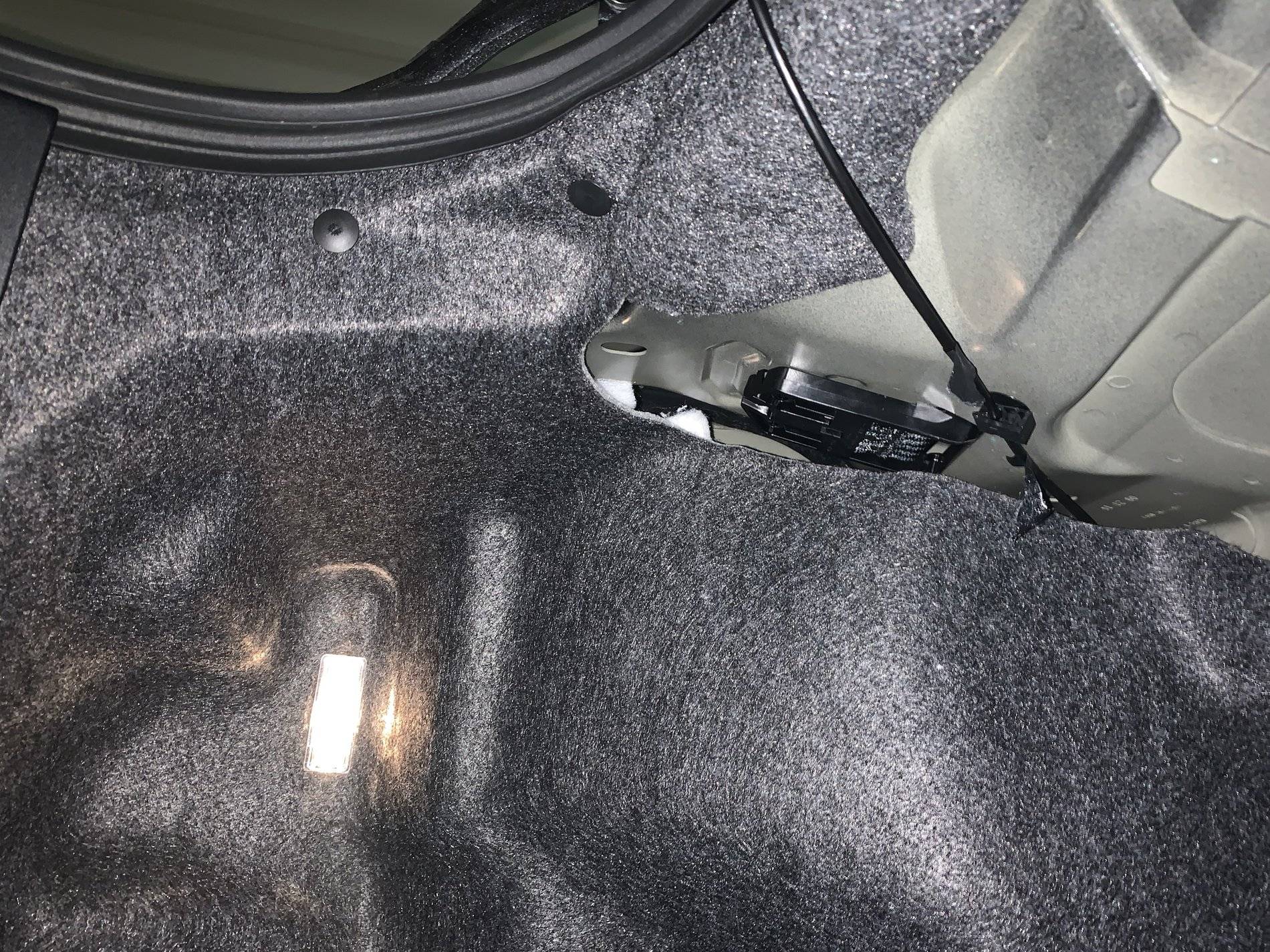

Looks like straps might be to tight. Either way I wouldn’t try to replace the whole top just for that. I think those straps go all the way back to the trunk. If you look inside the trunk on the upper left and right side see if the buckle is flat against the metal. I remember awhile back someone posted that theirs wasn’t and mine wasn’t either which may make it to tight and wearing as yours is. It’s just a theory. I attached pics of mine and it’s 3.5 yrs old with no issues.

Yours also has a plastic strip protecting the strap from the metal arms of the roof.

the straps in the trunk are the top tension straps and go over the top bows. Not the same straps connected to the headliner as shown in your pictures of the interior.
Ok thanks I couldn’t really tell looking in there.

They are going to repair it again just few month after first repair. They said they are going to put a special part to covert the wornnpart and between those two sides a a kind of teniser to avoid the pinching
